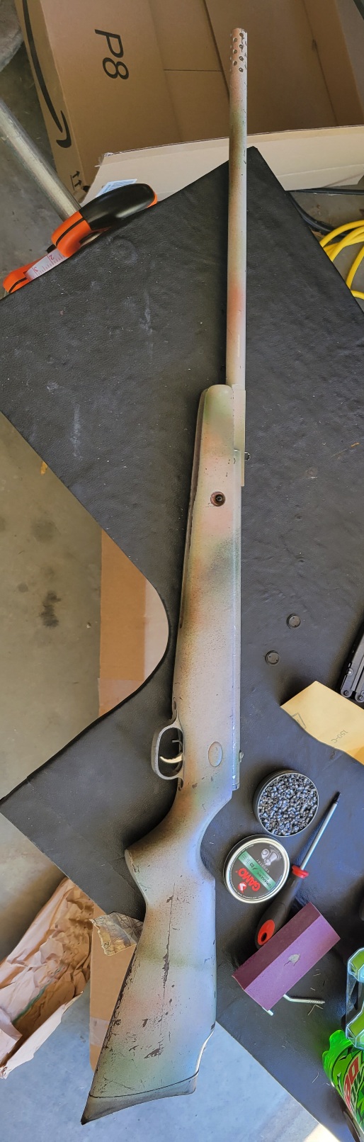

Just picked up a mystery Beeman for a project.
Came with an interesting camo paint job that will need removed.

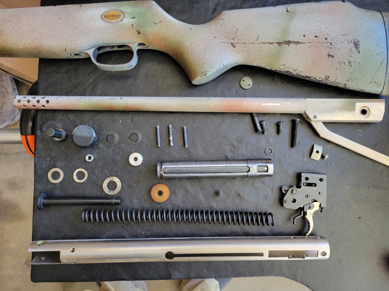

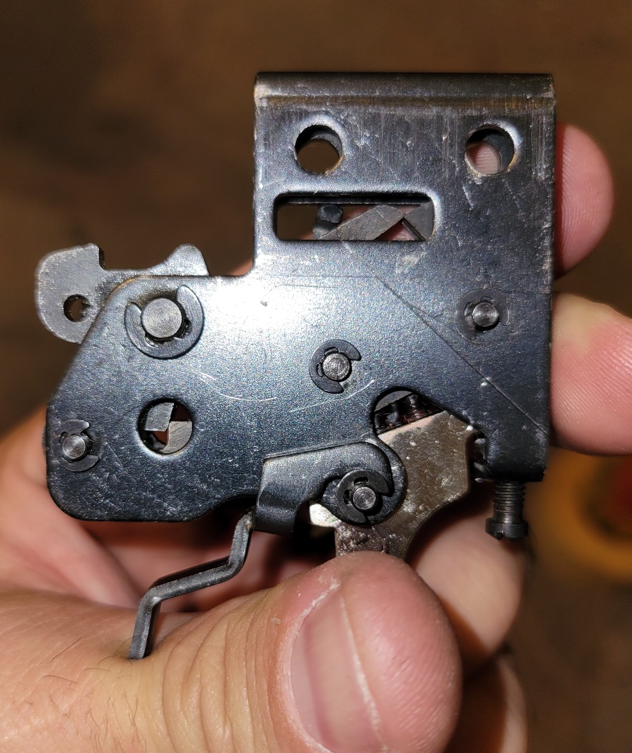

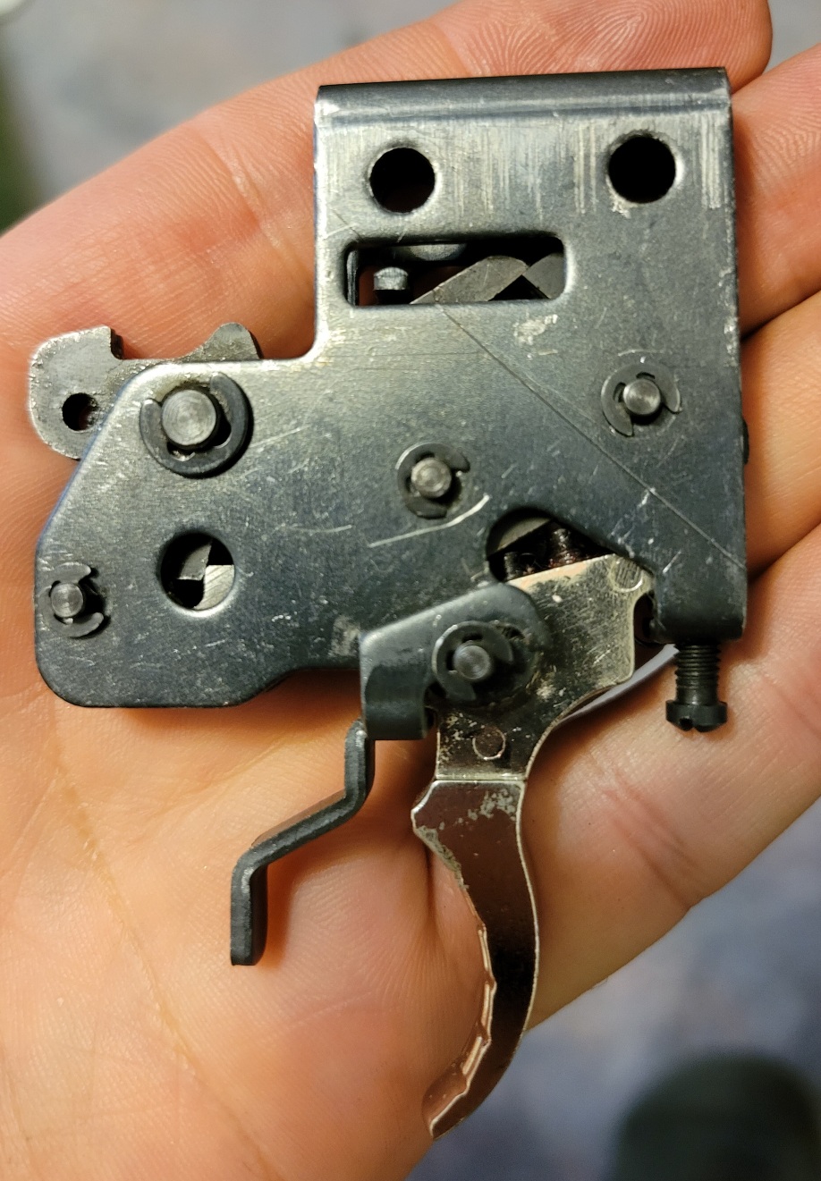

So far, I've gotten it tore down. Rebuilt the trigger assembly with a quick clean and fresh oil. The tube and plunger look good. Doesn't look like it leaks. The spring was cut down but I'm not sure if I'll replace it, or leave it as is. I did find some damage to the plastuc spring alignment tube and washer, but it was easy enoigh to flatten the washer and smooth out the mangled plastic with a little sanding.

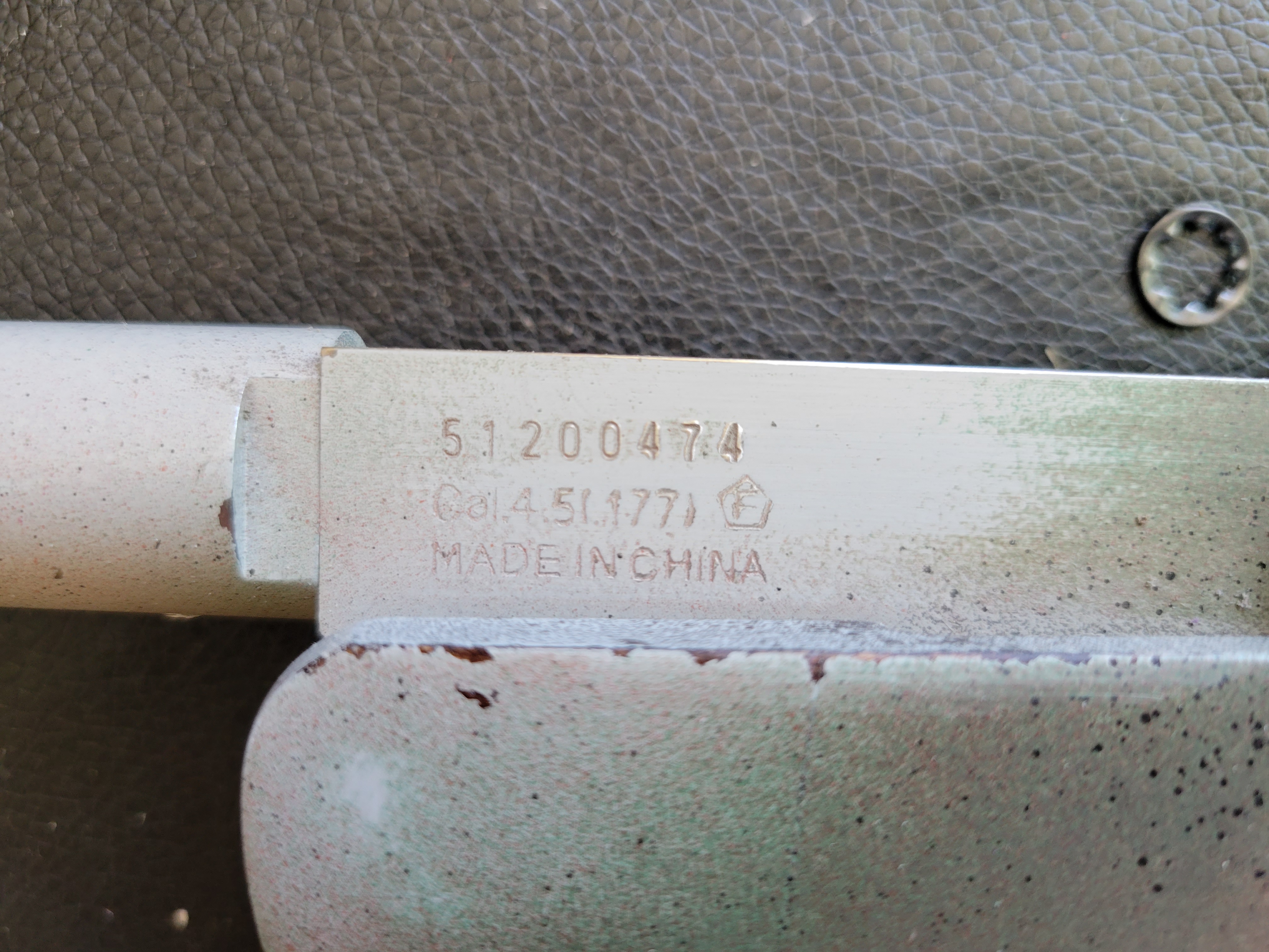

I have positively identified my mystery Beeman as an SS 1000 T.
Also went and designed myself a spring compression block so I can use my arbor press to hopefully compress the spring enough to get it all back together.
Finally, I did a little more of a tuneup on the trigger assembly. Polished the slidding surfaces to get rid of the gritty trigger feel. The trigger is an adjustable two-stage I believe, but the adjustment screws were so loose, I'm surprised they hadn't fallen out. Probably would have except for the dirt. Added a little thread lock to keep them. Got the trigger adjusted to give me a real nice break at the second stage. Not quite a hair trigger on the second stage, but close.

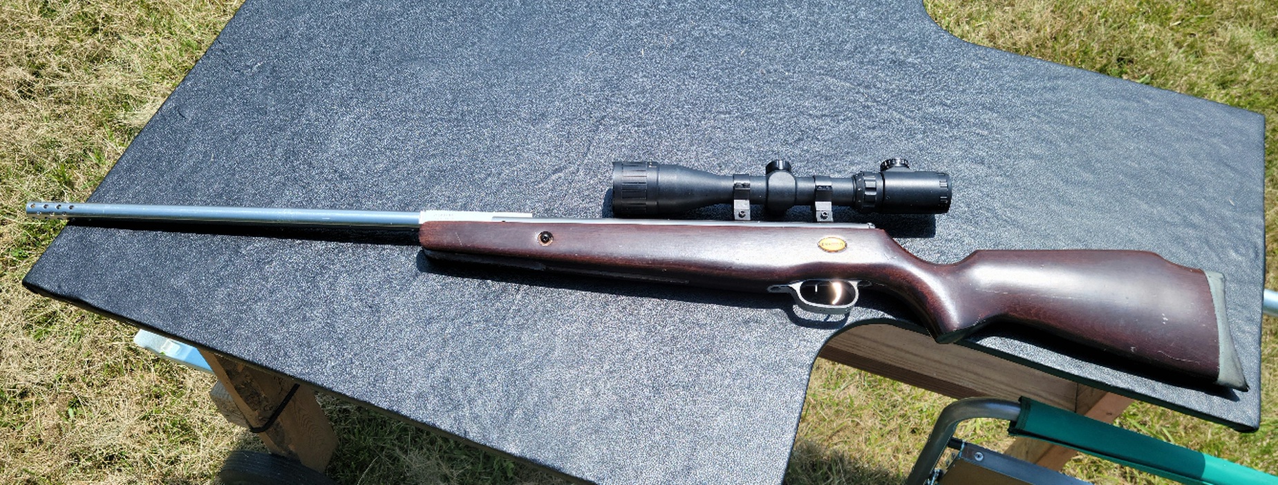

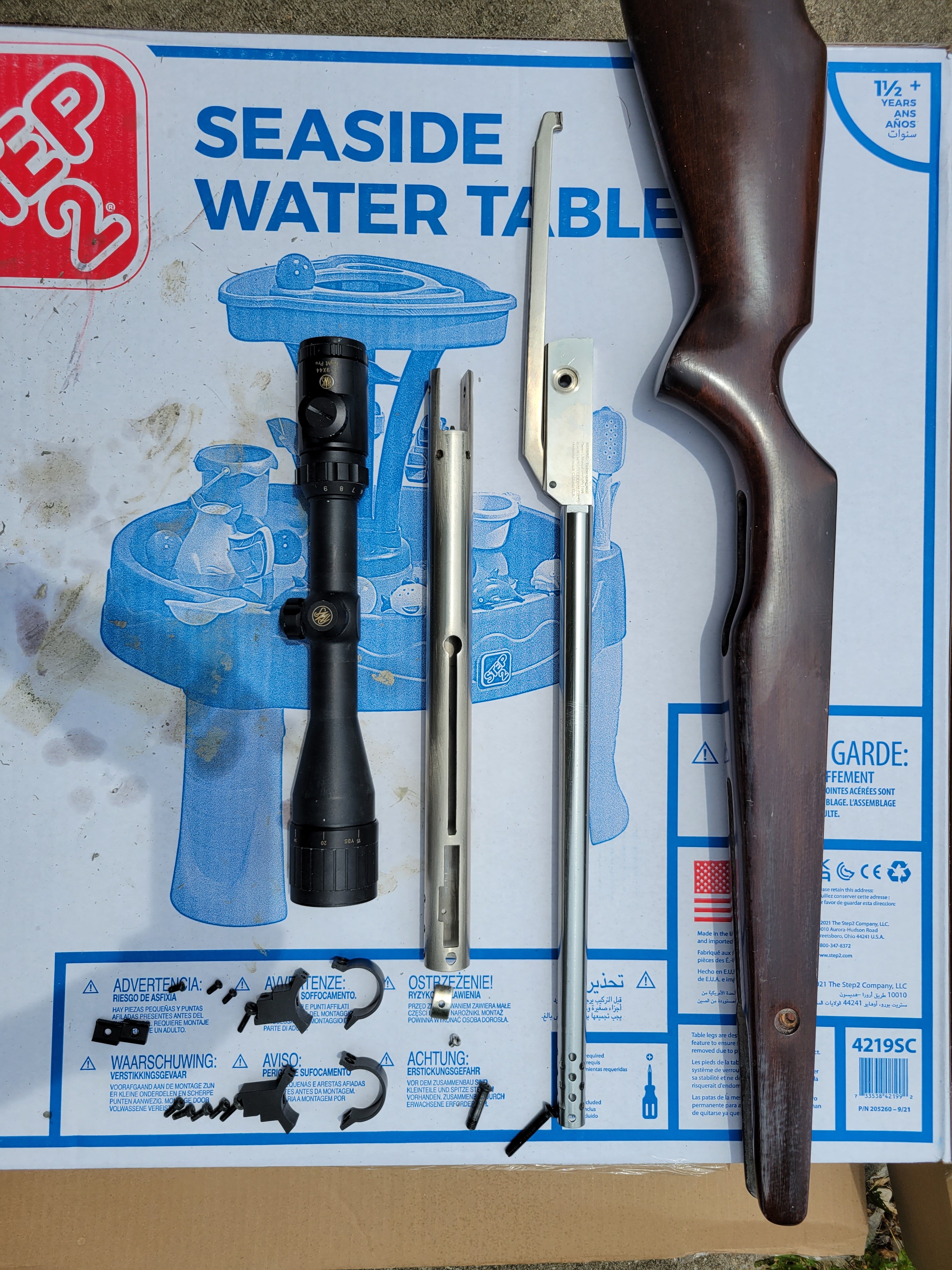

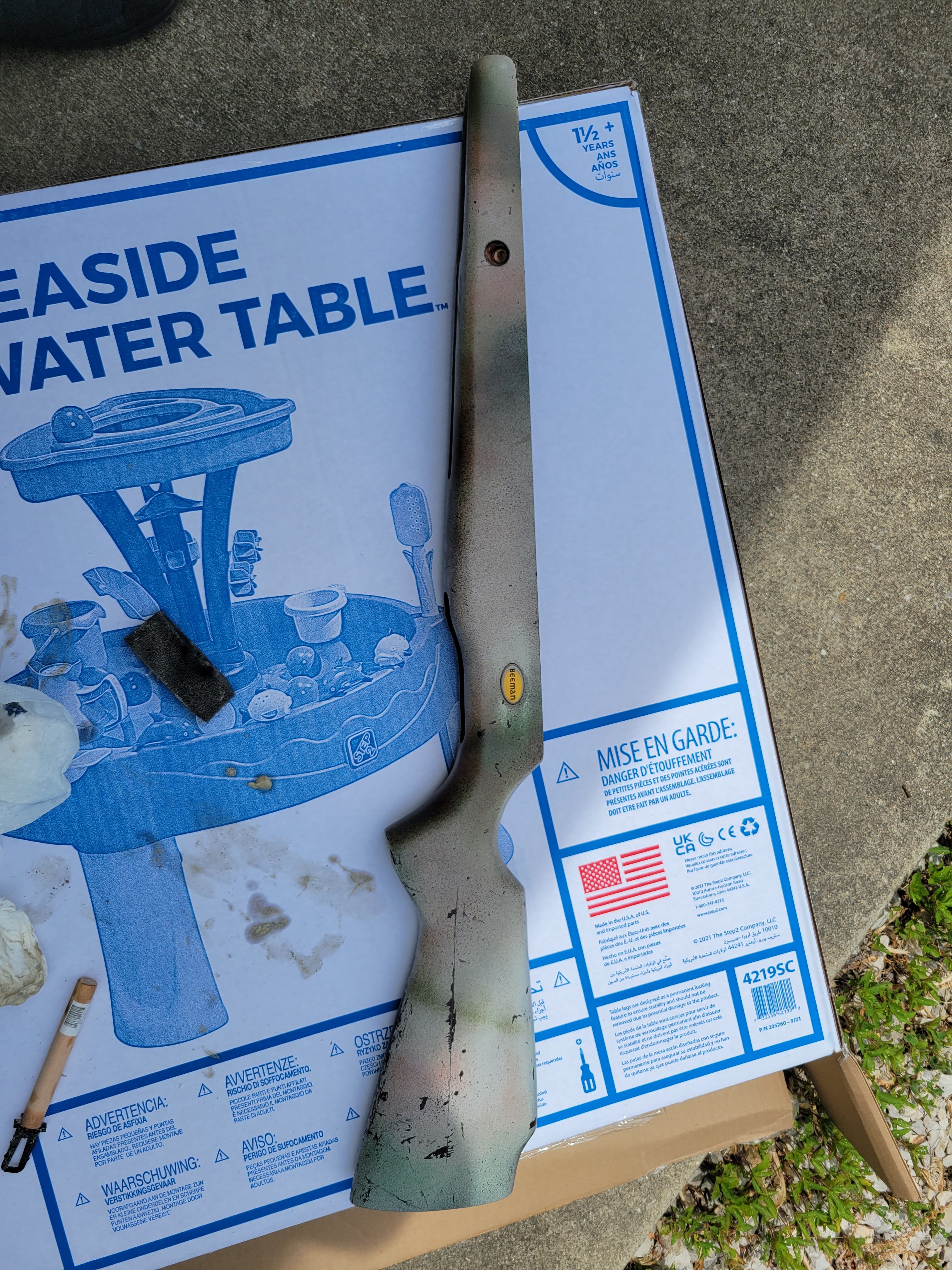

Finally got the paint off. Wouldn't you know it, there's a rifle under all that paint! I highly recommend this "2 Minute Remover" for getting rid of paint. Was coming off as soon as I applied it. I even got the scope and hardware cleaned up. Not a bit of paint left.
Now that the paint is gone, I can see a little more cosmetic damage. The finish was scuffed up for the paint, but not very well. I may see if some clear coat can fill in those scratches. The barrel did have a significant gouge in it, but I think I can grind it smooth.
I forgot to take before pics for everything but the stock, but you can definitely see an improvement.
