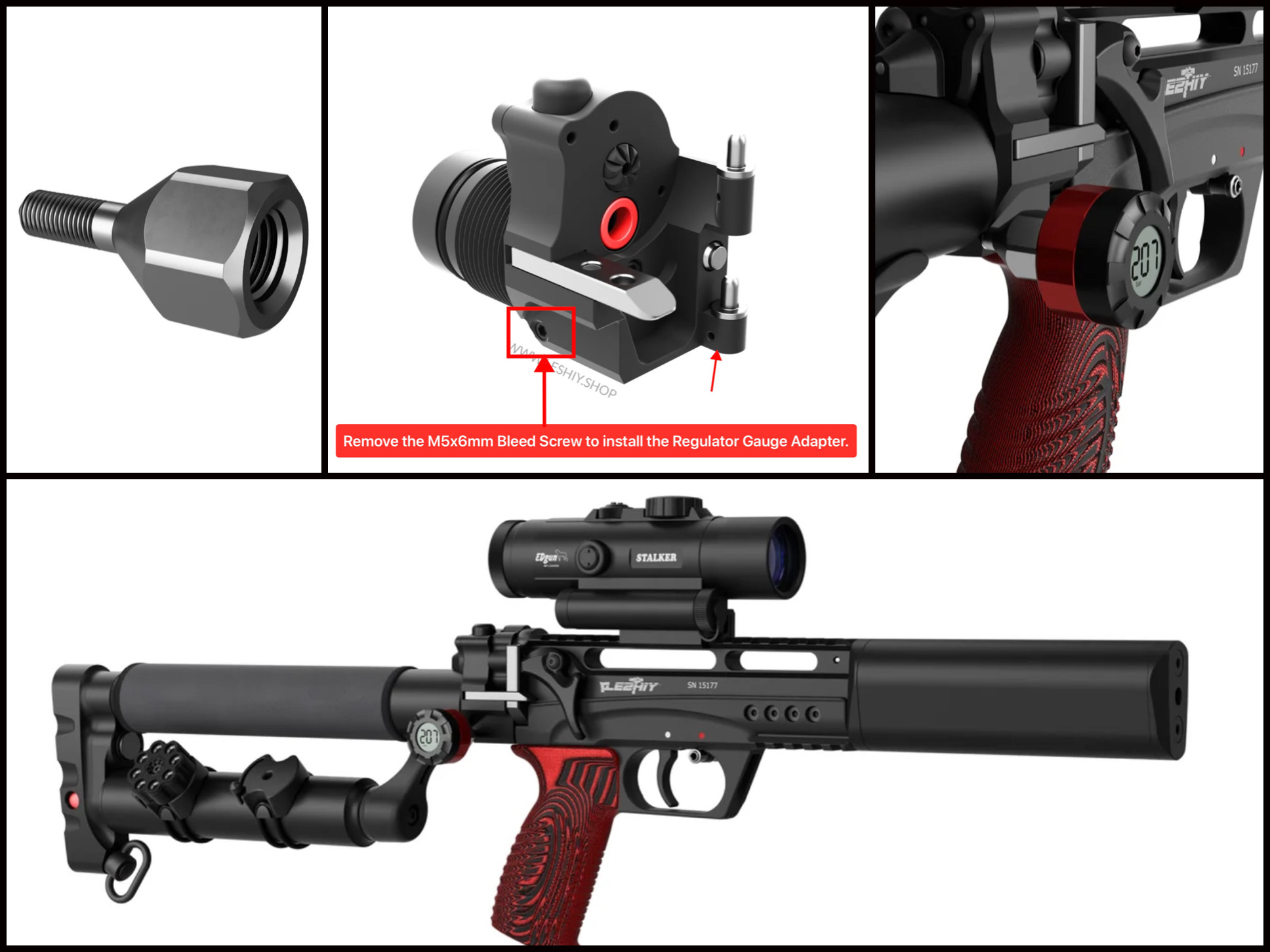

I feel like the new reg can take an adapter to fit the gauge, if you look on the Spain website they have an adaptor for the original non adjustable reg ( the first one ). This adapter on the website also states that it can be used with the "Apex" reg. Are we under the assumption that this new reg is being named the apex reg? The brass side looks to me like it has internal threads that would fit this adapter, as it states it's also for the mk1 reg, this adapter would be fitted to the bleed hole on the reservoir. I might be wrong and happy to be told so.

A year in the making then, does seem strange how it was just put out there without any info on it for new buyers of a leshiy 2. I received my butt section last week and seeing this new reg puzzled me, spoke to Matias at Spain and he said the apex adaptor is to be used with it to fit the gauge. I am presuming you can alter the reg pressure on the opposite side to the brass ( original) adjuster , as with this new apex reg- the gauge adaptor screws into the brass section.
The Regulator Gauge Adapter is installed onto the Forward Plug.
This would allow the user to monitor the pressure adjustments performed on the EDgun R.E.P.R., Huma-Air Raptor, EDgun Apex externally adjustable regulators, and pressure set on the Internal Standard Regulator.
