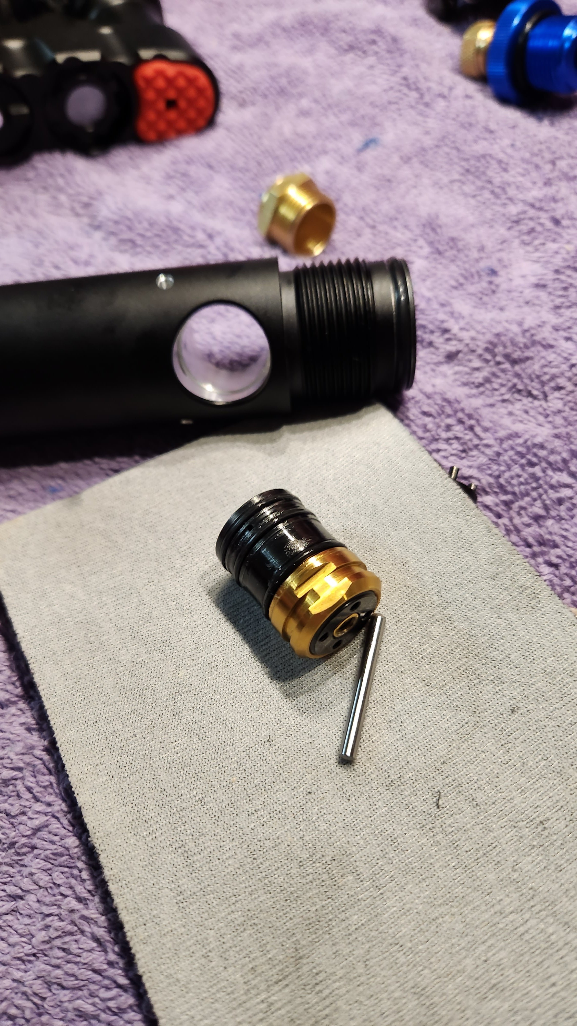

This is the 3rd time I've taken apart this reg and fully cleaned it and inspected. Very lightly greased with silicone grease checked for any damage to metal surfaces or o rings etc.
No dice still 1 shot massive creep 1 shot "mild" creep then normalizes and has a minimal spread. Its almost like the ceramic ball and plastic cup aren't sealing enough or not enough tension in the system to counter pressure from the high pressure side.

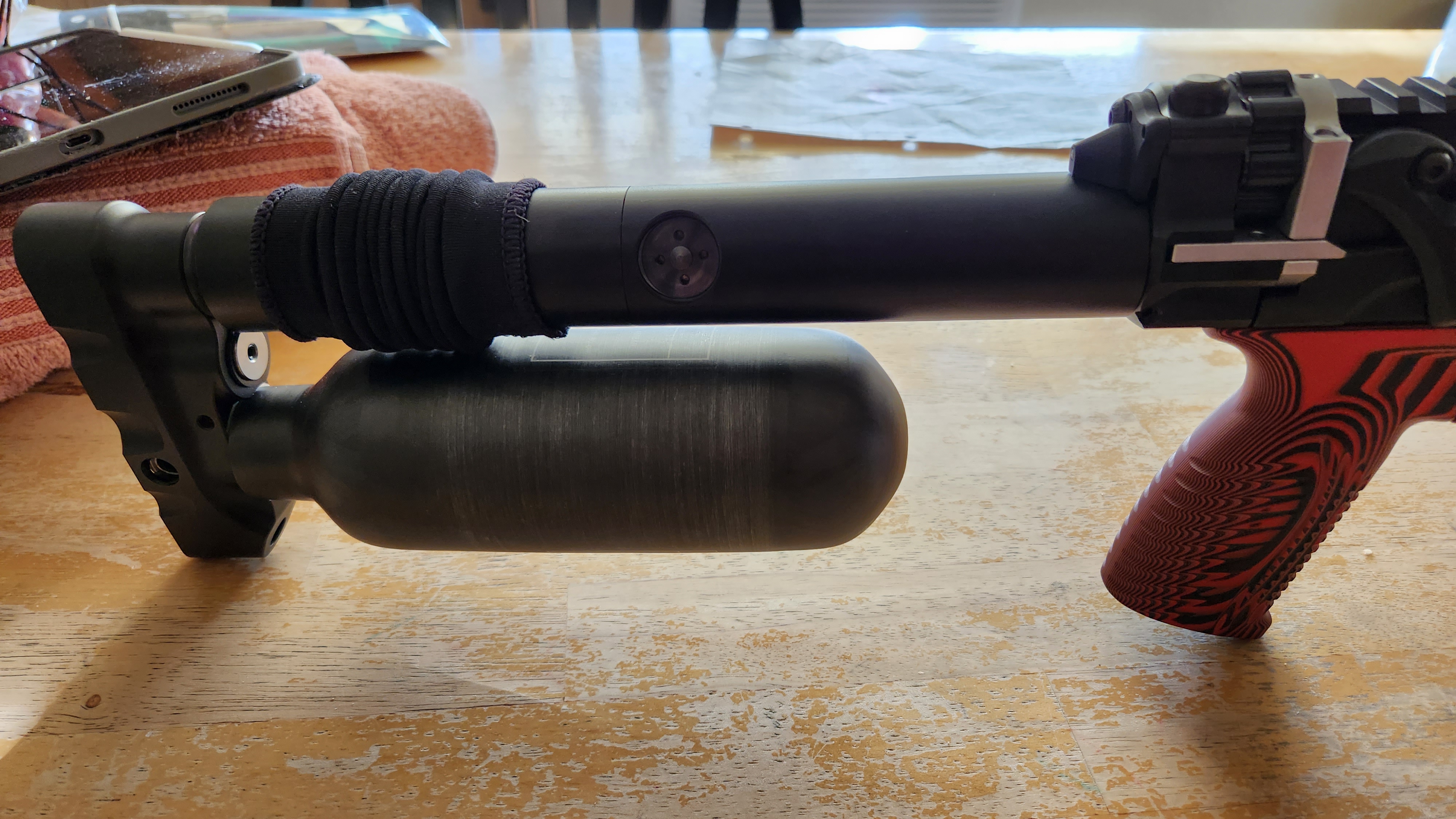

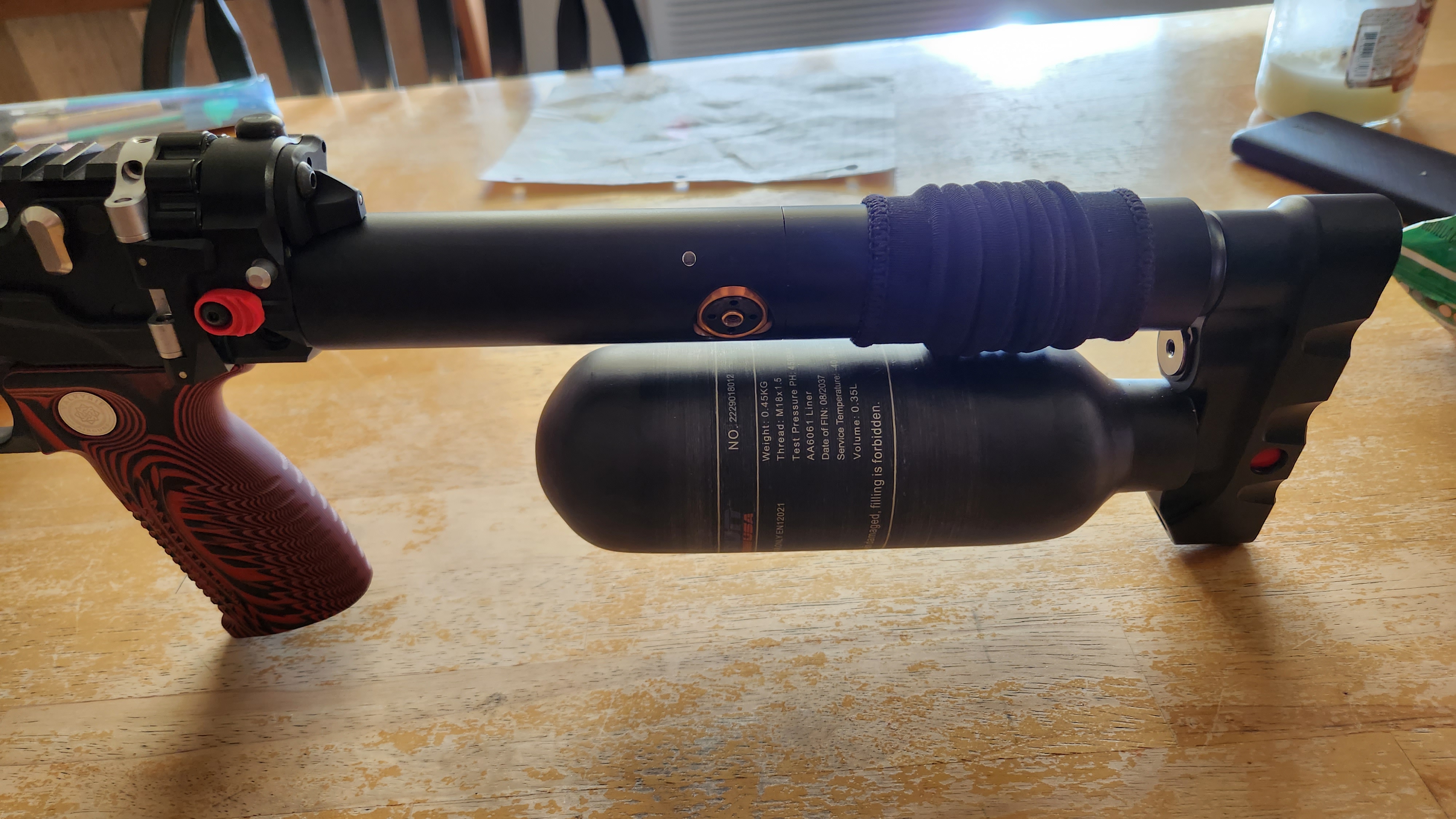

Can you take some pictures from both sides of the regulator. When its fitted.
Also pictures of the whole gun from both sides - maybe there are other visible changes

Yeah im only putting in about 180bar just to test things but I have done 270 bar and got the same results as far as the super high spread on first 2 shots. I'll take some exterior photos after I get home from running errands.
I dont think I see any external changes based on other leshiy outside of the repr system. I think the metal index bearing for the rotary mag started becoming standard prior? maybe not? Bleed port on backside of the gauge in butt is present. Im not sure when plastic rotary mags started getting used either unless that is new.

Nothing looks different to me? The silencer I have not fully taken apart to check but quick glance I dont see much.

There are two ways how to eliminate a creep from REPR.
#1 remove the Reg core (only) and pressurize the gun, leave it overnight. That will make the 2mm ceramic ball create an indent into the delrin piece. Detailed instructions in the L2 Mega thread.
#2 I toke a 2 mm pin and made the front edge into a ball, lapped (with diamond compound) that ball end into the delrin piece.
In over a year the Reg never creep again. And couple months ago I even removed the digital gauge, easier to store the L2 this way, and for any tuning using the radar only...

Thanks for the tip so as some have said its basically a "break in" procedure of sorts. I'll have to see how that works on this. Heres a pic I haven't shared yet but the new repr system can come out as a whole unit by just removing the retainer pin.
