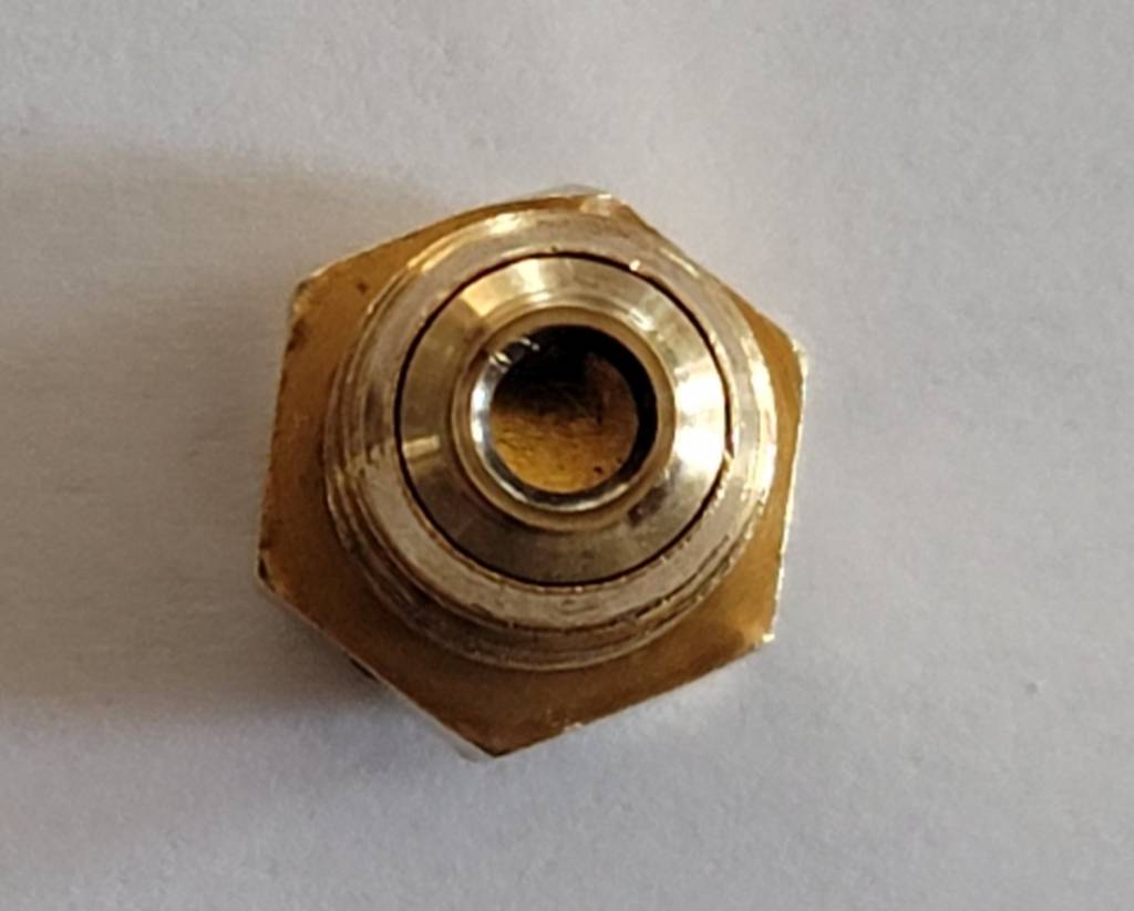

Filling my 6.8L tank for the first time my compressor gauge poop the bed. I replaced it with a M10 bolt. I then noticed I bad a bit of an oil leak and when I checked the 4 bolts on the front cover, all were not tight. Went to top off my tank today and the relief valve was leaking. I put a new burst disc in it and it was still leaking. Searched the forum here and found out there is supposed to be a white plastic washer in the threaded hole. Put the compressor up on the bench because the floor is too low, check the hole and there is no white plastic washer in there. I took one out of the spare parts, installed it and finger tightened the plug and gently snugged it up. Started the compressor and it was still leaking. Tightened it a bit, still leaking. Tightened it some more, still leaking air. Pull it out, place a bolt in the hole and no air leaking. My tank has 2 gauges so I started the compressor and filled from 200 bar to 300 bar staring at the gauges. Purge the lines, shut everything down and it looks like there is a small oil leak somewhere on the back of the compressor. What's the chance there's a loose bolt somewhere back there.
Does the whatever it's called on the right look like it's cracked? Could this cause the leak through the vent hole?

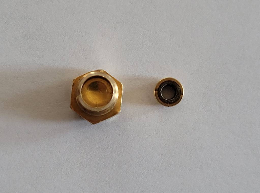

The main purpose of that part of the burst disc assembly is to push against the burst disk itself to seal it. So long as it is not cracked all the way through so it will not seal at the front surface, near what looks like a crack, it should be OK. Still it is ugly and I would probly just replace it as the part is so inexpensive.
Edit; Oops brain dead yes it looks cracked and ugly so needs replaced.
