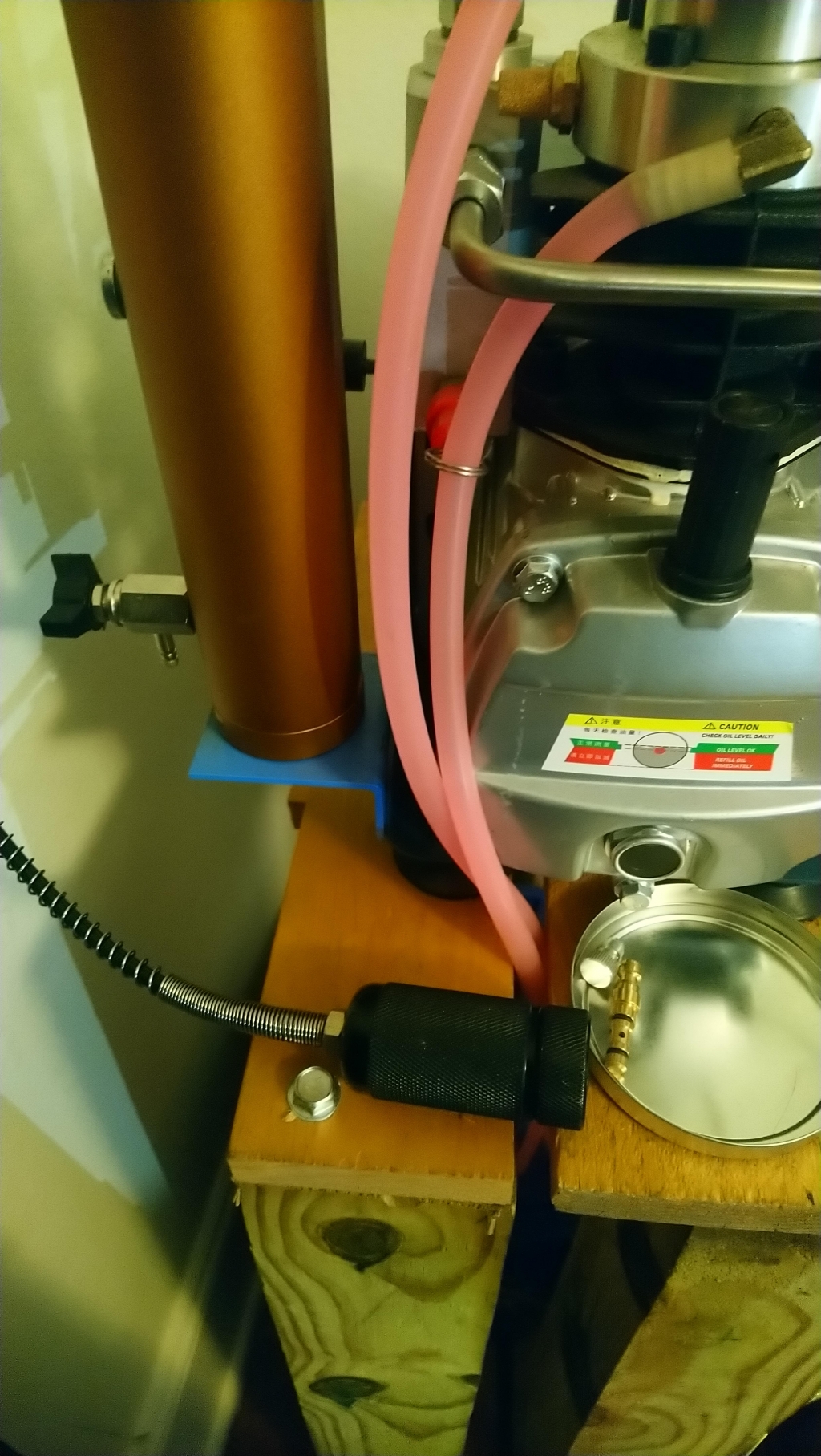

@Redick and @Long_Gun_Dalla, what secondary filter do you suggest? There are the big "gold" ones out there with the tampon like filling and others with the tampon/desiccant/charcoal filling?
Thanks for the tip on the water wetter!
I've been using a gold filter that come with a mounting bracket. They're on ebay and ali, just a bit tricky to actually find with the search engine. It's a cyclonic charcoal filter that sits upright. It has a drain spout, I'll bleed it once in the middle of my 9 litre top off (while still running) and again when it's done.
I got the filter because I couldn't find another with a drain spout anywhere near that price point ($100). There's an air tank and compressor vendor that sells filter setups that are completely over the top that have a drain like mine. But the price will have you bewildered. Anyhow, I also run the cotton filter it came with after the large one. It's always bone dry.
