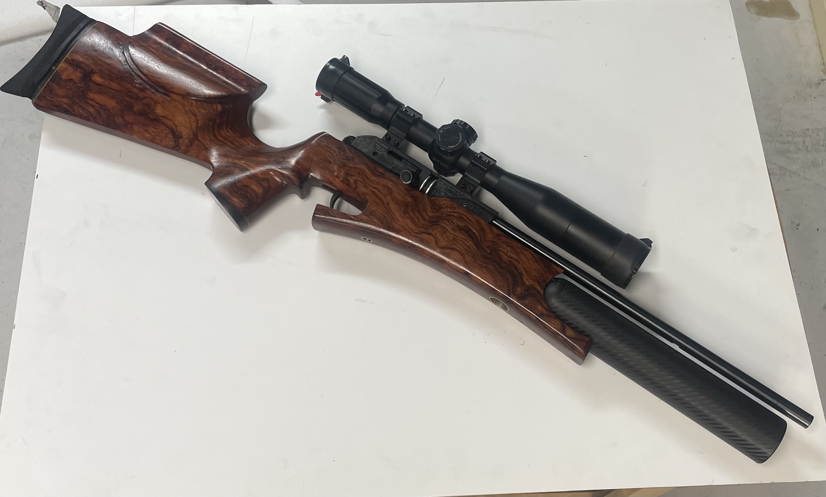

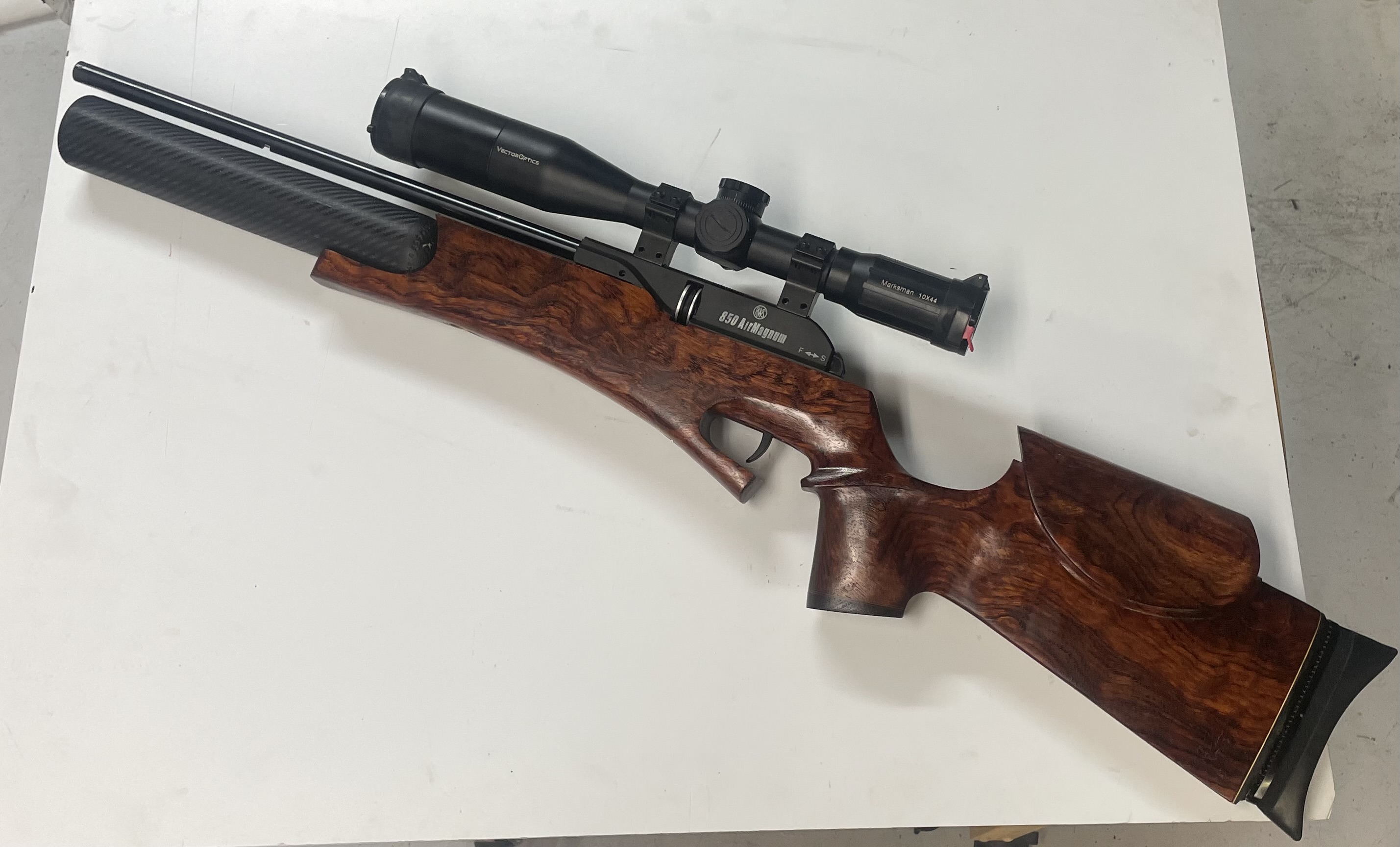

Now for the fun part. I promptly replaced the bottle with a 22ci /360cc bottle I had on hand . Tested the regulator and it was set at about 1250psi. I removed a few shims ( it’s a spring type regulator) and got the regulator down to about 1000psi. I then shortened the barrel from the 24” length down to 18” . About an inch past the bottle. This brought the overall length to 37 1/2” . Loaded up another magazine , and started tuning by finding the max velocity with the existing hammer spring. Maxing out at 780fps which I think is pretty healthy for the 1000psi. I opened up the action and had a look at what I could do to tame it down to 750 or so. The hammer was removed and it weighed a whopping 62 grams. I knew I could make it a bit lighter by drilling some speed holes in it. I got it down to just shy of 50 grams ( still heavy ) and moved onto my spring assortment. I found a single spring in my stash that I thought might work. Put the rifle back together and now it’s shooting at 730 for average . So just shy of 10 fpe. And just about right for my intended purpose . Mounted a Vector marksman 10 x 44 fixed power scope to keep the weight down. Here are a few pics of the rifle. I have a few more items I’d like to address, like the trigger, somehow fitting a gauge and maybe try my hand at stippling the grip and forend as it’s pretty slippery when shouldered.
