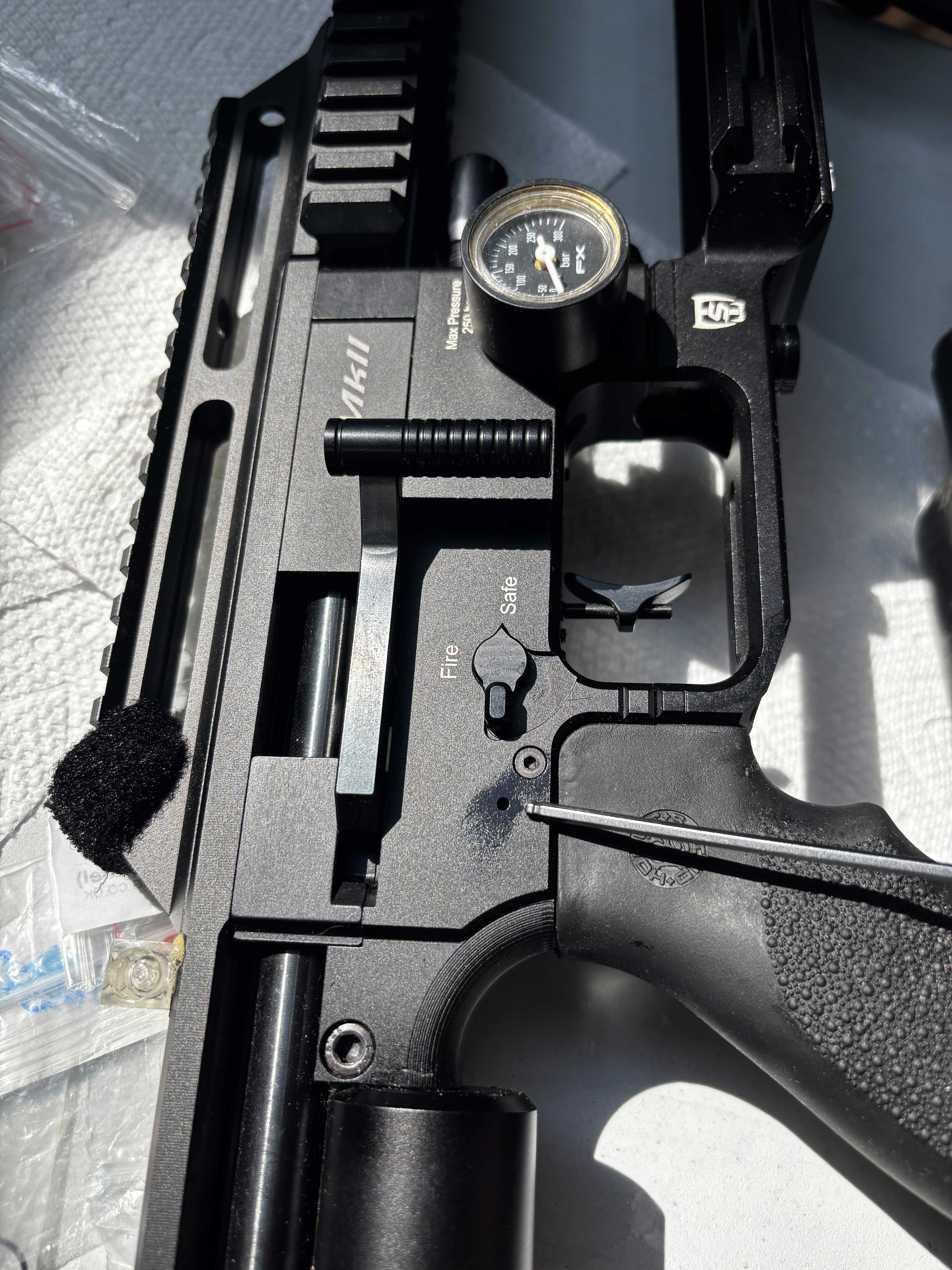

After seeing the pressure slowly dropping and tank emptied, I tried to investigate and found out where the leak was. At least this was what I found thus far.
Air was coming out from the hole behind the trigger lock as shown in the picture.
Anyone has any ideal on how to access and fix this?
Much appreciated.
The dreadful Impact leak issue has happened to me now.
Much appreciated.
regulator..replace all 5 o rings..I did it a couple weeks ago..not tuff don't be in a hurry..
I could do it again in hour or less..first get the rings..I bought mine from..https://spares.bagnallandkirkwood.co.uk/..Iam sure you can get the @cape fear air guns in Carolina...you tube is your friend on this.
I did a impact X..a 6 year old gun..first leak..all the best
Luckily it's pretty easy to remove the trigger and the regulator and handle it. It could be worse and you'd have to re zero the gun completely afterwards.
Take notes of the plenum pressure and the velocity you had and you should be able to get right back to where you were.
