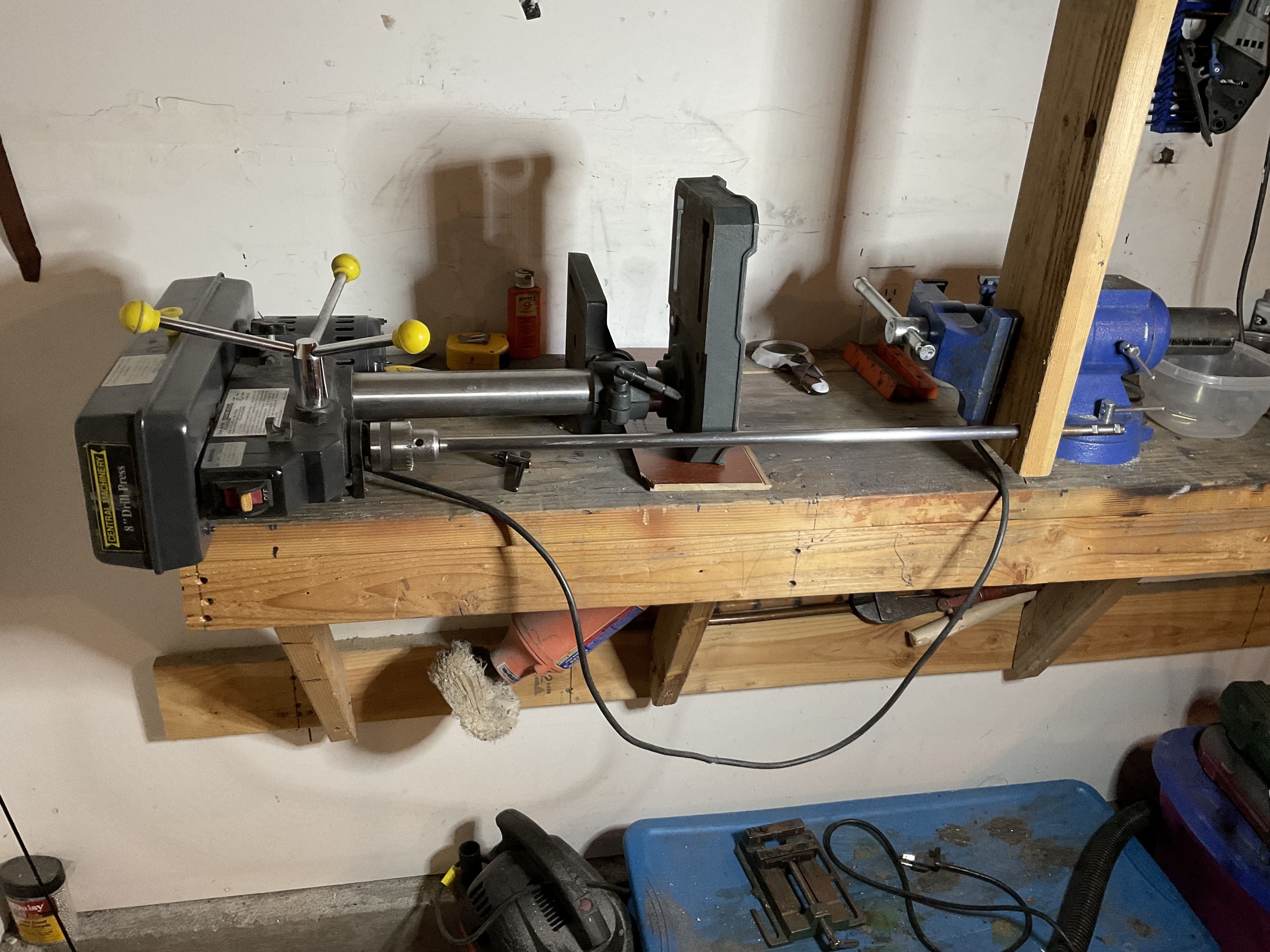

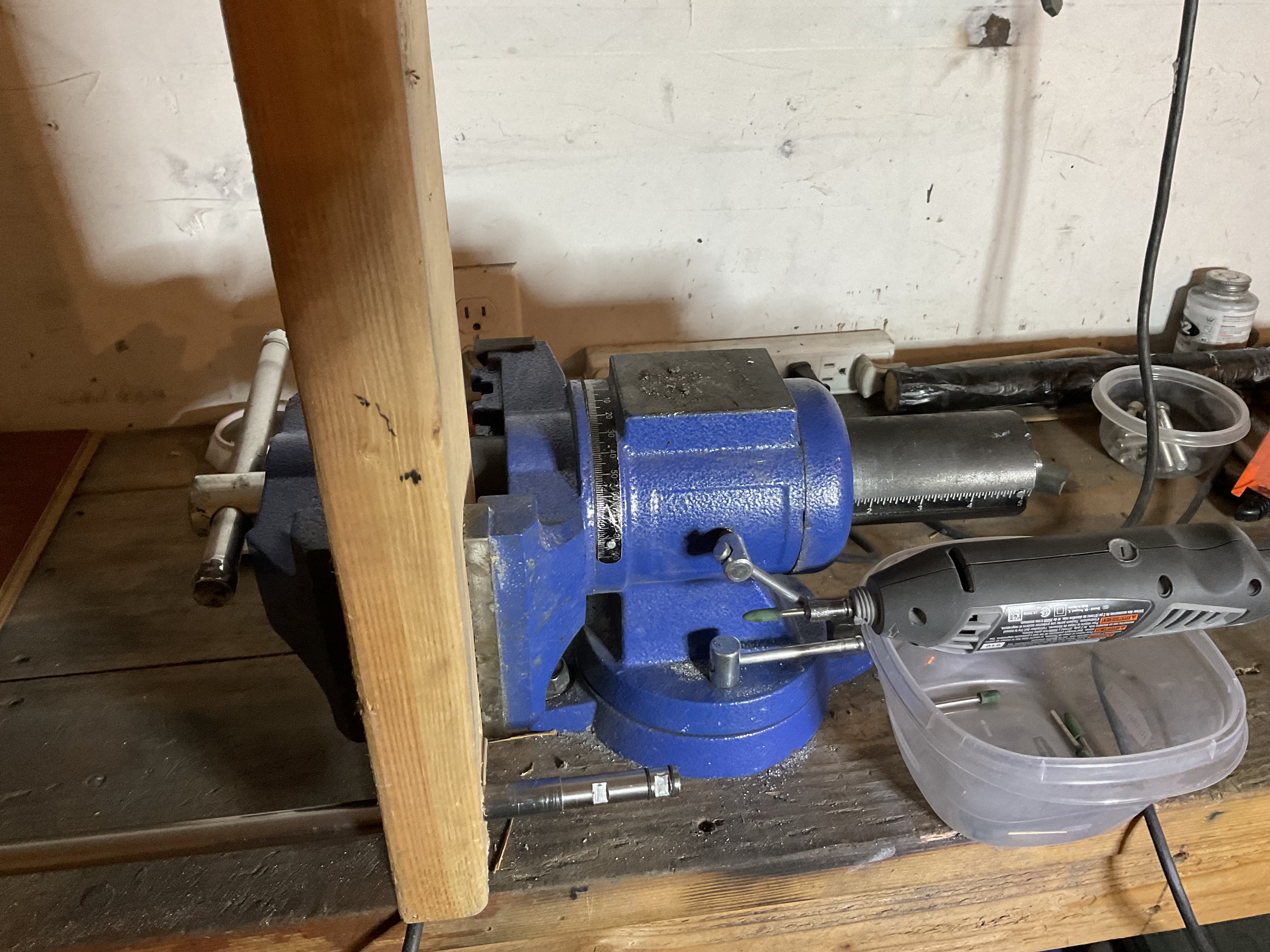

If I have to cut a lead beyond the present chamber, I will spin the barrel in my drill press lathe while turning a .233 cratex bulb in a Dremel against the bore at a maximum depth of 1.1 inches, which exposes .40 of the rifled bore to the craytex bulb, the original chamber Troy cut will be untouched.
All this sounds difficult, however the craytex bulbs grind very slowly and doing it with the barrel spinning gives a pretty consistent lead. I will need to use several bulbs and many .249 sized 257420 slugs for go-no go gauges. The craytex bulbs will only contact the first .40 of the .245 rifling I need to relieve.
This is not a untried procedure for me, I sent Doug Noble a 1-10 twist TJ barrel to machine the breech dimensions and not to chamber for my Haley 257 Scandalous a decade ago, I cut the chamber using the above method until I had a chamber that would take a .257 Hoch tapered slug. It took hours and many .25 craytex bulbs, but in the end I had a chamber and lead for a tapered slug that fit like a wine cork gently pushed into a bottle.
This will only involve first .40 of the rifling so it should not take as long, it just relies on a lot of those .249/257420 np-go gauges being used and going slow. If it all goes to hell, worst case senecio is a bill to chop 1 inch off the barrel and a chamber and lead cut.
