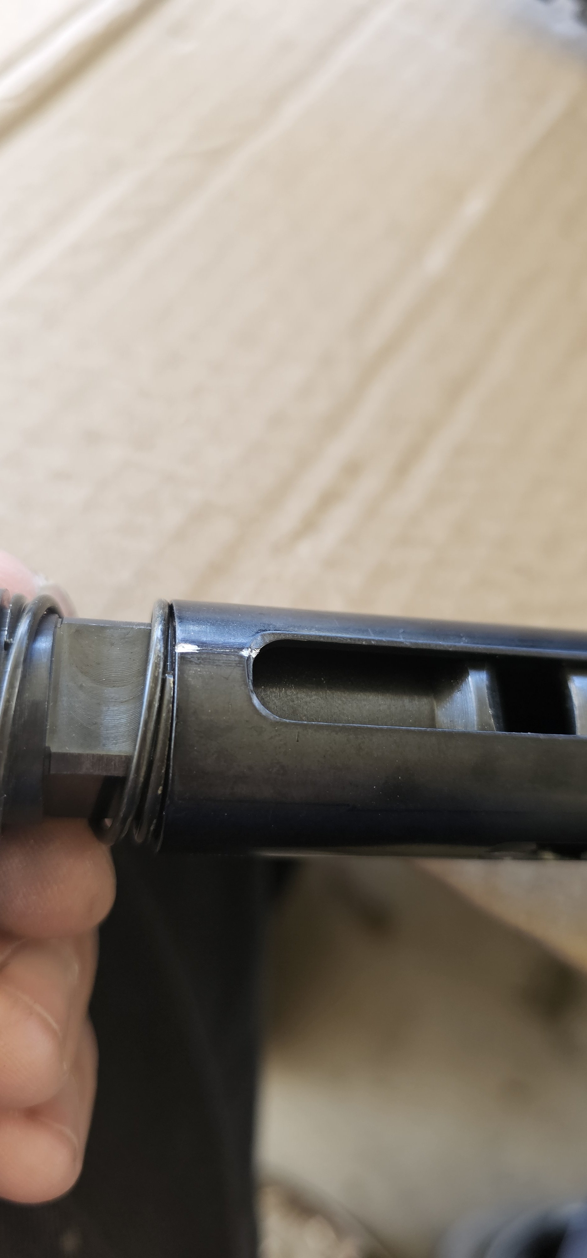

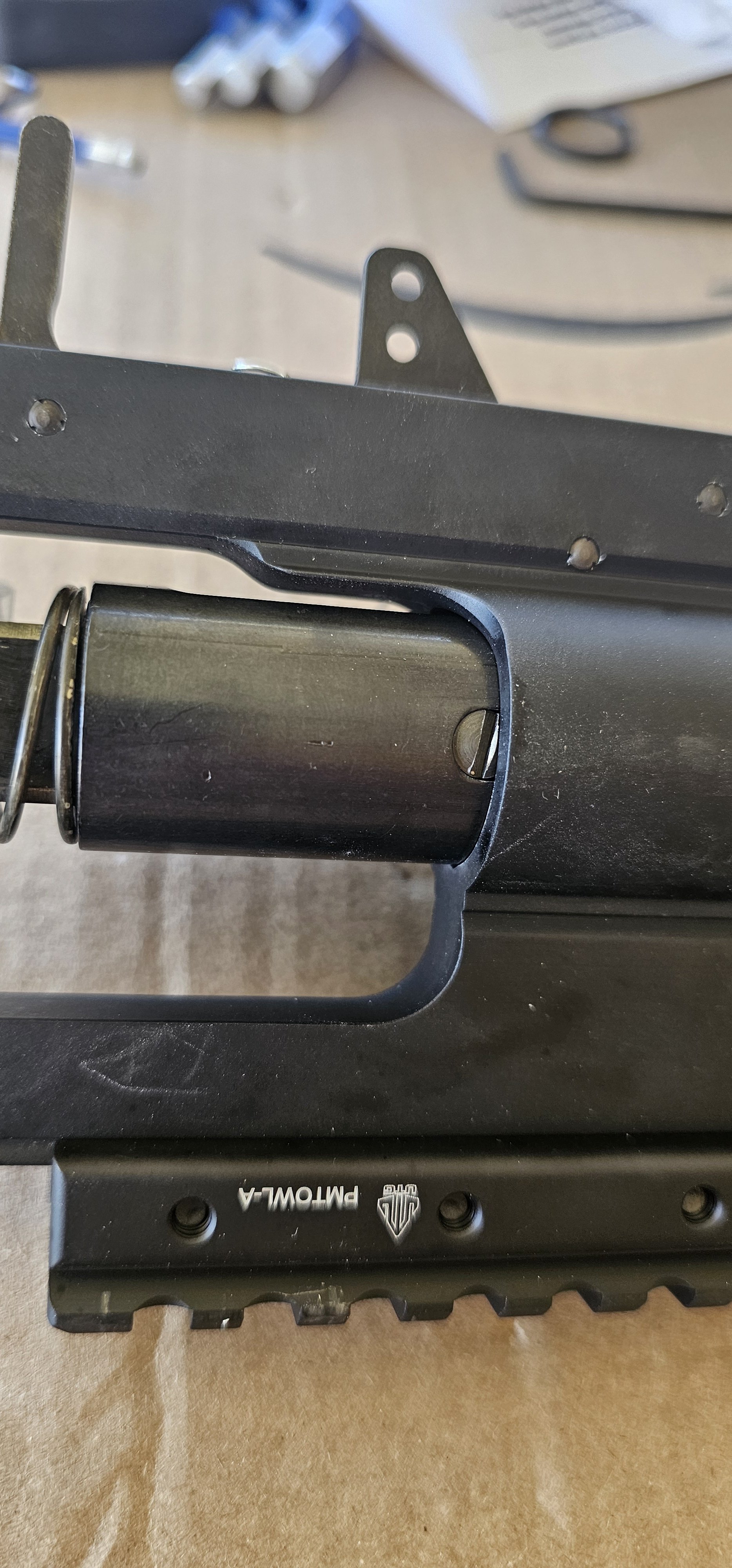

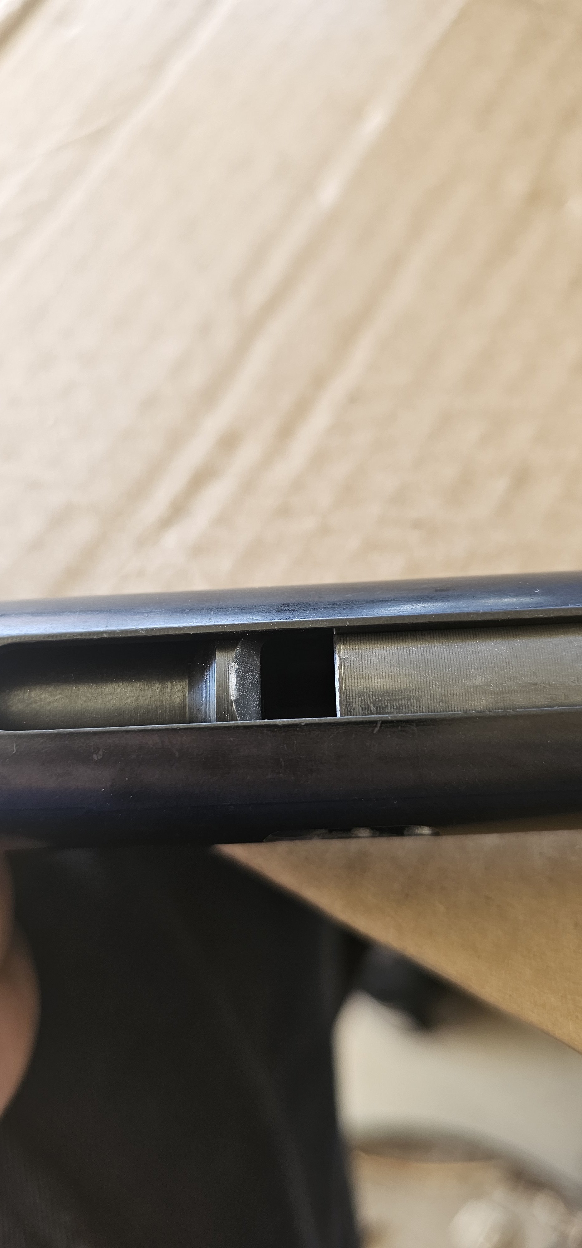

Shot the gun today experimenting with diffrent holds
Found it likes to be held firm.
Talked to Airforce via email and explained having to cycle the cocking lever to release the saftey.
The informed me that the issue is caused by a soace/washer on the wrong spring and to move it to the sear spring.
Done that and the gun was stuck cocked and saftey stuck on.
The gun felt like the lever was scraping metal.
found some loose screws on internal moving parts.
Im sending the entire gun back to airforce.
There is almost zero lube on the moving parts.
There is alot of visible wear from the sear.
Not happy with this lemon nightmare Texan.

Your 457 TX2 valve will have same auto saftey problems..I had multiple problems with mine until i fixed it..I have to change the carrier tube on my .510 Texan tonight..Last day of hunting season both screws stripped out... Airforce auto saftey has problems there are quite a few new Texan owners having the same problem...I like my custom condors with a super sear and no saftey at all..Nice light crisp trigger,,no creep..Much better than my Texan...
