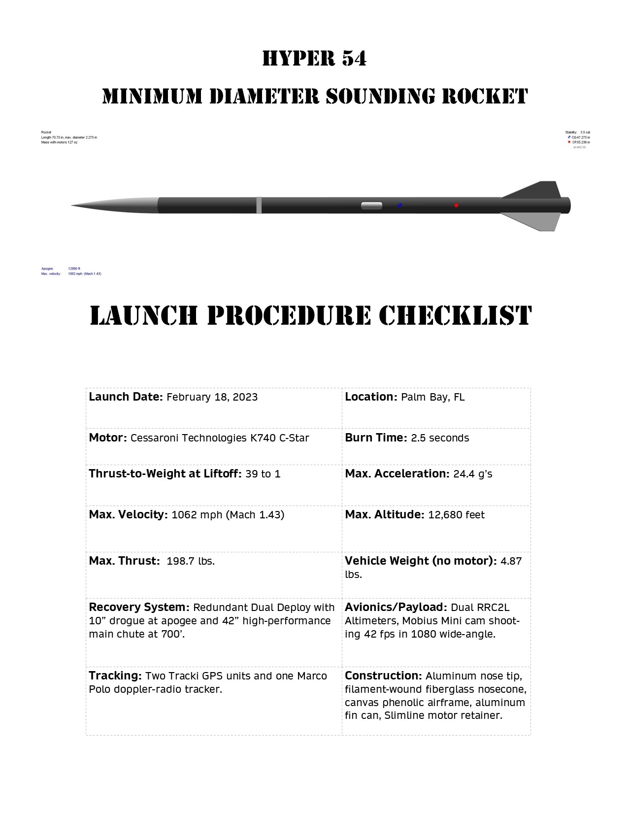

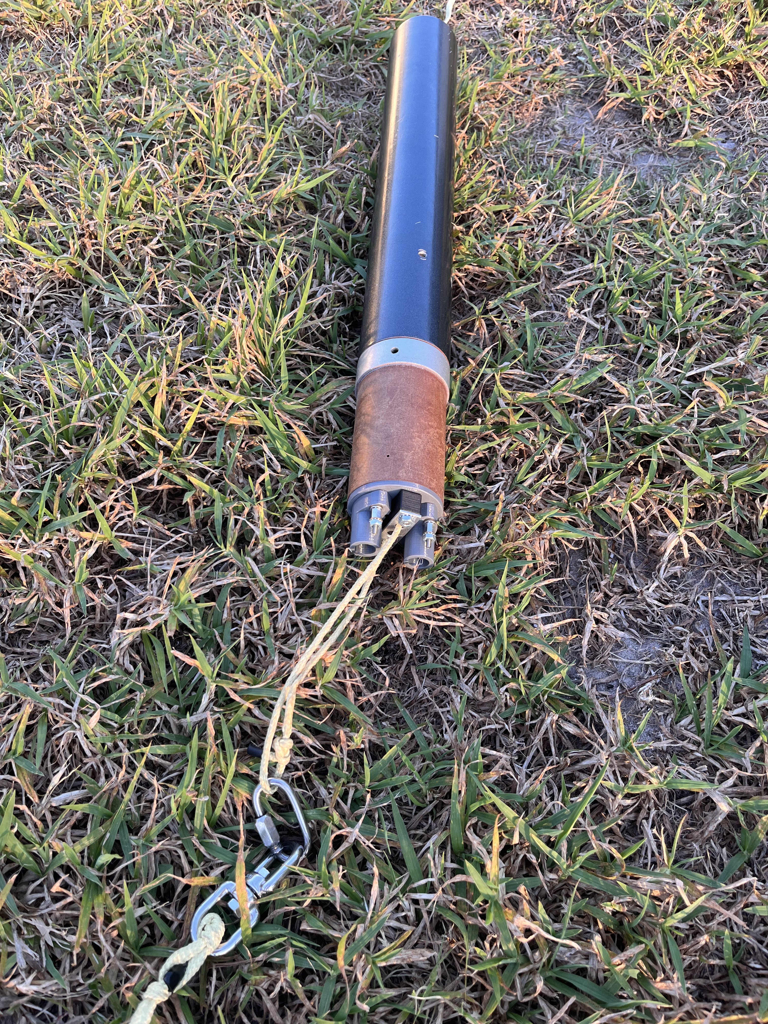

Planned flight for Saturday. 24.4 g's acceleration and 1062 mph (1557 FPS ) according to the simulator (which is remarkably accurate). I bet most pellets beat the crap out of it in acceleration, though. Probably by a lot. It would be interesting to know what kind of G's they experience when my .30 Terminator sends them down the barrel, say. Anyone know how to calculate this? I mean I'm not an actual rocket scientist. I just play one in real life sometimes.

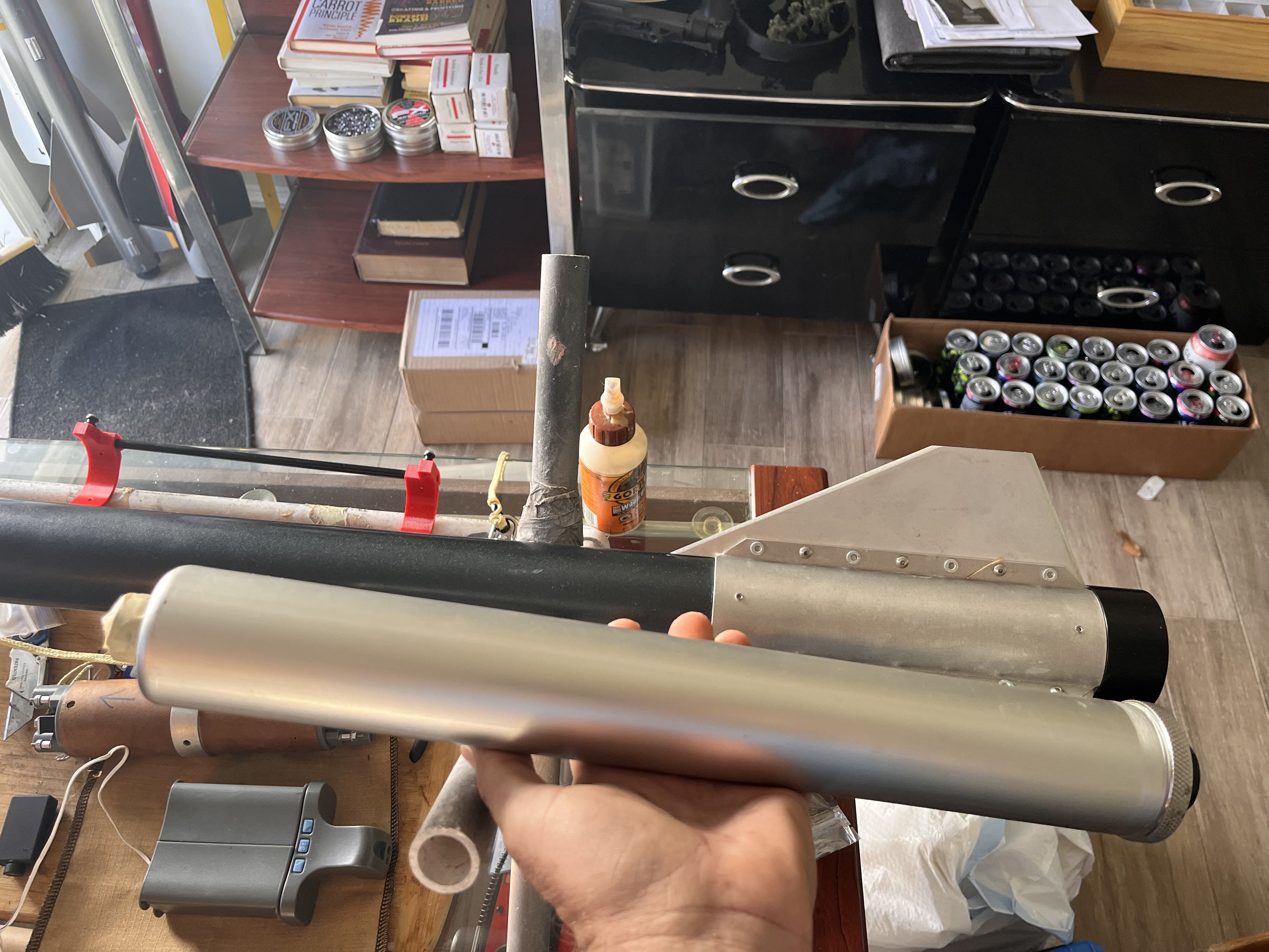

First rule of Flight Club is don't talk about the cost of Flight Club! But, since it's the same rule in air gunning, I'll make an exception..

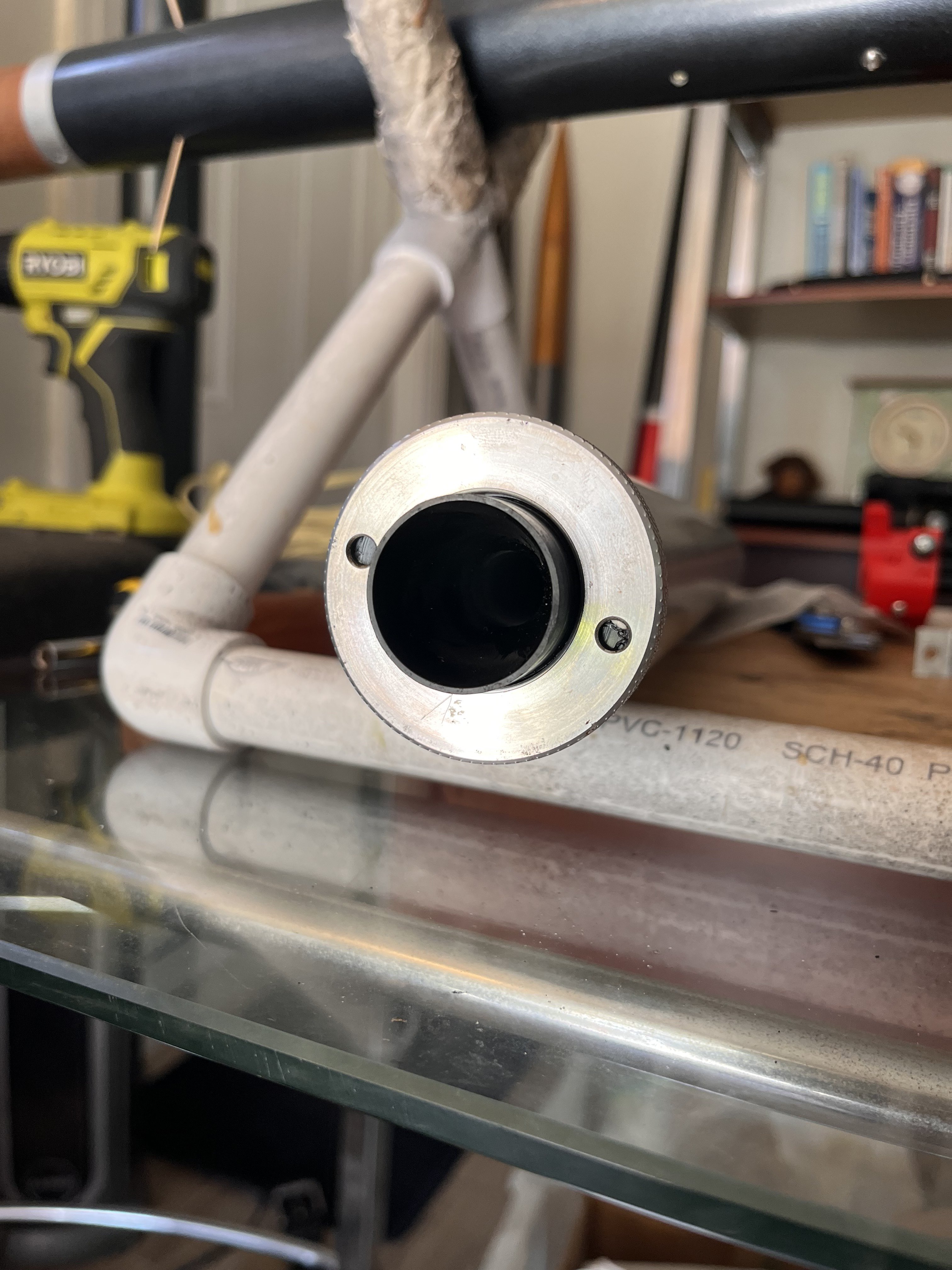

The aluminum case is re-usable so long as you don't lose it or blow it up. I think it was $90. You can use a pretty good variety of motors with it. The "Load Kit" was like $130. It comes with the fuel grains, nozzle, forward closure, and some O-rings. It takes about five minutes to have it loaded and ready to fire. I have another case like this but almost twice as long. L-class motors are available for it. I launched a six foot, 3" diameter rocket on one:

Nice. Wow, wasn’t aware of the $$ rule. I don’t know much about amateur rocketry. It’s nice that engine bodies are rebuildable.

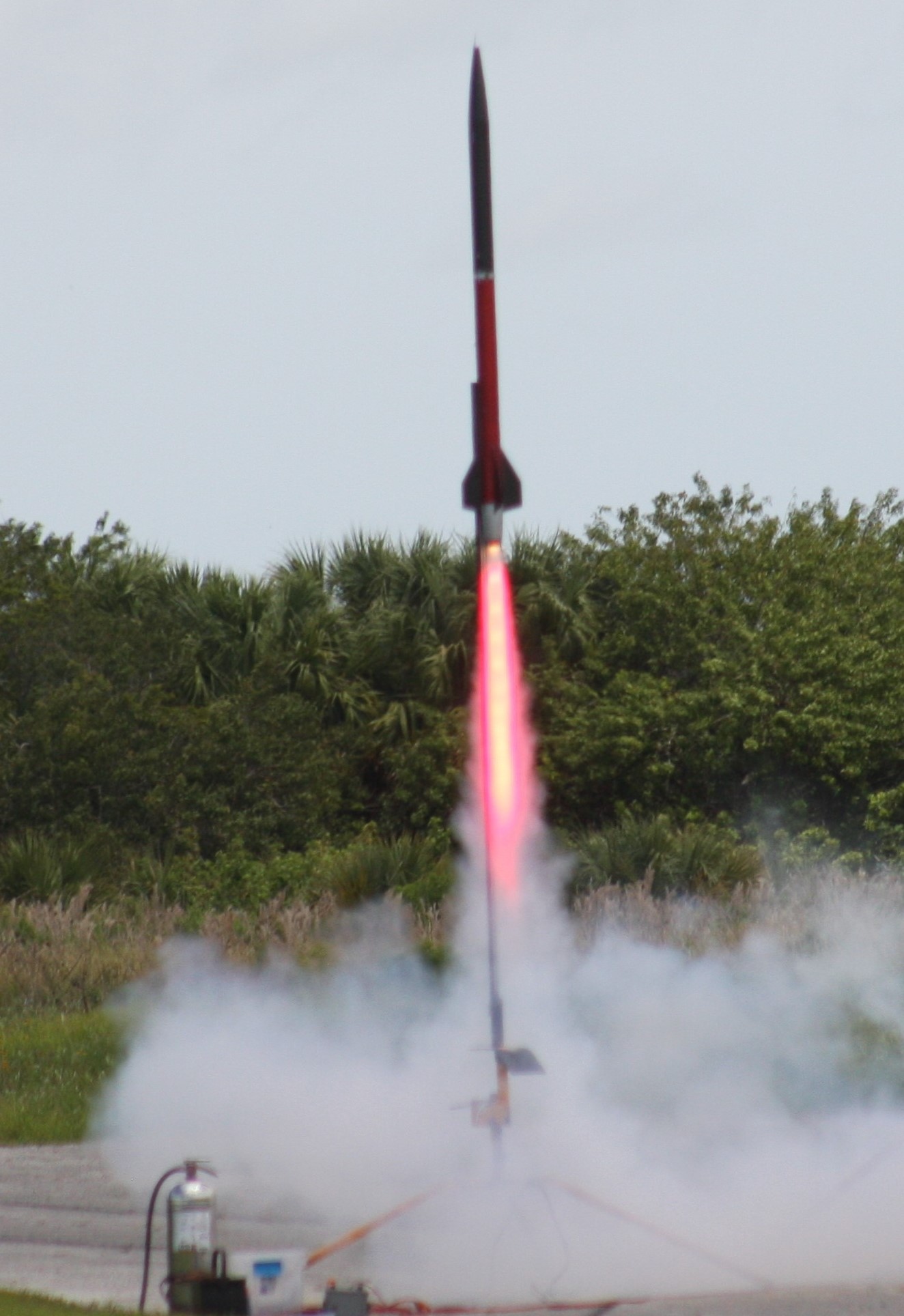

This is my 2.6" Pike that took off so fast and went supersonic so close to the ground, you can hear the "pop pop" in the video. On the onboard vid of the same flight, you can tell when it goes supersonic by the flickering of the exhaust plume just before burnout. That's the double shockwave interacting with it as the rocket punches through the sound barrier.
