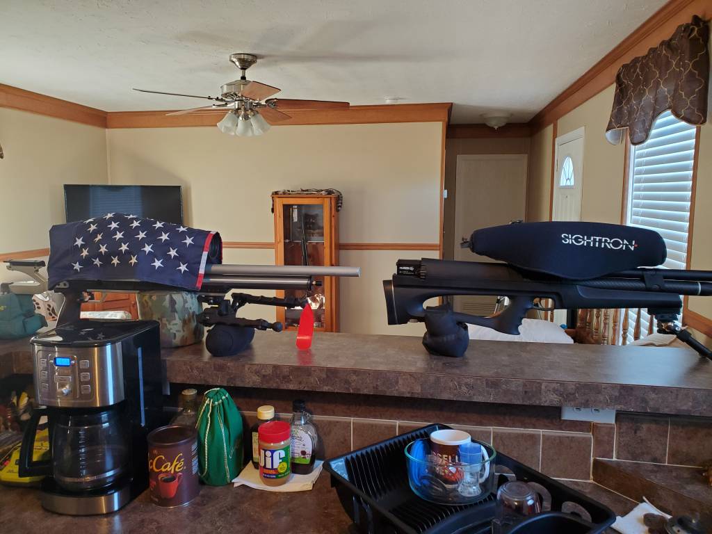

You owners of the Huben should look into this little invention of mine, to guarantee a precise setting on the barrel when reassembled. Makes pulling the barrel off for cleaning worry free, and you’ll have the barrel reinstalled back in as the factory had set it-
both pics are of LCS’s-
