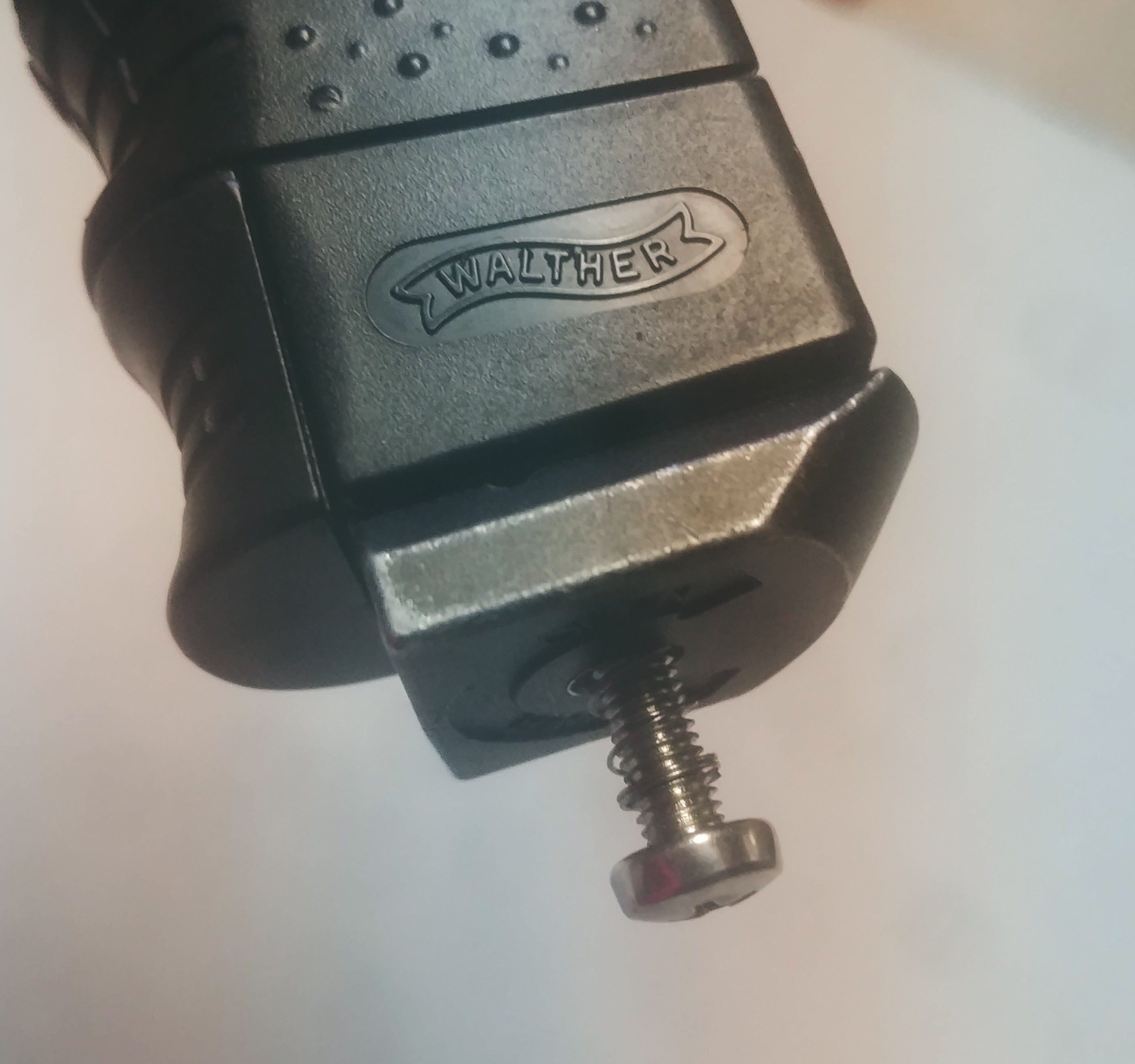

I pierced the part #69 on the schematic and removed the #70 part.

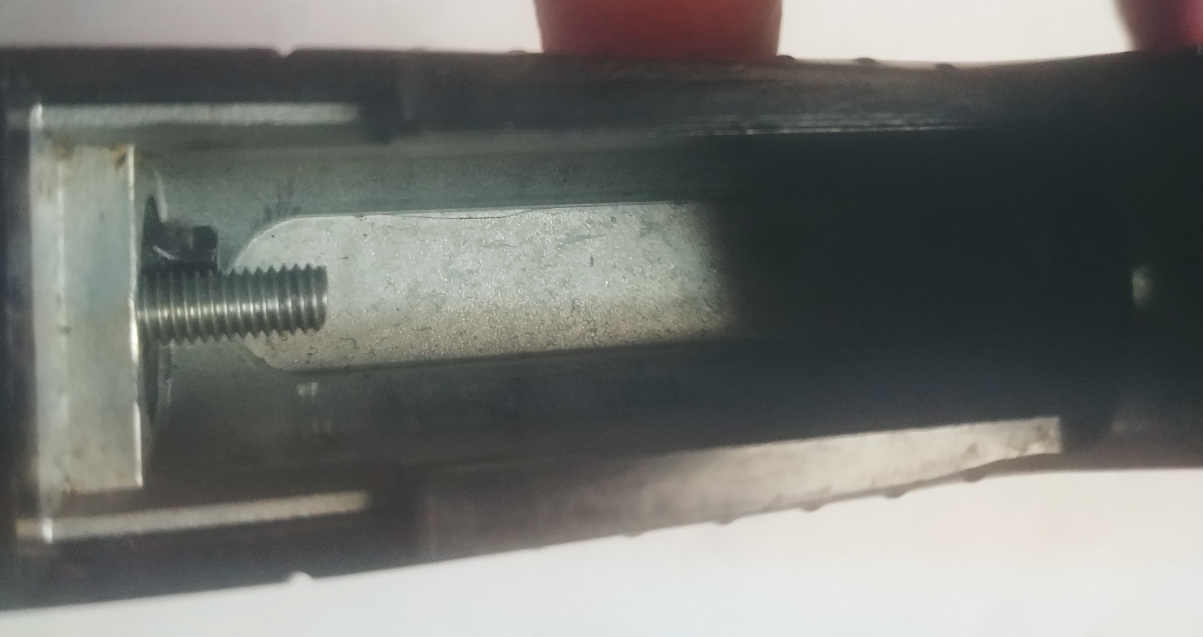

Then I added a simple bolt that fits the #69 treads (I think it's metric).
That simple mod now gives me total control over how far the bottle is pressed against that seal.
The gun immediately stopped leaking.
You can also notice that when it is unscrewed, I added a little tension spring around the bolt just to keep it from accidentally loosening while you're handeling the gun. I took the first spring i've had readily available in my toolkit, it could be stronger tho.

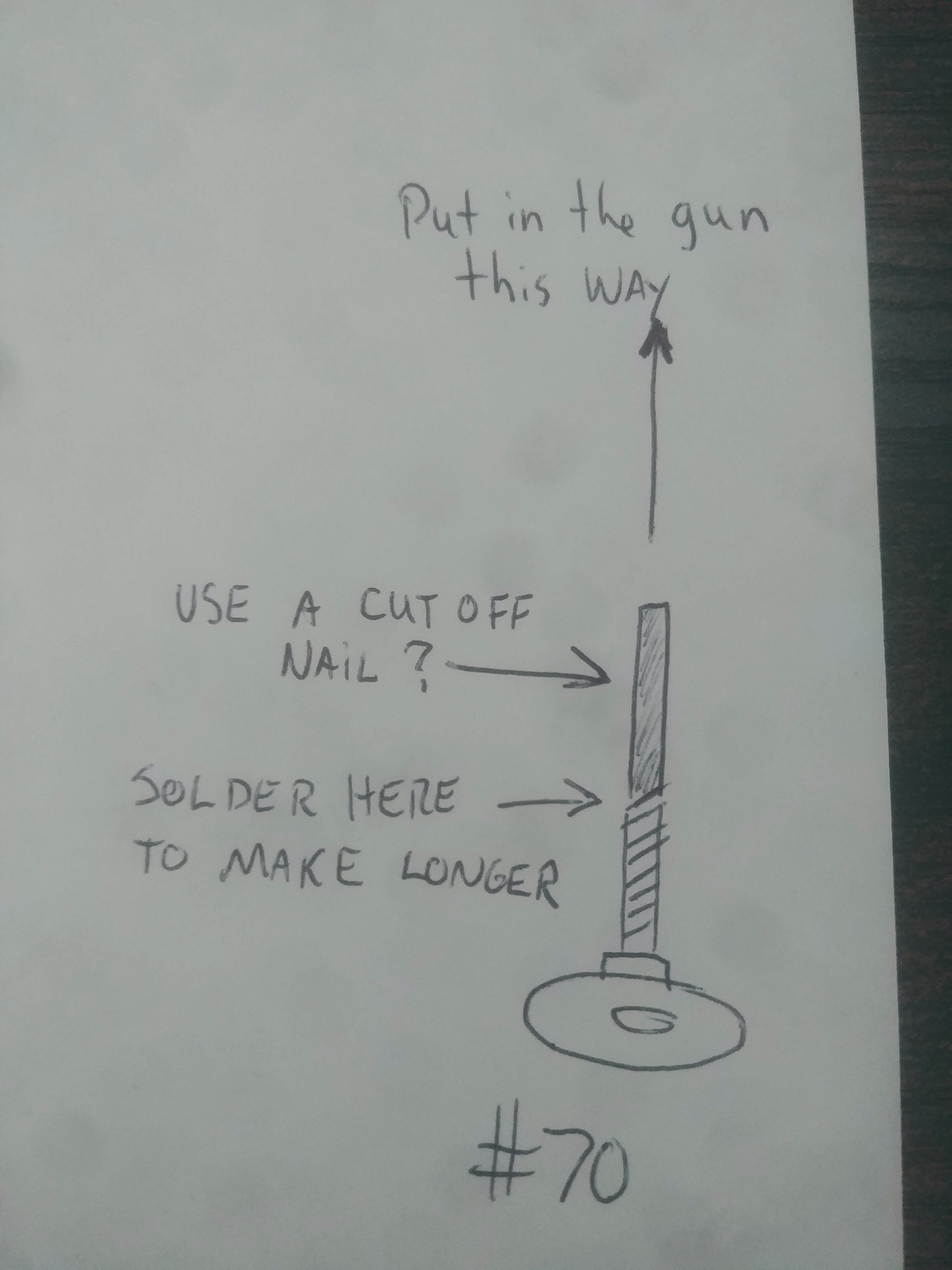

Now what I want to do next is to change or mod the bolt itself so it could be something (like a small swivel) that I can operate only by hand.
Part #70 would have it been longer would have done a wonderfull job if screwed backwards. Making it longer will involve a little bit of soldering but it would give me a way to operate it by hands AND to be very very very discrete, almost un-noticeable.

BTW the bottle doesn't need to be well seated at the bottom, it works just fine with the tip of the bolt (which could be buffed to be smoother and round)
But if you really want something to seat the bottle, a lock nut screwed backwards and full of locktite could be a nice add-on tho I would fear it could make the bottle turn while you screw and ultimately it won't be very good for the seal. Less friction is better.

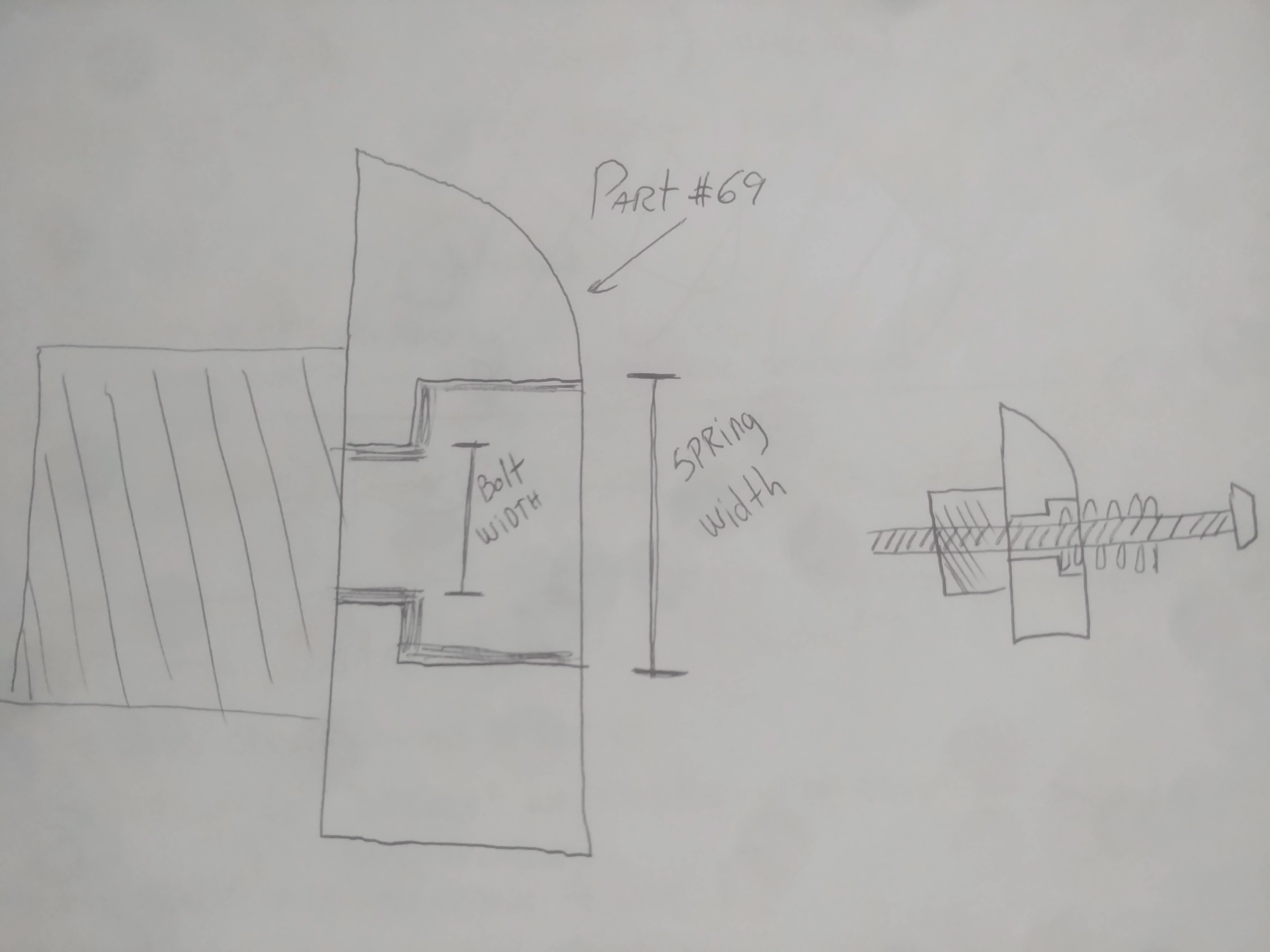

This is how I managed to pierce the bottom just in case you wondered.
I've used two different hole sizes.
One for the bolt and one for the spring
* A different thing I could have done just in case I didn't want to use a tension spring would habe been to hot glue a lock nut in the hole so the bolt would rest tight in place.
