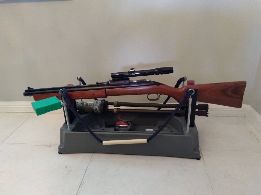

I decided that my 47 year old Blue Streak needed another chance to have a good life so I ordered a $32 repair kit from Mac1, made a couple of tools to get it apart, and in short order it was back in service. I bought the gun new in 1973 and I think it has been about 15 or 20 years since it held air and functioned. I was pleasantly surprised at how clean everything was when I got it apart. The pump cup was hard as a rock and I'm sure that was the main cause for it not working, but both of the valves were showing their age (dry and hard) so they got replaced too. The gun pumps up now and holds air indefinitely. Took it out in the back yard and shot it off shooting sticks and a bucket (hunter field target style) at 25 yards and it shot very well with it's original open sights. Of course now that I am much older than I was in 1973 I have to use my reading glasses just to see the open sights so the target was nothing but a blur. It brought back a lot of very good memories!

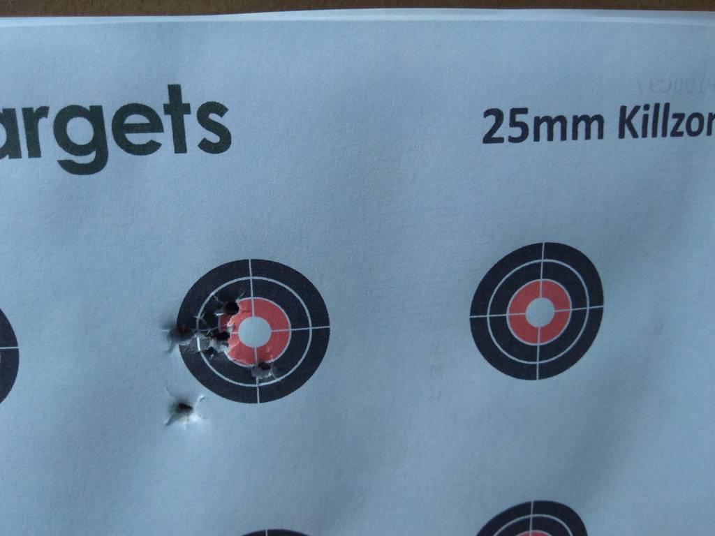

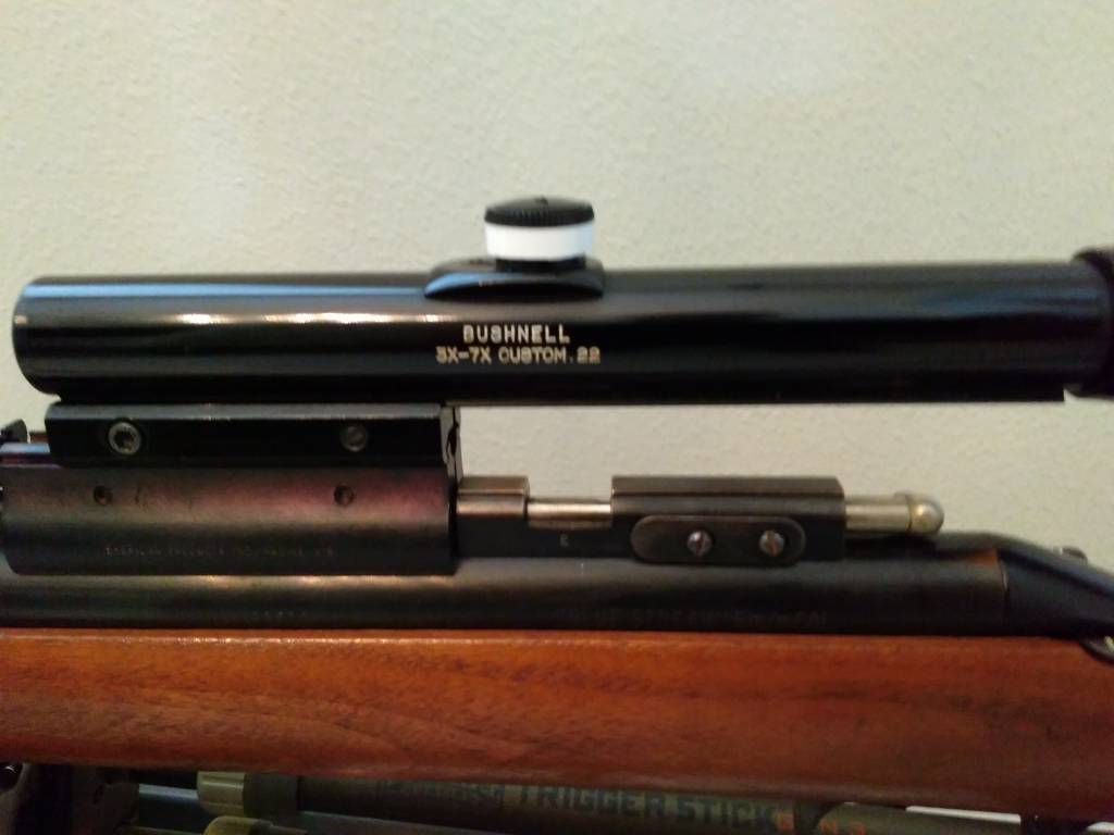

Stuck an old 3-7 Bushnell scope on it that looks sort of period correct. Got it pretty well dialed in at 25 yds once again shooting off of sticks and a bucket. The target was shot at 25 yards using 6 pumps. Don't know what happened on that low shot, it was shot number 4 and looked and felt good when it broke. Then shot number 5 was right back up in the main group. Of course the trigger is really bad, has to be like 6 or 8 pounds to break so that could be a contributor too. I'm really happy with the way this has turned out, it's like a trip down memory lane!
