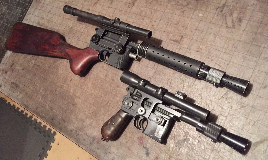

I will be doing this build a bit different vs. the Han Solo DL-44 or the X-Wing Theme build. The DL-44 took a lot of effort to make it as screen accurate as possible. The X-Wing AirForce Airguns TalonP was meant to capture the feel of something that wasn't a gun at all - a star fighter.
I am going to build this gun as a Mandalorian Bounty Hunter concept carbine based on a lot of Star Wars and Mandalorian history. I will be researching a lot about the art form of model builders from the original Star Wars Trilogy.
If you are as big of a Star Wars geek as me, you understand the deep and meaningful history that went into the original blasters and weapons found in the Star Wars story. Many of the original rifles and pistols were based on WWII era weapons with a few "add-ons" to make them look more space aged, but keeping with a battle worn and rugged look.
Fun Star Wars fact! Most people can recognize many of the original star wars blasters based on some well known firearms, but did you know in the most recent Mandalorian series, many of his guns are AIRGUNS???!!!! Yup - that is right - the Mandalorian is a fellow air head!
The Star Wars community of fans have already identified at least 3 obscure airguns in his collection. They are the: Apache Fireball Air Pistol - Webley Tempest Air Pistol - Webley Premier Air Pistol. I will be adding the Benjamin Marauder Pistol to this list.
There are quite a few scenes where Mando goes to his arms room on board his ship where there are tons of sweet looking blasters. I will be using a lot of the design concepts from these blasters to build my own.

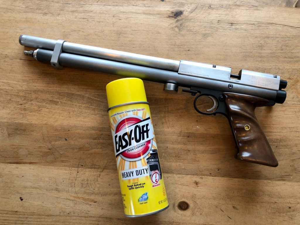

First step - disassembly and distressing. When most people get a new airgun then pamper it and don't want a single scratch on it to keep it looking new for as long as possible. Not this one! I need to make this thing look like it has seen battles all across the galaxy and maybe even spent some time in the belly of a Sarlacc on Tatooine. I even bought a lighter branding iron to possibly burn the Mandalorian logo into the wood grips or stock. We will see where I go with this.

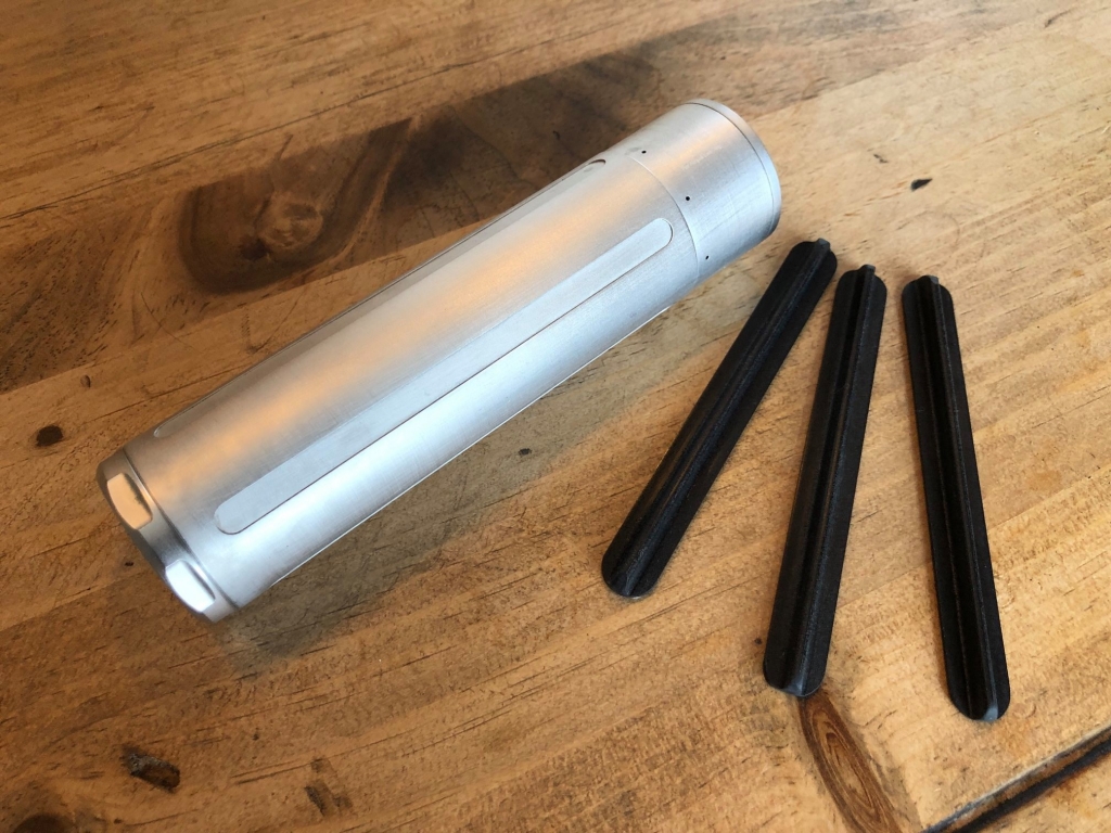

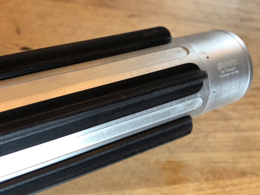

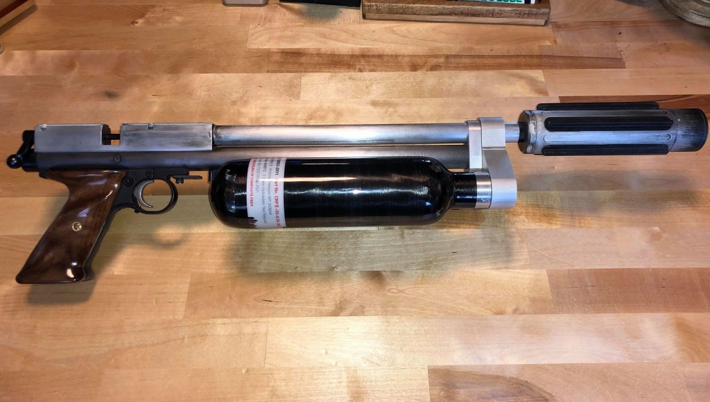

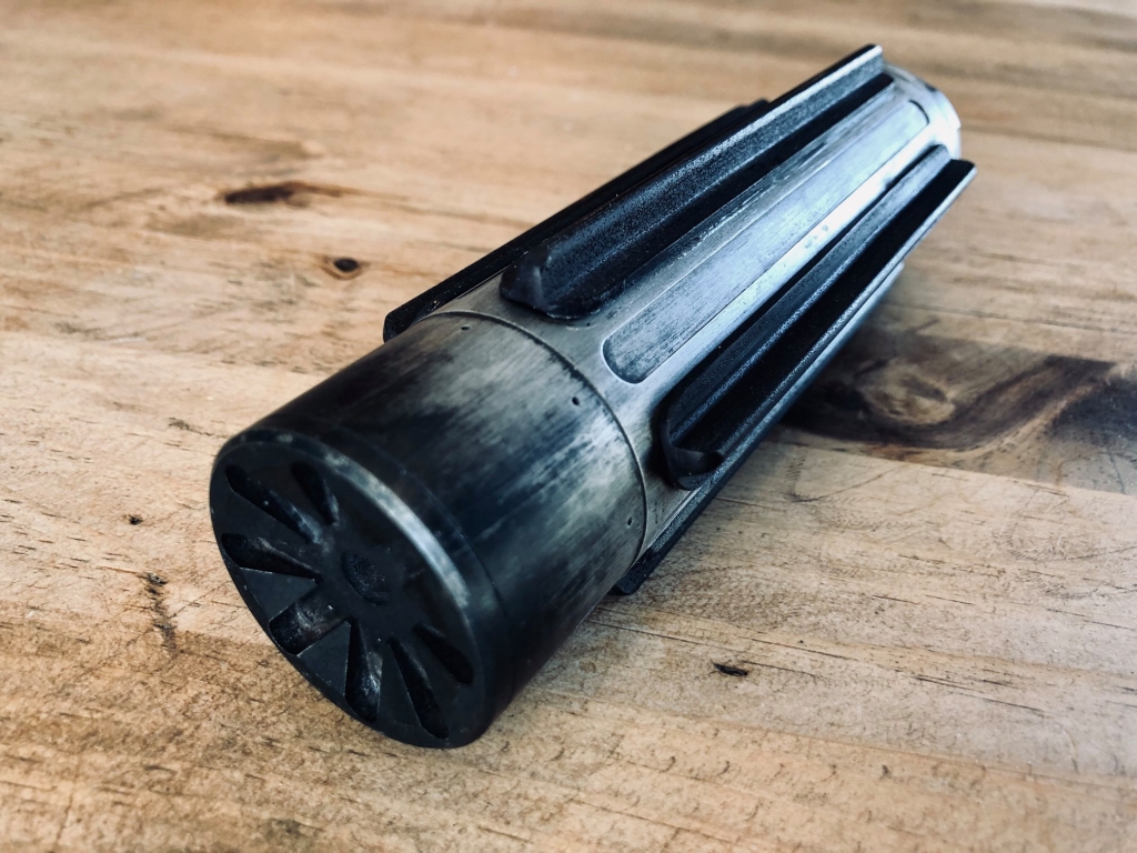

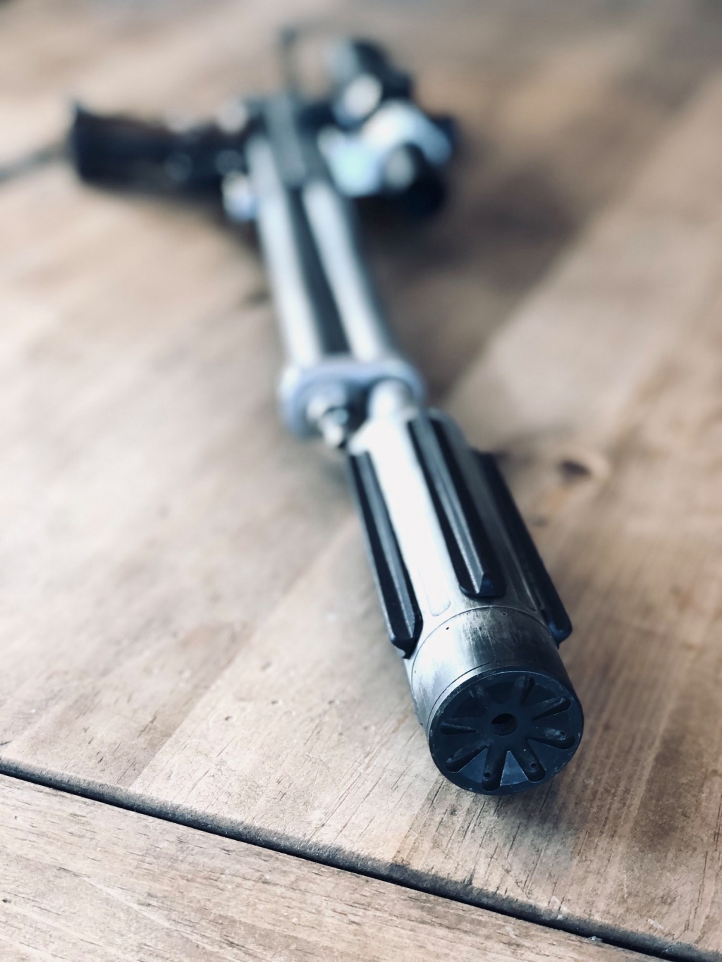

Got some photo updates. Decided to change a few things up on the project and use the DonnyFL Sumo on the muzzle with a little Star Wars bling with some T track I had laying around from a previous Star Wars project....
All I can say is, I get by with a little help from my friends... Huge shout out to Maverick Stone, Eric Smith, and Rich Dudek for talking me through some ideas for the Mandalorian Carbine concept built.

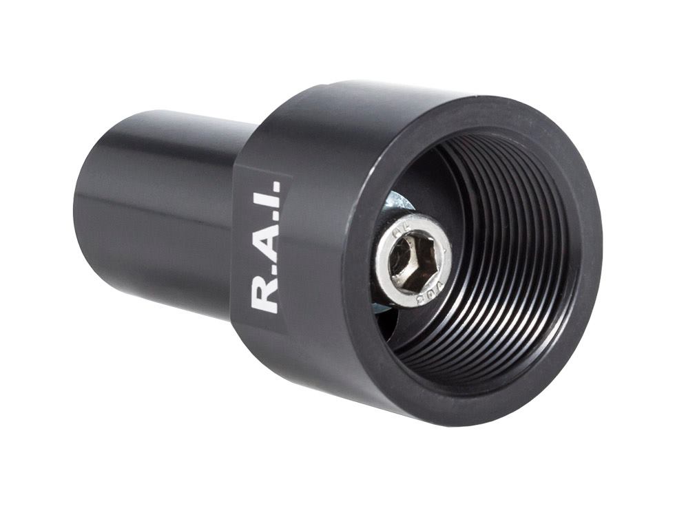

Also a big thanks for the tech support at Pyramyd Air for pointing me in the direction of this Air Venturi AR tactical stock adapter for the Crosman / Benjamin Marauder Pistol platform! Of course PA has a part for everything!
Check it out: https://www.pyramydair.com/s/a/Air_Venturi_Tactical_Stock_Adapter_Fits_Benjamin_Marauder_Air_Pistols_Crosman_17xx_Series/5322?fbclid=IwAR1Htx6cw16UqS6dYV2aZvMj3ZrDKPfp6r_u2XBmbVxf0ohcXcYj6M_TEQQ

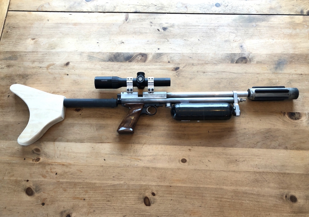

I went and got a AR buffer tube from my local gun shop and started mocking things up. Also, instead of diving into having someone CNC this thing, I decided to take a stab at hand shaping the rear wood stock by hand with a printed paper template based on the 3D Printer / CNC files Eric and Maverick helped me work on.
The issue I am running into is the funky ergonomics (or lack there of) and finding a good sight picture with the stock. I think with this new Air Venturi stock adapter, I have it figured out. This thing is pretty sweet in that you can adjust it up and down to really dial it in with the stock.
The bottle idea came from the GENIUS of Rich Dudek. He can even do a double bottle manifold if I decide to go that route. I have 2 small CF bottles in my stash just waiting for a crazy build like this. Still debating single or double side by side 350cc bottles up front. What do you guys think? Single or double?
This is a very rough cut of the read butt stock -TONS of shaping and sanding ahead of me... Stay tuned!

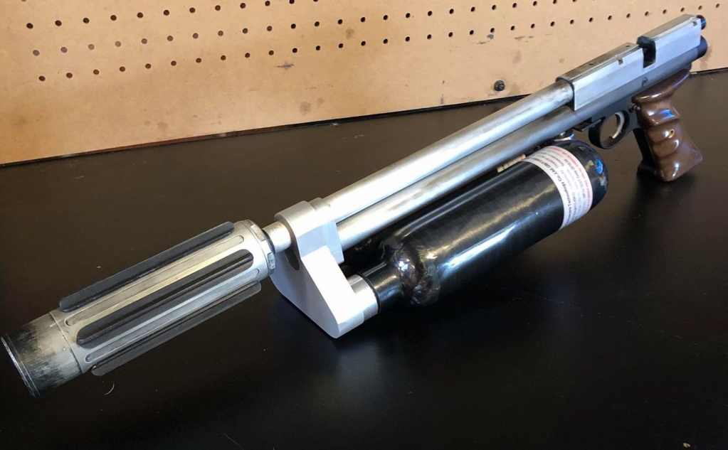

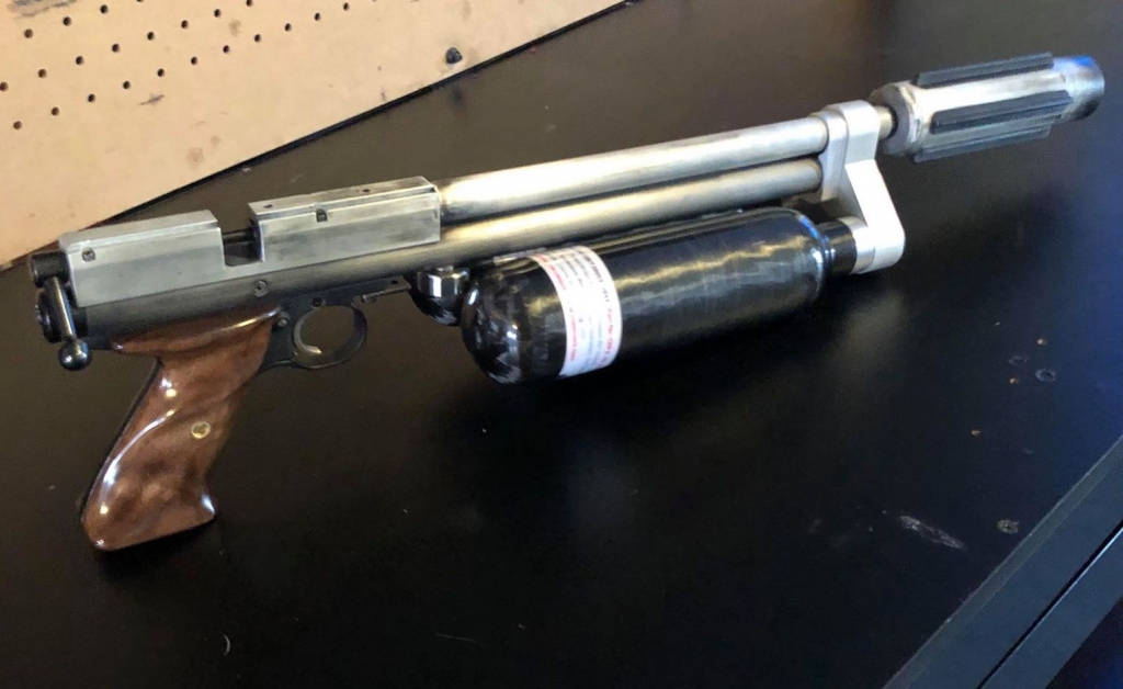

Holy baby Yoda! Just a quick update on my Star Wars Mandalorian concept airgun build...
This started off as a simple Benjamin Marauder Pistol I got from Pyramyd Air and is slowly turning into something I could have only dreamed of! Rich Dudek can take a crazy idea and turn it into a reality!
While I have been shaping the wood Mandalorian carbine stock to go with these awesome Maverick Stone wood pistol grips, I sent it off to Rich because he had some "ideas" for this project. He is adding a Huma Air Regulators inline regulator for 160 bar regulated pressure using the original air tube as a HUGE plenum with double 350cc 300 bar carbon fiber bottles mounted into a custom manifold that is a pure Dudek work of art!
This is going to be a galactic bounty hunter's dream .22 cal PCP! With that Star Wars inspired custom DonnyFl suppressor hanging off the end of this gun - it is going to be quiet AND deadly.
If you have some wack-o airgun ideas you have been thinking about doing - definitely get with Rich because he will take that crazy idea and make it a reality.
