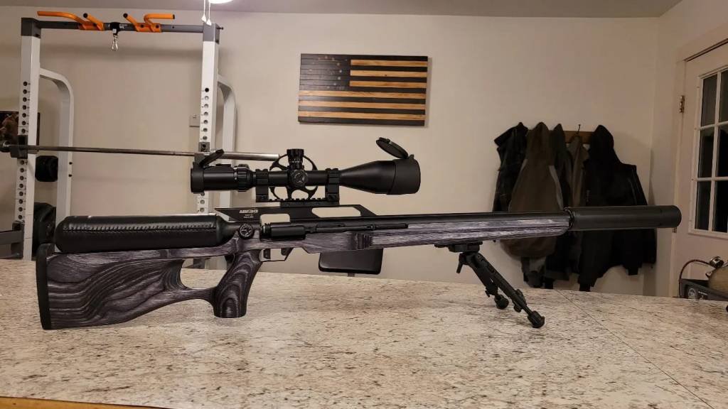

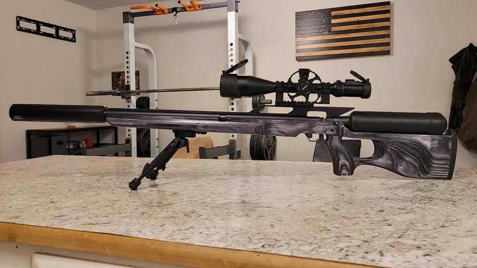

I have been working on this new design/ build for a while and finally have all the tooling done and the parts made to complete it. New stock design, new recoil pad, new cheek riser, and the new M-lok rail. It also incorporates my recoil lug mount that connects the stock to the rifle, which you can not see and my carbon fiber nylon trigger guard.
The older thumb hole stock will still be available. I incorporated the recoil lug mount that connects the stock to the rifle in the TH design, which really simplified mounting the stock. I also incorporated the carbon fiber nylon trigger guard, which makes the stocks compatible with both the Gen 1 and Gen 2 Airforce trigger guard rifles. It is just a matter of swapping the Airforce trigger guard for mine.
This is the older design as a thumb hole stock.
airforce-texan-stock-custom-green-mountain-camo-laminated-wood-stock-by-diamond-gun-stocks-img-8482-2_orig.jpg
The new BR stock design

In factory form the recoil load on the Airforce rifles reacts back through the chassis to the tank to your shoulder. This creates some flex in the action/chassis, which is not the best for accuracy. I started using a recoil lug that attaches to chassis forward of the rifle action and trigger group. It clamps to the chassis and takes all the recoil load of the rifle into the stock and back to the recoil pad/shoulder. This eliminates the chassis flex completely from the recoil load going through the tank and tank butt plate, which will improve accuracy. I also set the chassis down into the stock vs. perching it on top of the stock. I think that looks better and makes the chassis stiffer too. Win win.
Recoil Lug
Attachment Screws
I think it works. :)
