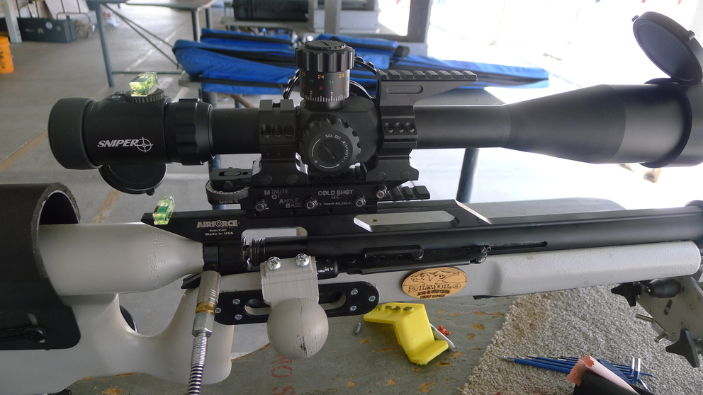

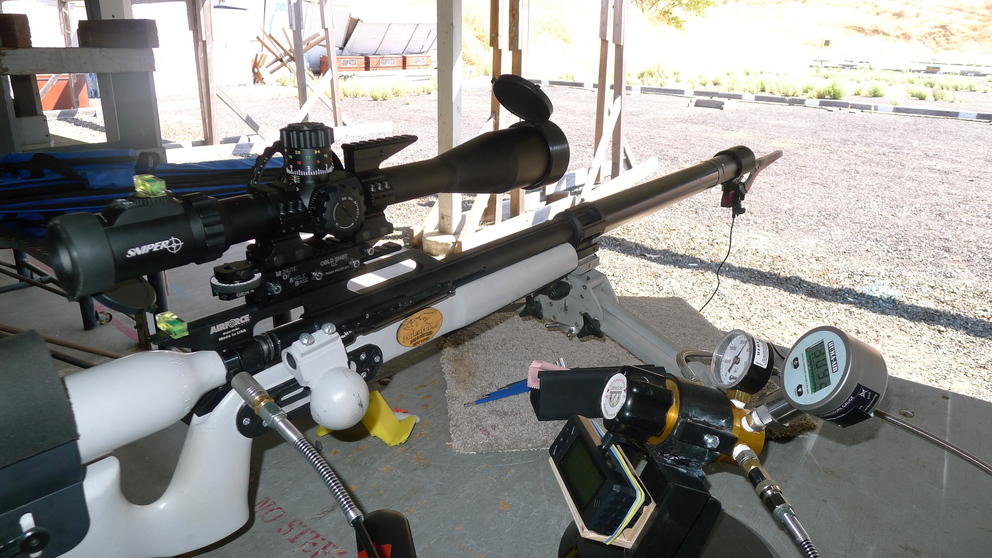

This is my new Texan .257 LSS setup for 200 yards
I have a new favorite slug for my .257 LSS
AVS .2573 Diameter Hollow Boat Tail 25 Caliber Slugs - Hollow Point 85 grains.

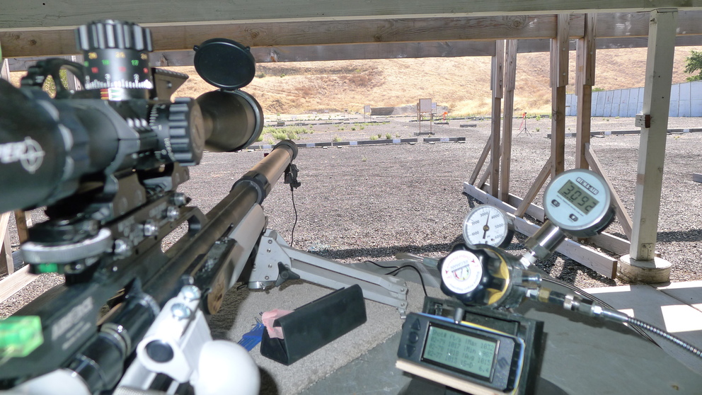

Shooting tethered 3100 PSI 1020 FPS.
I still like the Griffin 72 grain slugs. But I think I can reach out better to 400 - 500 yards with the new AVS 85 grain slugs.

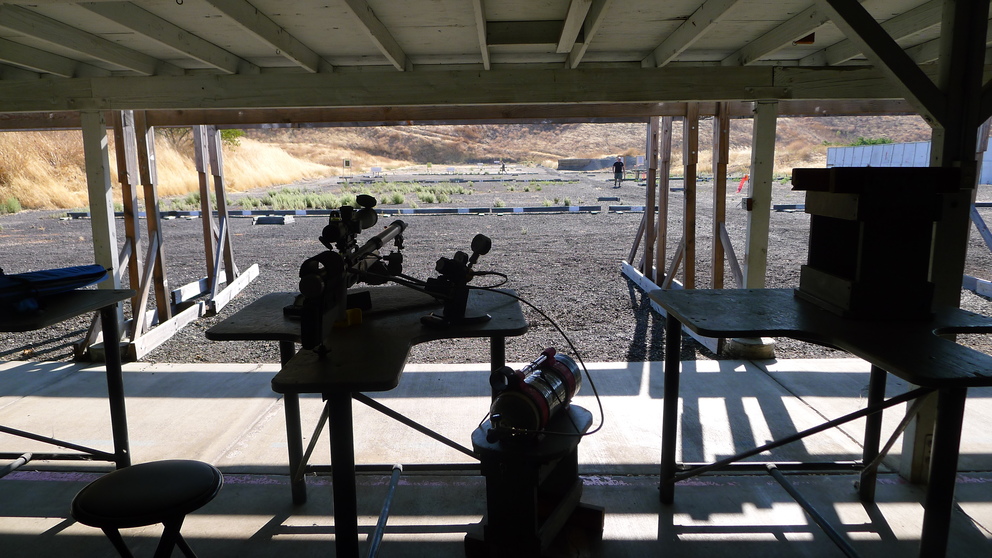

The only problem with shooting at 3100 psi, is that I can only get about 50 shots each with my 98 cubic foot Air Venture air tank. This also means that I need to bring 3 full tanks to each shooting session.

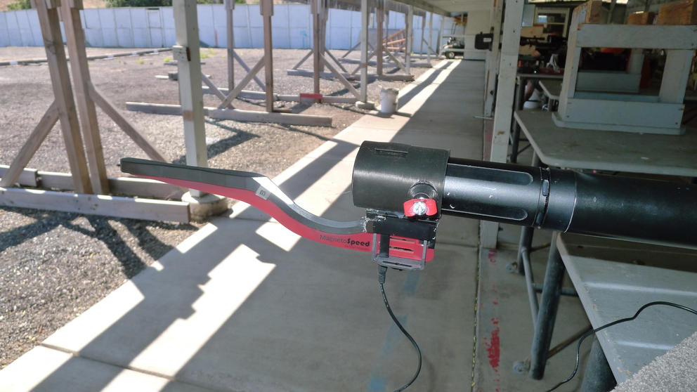

Magnetospeed V3 barrel mounted ballistic chronograph. I like this model because it has 11 sensitivity settings. I also tried the Magetospeed Sporter model which works great but only has 2 levels of sensitivity.
I now have an improved dovetail to picatinny adapter to mount my Cold Shot. The previous adapter was weak and cheap.
I replaced the stock hammer spring with a "medium strength" spring.
After shooting my 1st day with the new slugs, I'm still shooting 2 inch MOA at 200 yards and still splitting playing cards at 200 yards.
Very well thought out setup. Look like a Coldshot setup. your thoughts on the unit please. Tia.
I absolutely love the Cold Shot! I only wish I ordered the 300 MOA version. I have high hopes of shooting 1000+ yards when the Altaros 24 becomes available in the USA in about 6 months.
I like the idea of zero the scope once with the scope turrets, then never touch them again. All my shots are with using the center reticle and without any hold over. I use Strelok Pro for the dope and then simply dial in the Cold Shot.
With the 150 MOA Cold Shot and my current slugs and dope, I can shoot up to 750 yards without any hold over.
A 1000 yard shot is 254 MOA and the 300 MOA Cold Shot is still within limits and without holdover.
I hope this is helpful.

Yes, I have seen his vids. I like them. Especially the Texan vids. He also shot 800 yards with his .257. I asked him how he chrony his shots as he does not mention his chrony in his vids, but neve got back to me. I use a Magnetospeed chrony which reads 1020 fps at 3100 psi. Same slug
Reactions: RM.510bigbore
I think he uses one of those mini FX radar cronos. I use a LabRadar and also a Caldwell G2 in my shop. Both usually agree.

nice setup.. just a couple thoughts.. I have a Omega trail charger.. that I fill my guns with.. seems like you could go down to two tanks.. or if you have power there ought to be a way to have the compressor tether before the regulator and fill the tether tank even while you are shooting? I assume from the picture that you are running a regulator between the tank and gun..
I've also heard that they make booster pumps, I think they run off air and then you can basically empty one tank completely into the other one to keep it up to pressure.. but likely you have more knowledge about this than I do.. you sure put together a nice package..

HI Mark,
Thanks for chiming in. Yes, I shoot tethered.
I shoot at the Diablo Rod and Gun club in Concord, CA which fills club members air tanks. It's only when I shoot remotely do I need to bring an extra tank. I have never shot my Texan without being tethered, so I don't know how many shots just from the Texan tank. At my velocity, probably only around 6 shots.
Your Omega charger is great. However, there isn't a portable/12v compressor that will fill my tethered tanks. AS far as I know, they are only for filling the smaller rifle tanks. If I used something like your Omega, it would be constantly running and never topping off.

also it looked like you have a adjustment wheel on your scope mount for elevation.. so do you use it for changing elevation for distance? from your write-up I got the impression that you were able to use mil dot or something like that and didn't have to change settings..
you are way more advanced than I am.. I used to use a scope, but long range I didn't have enough adjustment to keep it in the view, so I used open sights.. then later on I couldn't hit anything with a scope and gave my scoped guns to my daughter.. recently she visited me and bought her 300 win mag to shoot distance ( I'd never want to try firing it..its blast is like a cannon and I didn't like even being 30 ft away and earplugs) but I tried looking through the scope and found 4 cross hairs 🤔🤔 so I put on my reading glasses and it went to one 🤣.. so maybe after I get glasses from the doctor, end of the month, well I might be able to use a scope again 😃..
just wondering how you changed between say 50 yards and 200 yards? or more? I know that people use ballistic calculator on the phone but I don't know anything about it, I don't even have a chronograph..
