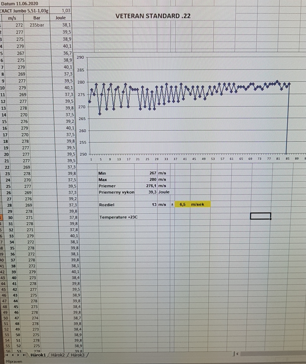

I have had similar bad experiences with the veteran right out of the box.
This string is with factory set of regulator
and this one is after tighten regulator for 5 dots!!!!
I have habbit from the cricket for deviation +-2ms not like shown me veteran at first!!
Also I suspect the pressure gauge is not correct and I have doubt isn't wika. I had already opened it and there is any label on side of manometer with sentence about information "pressure relief do not remove"
Its funny when I'm filling the gun and look on the gauge I see 200bars still filling gauge still shown 200bsr and suddenly is there 240bar....
