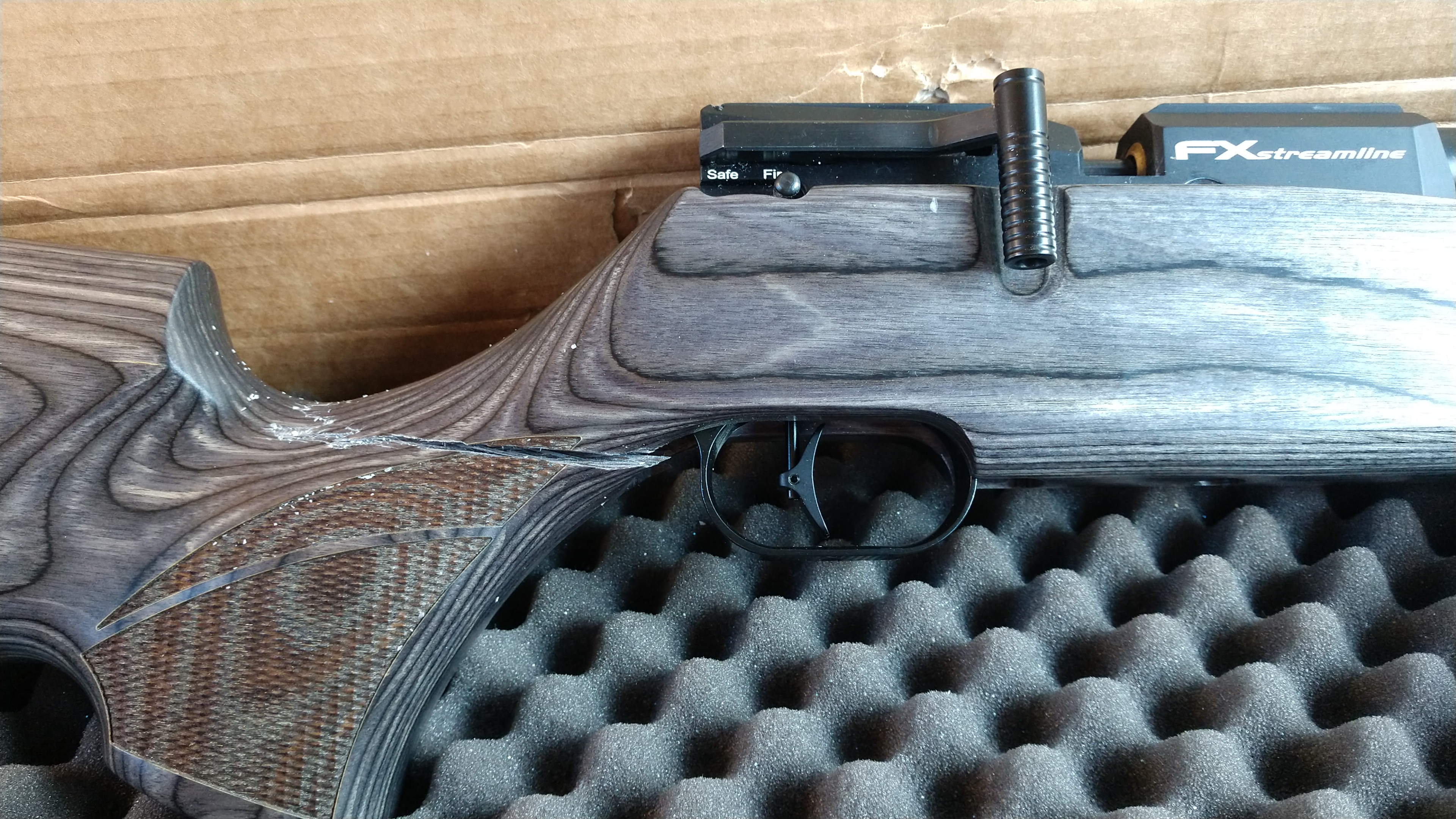

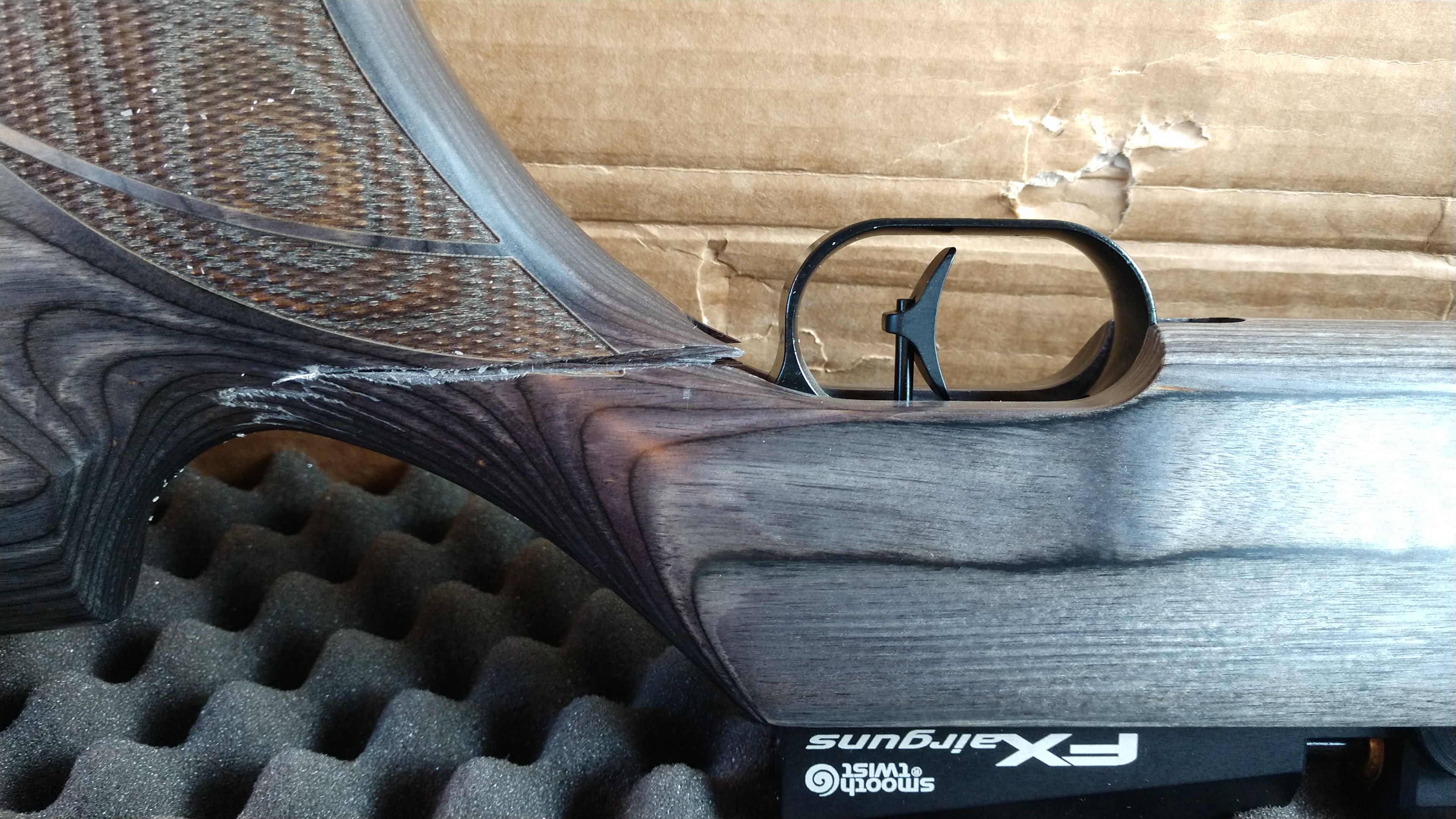

So jumping ahead to how that turned into a Wildcat. After the problem with the broken stock, Trevor from UA told me I could try it out with my synthetic 22 stock to see if it worked fine and they would just send me a new Laminate stock for it. Well, it held air just fine overnight and shot a nice group at 7 yards, but further shooting it the next day at longer distances revealed some issues. If it's possible for the regulator or some other internals to have received some shock damage when the stock was broken, I believe that is what happened. The rifle seemed to shoot at different power levels from low to high all on it's own. There were times when I shot maybe 5 to 10 shots from the same spot under the same conditions all back-to-back, and some shots were super quiet and felt like duds while others were very loud and felt like magnums. And there were shots that felt just right. It seemed that 50% of the shots were not right. To sum it up, the Str25 had a POI shift of about 6 inches vertically at 50 yards, which was enough evidence to me that it was shooting at different levels of power/velocity. And the shot count was only 31 on high power from a full charge, well below what it should get before falling off the regulator. And lastly, the manometer was not reading correctly.

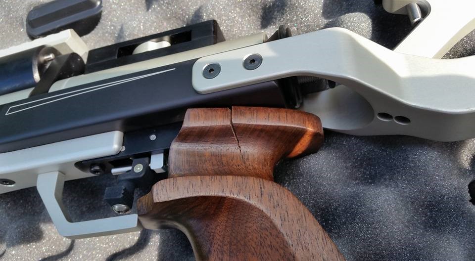

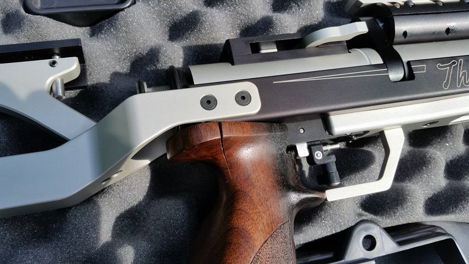

So after all this, I knew that the Str25 would go back to UA. But through this experience, I just didn't feel that I would be comfortable with a direct replacement, even though my Str22 has been perfect, I just didn't want another one. When asked if I could choose a different model and either pay the difference if more expensive or do a straight swap if the same price, UA told me that I could. What I really wanted was a Bobcat, but I already pushed my funding limits by going with the higher priced laminate Streamline, so being the WC MKII was the same price and they were now in stock, I decided to go with one of those.
