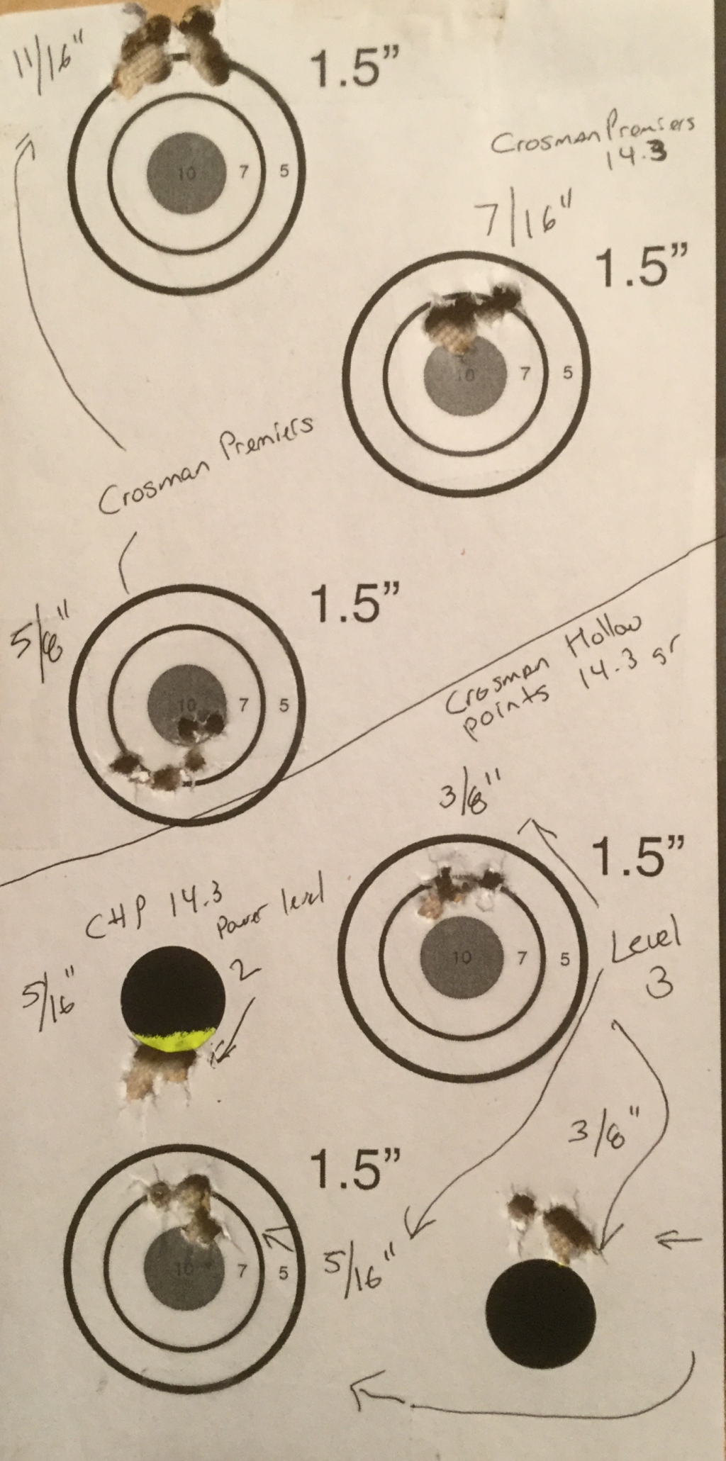

Some quickly sent groups at 25 yards with Crosman Premiers (domes and HPs). I was playing with the transfer port settings...
1569582551_17931013735d8dedd71fe172.17325248_2350C528-6EC6-4F25-BF16-D7A7B69583B4.jpeg
About the power levels (transfer port adjustment) on my .22 Compatto the difference in energy levels between the “3” positions was not enough on low to allow safe indoor pesting. On the Bantam HR at level 1 (13 FPE) with Crosman Premier HPs I’m taking out sparrows in a barn from 15-25 yards. You know I’m getting pass thrus, but there are no holes through the roof. Being able to go from a 50 yard shot to one at 15 yards by simply turning a wheel is awesome.
