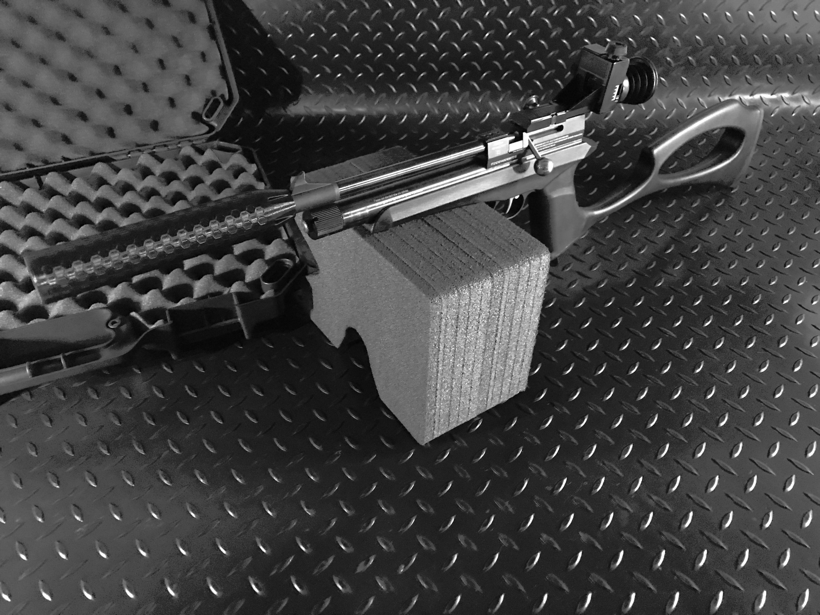

i don't know about the bullpup, but this is what i'm using at the moment for my chaser. inexpensive and works. no adapters required. better than the stock version.

My first pcp, a Stoeger bull pup which is a Snowpeak P 35 in a different stock. I thought I might try the moderator on my Diana Chaser on the bull pup but it would require a smaller adaptor. Both rifles are in .22 caliber. Any suggestions would be appreciated. Thanks.
Donny FL can supply a 1/2 UNF adaptor. I recommend their FAT BOY suppressor with the .22/25 insert.

It's probably a metric thread and you can probably buy a moderator to fit the threads you have. But you don't really need a moderator. Another guy who just got one says it has baffles and I presume they are thin aluminum pieces like my P35 has. It should be 90+ db as is and you can drop it into the low to mid 80s with a couple hair curlers and some plastic felt. I got the curlers from the dollar store, about $1.25, and the felt from hobby lobby - 33 cents a piece. I is enough but I'd get two at that price. But a baffle up against the bright aluminum piece in the shroud with half a curler wrapped in felt inside, then a full curler with a baffle on it, then a third baffle up against the end cap. The last baffle may have an O-ring. If it does, it's best to either remove the O-ring or put it back against the end cap. Otherwise it can get into the pellet path.
