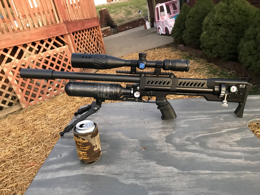

My new Fully Auto LCS Air Arms SK19
I have a SK19, in 22cal ordered, but no conformation yet. I also have a Huben and I like it. It will do weird things when/if you let it get low on air, and it's pretty easy to do with the 19 shot mag, and a rather small air tube instead of a bottle. I've noticed on some of the videos of the SK19 on full auto, it sounds like it gets low on air rather quickly. You can hear it slowing down. I'm sure it is almost exactly like the Huben, and it takes a little while to figure out the adjustments of the regulator, and power wheel. Once dialed in, it works great, and is accurate, but requires some tuning when changing types and weights of ammo.And you'd better have a compressor, cause they love air and ammo!😁

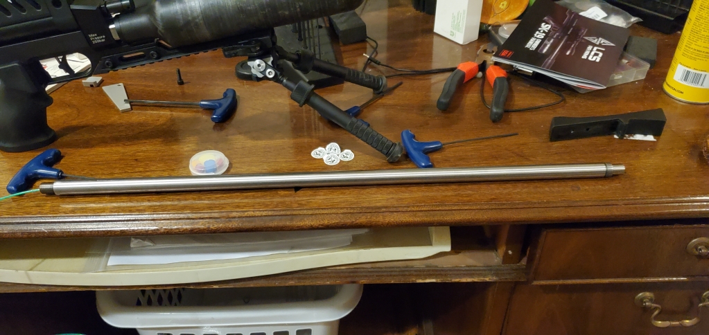

I just want to add to the convo. The barrel is threaded as Michael has said with two 4mm screws clamping down on the barrel toward the middle of the rifle. The barrel then just unscrews off. Just make sure when you are tightening it back down that you do not overtighten because then the barrel will seat itself too far into the fixed magazine and prevent rotation. Plus if you overtighten you won't be able to unscrew the barrel back out. Righty righty until it stops then back it out a quarter of a turn.

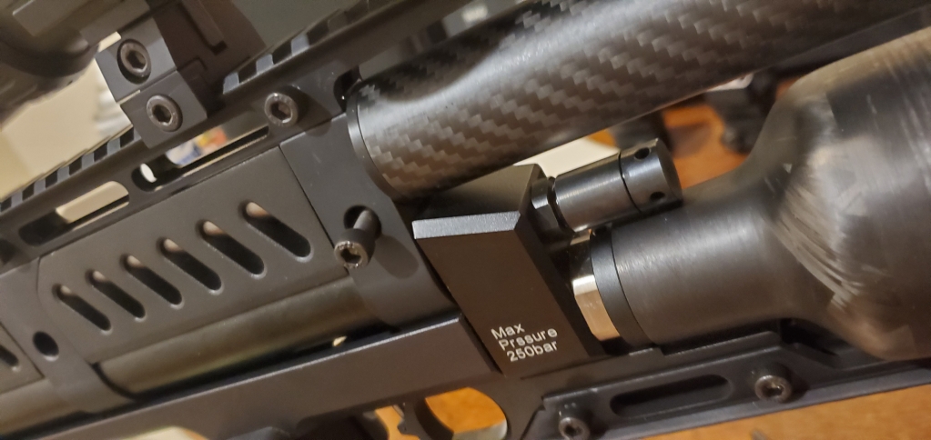

My brother in law split the cost for the .22 SK-19 from Air gun of Arizona with the 580cc upgrade bottle . We were not happy with the scratches on the bottle stem due to the 580cc larger diameter stem that hit the regulator preventing any adjustment if needed or other damage that occurred. Contacted AGA and presently RA-ed the gun for a new gun with the stock 480cc stock bottle . We will see if the gun arrives with a new higher serial number and is free from defects. Darren at AGA was very service friendly and assured us we would be taken care of. Will post a follow up.

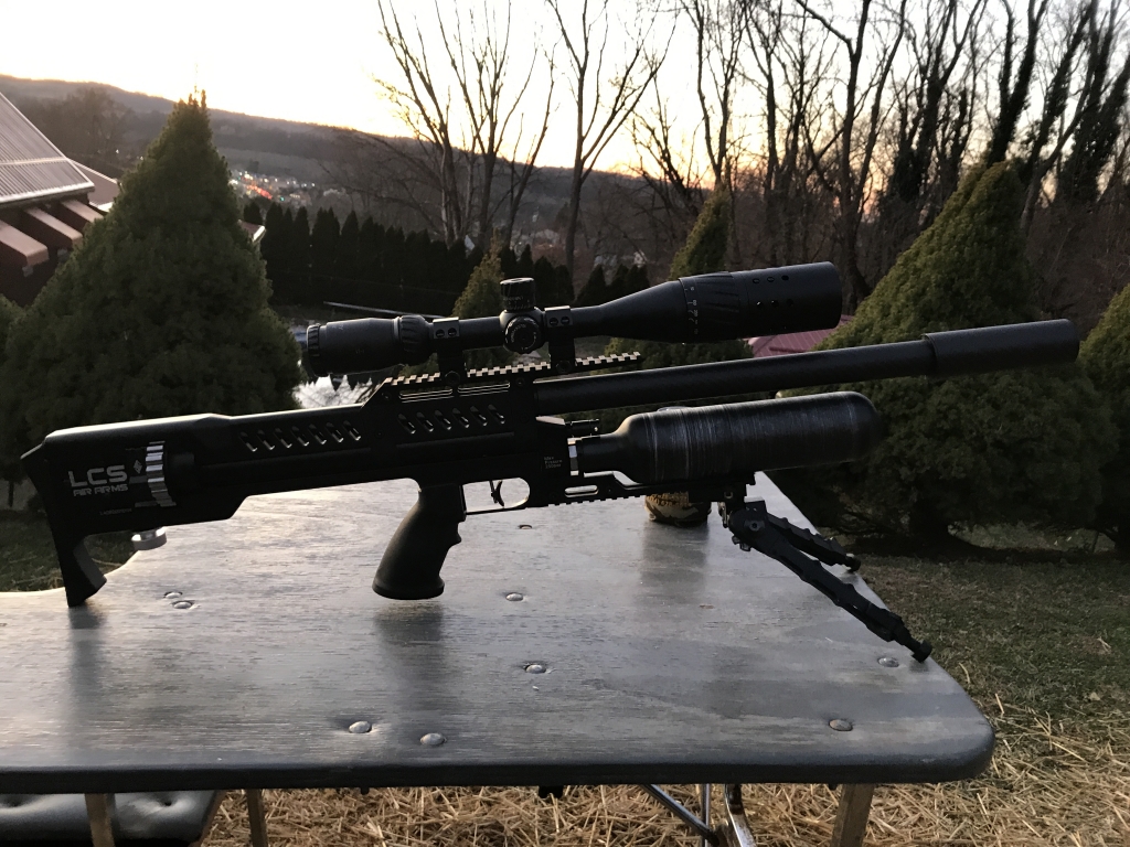

Hi there my fellow airgunners,
