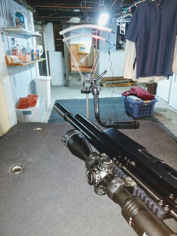

I recently bought s Competition Electronics Pro Chrono DLX. It is Blue Tooth compatible and I downloaded their free app to my phone. I use my phone as s GPS also and had set the voice to a woman with a British accent. So now when I shoot she announces the speed of each shot. I just think this is so cool.
