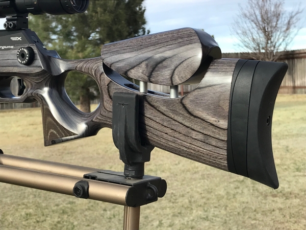

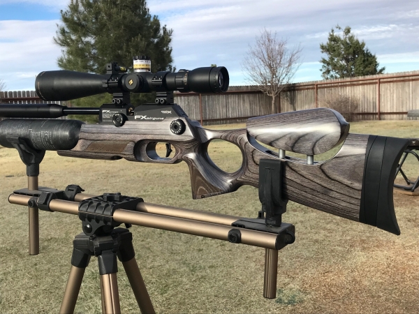

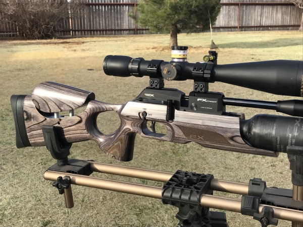

Just got my new Crown from Precision Wednesday, I wasn't sure what the Pepper laminate was going to look like up close but I really like it. I like the semi-gloss finish as well. I just had time to mount the scope using some Sport Match adjustable rings. Got home yesterday from work, pulled the barrel liner and gave it a good cleaning. It actually had quite a bit of lead specs on the first patch so apparently it had be tested with quite a few pellets. The regulator is set at 125bar according to the gauge but it could be off some. I'll have to check it soon. As set, it was shooting the 25.4's at 945fps and the Heavy MKII's at 825fps. I really want to shoot the Heavies so my plans are to increase the regulator around 140bar and see where that gets me. From that velocity I'll probably back off the HS adjuster one notch as uncle Ted advised and see how it does there.
Now the bad news..... I had just mounted the scope and then turned the gun over to look at the gauges and the cheek riser fell out and hit the cement floor dinging it on two edges. It was pushed all the way down when shipped so I had no idea that it was still loose enough to fall out. Almost made me cry, but a few bad words came out instead.. Anyway here are a couple of photos.

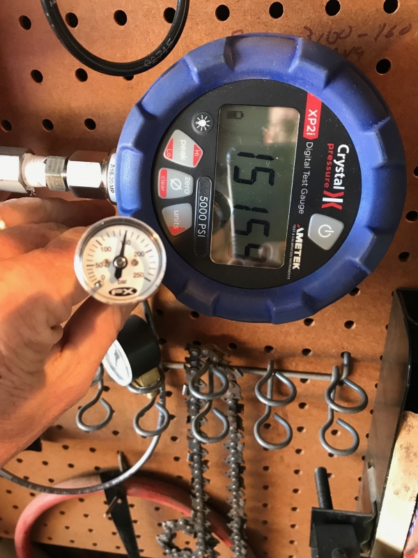

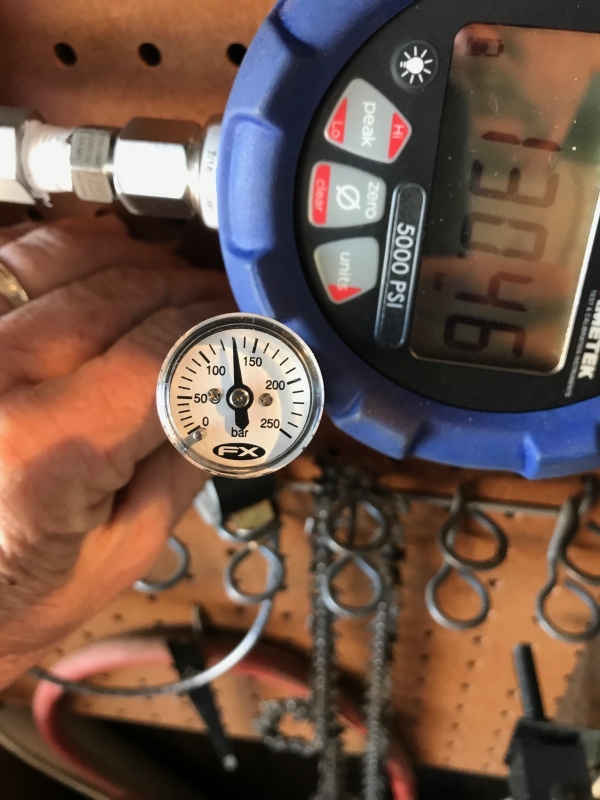

Thanks guys, I had some doubts about the regulated pressure gauge since the gun seemed pretty capable of making good power at 135bar. I pulled the gauge today and checked it against my good test gauge which has .1% accuracy for that range. Fortunately it's right on the money at 150 and 130bar. The high pressure gauge is off about 5bar which I'd still call a keeper. If anyone would like me to check theirs just send it to me.
