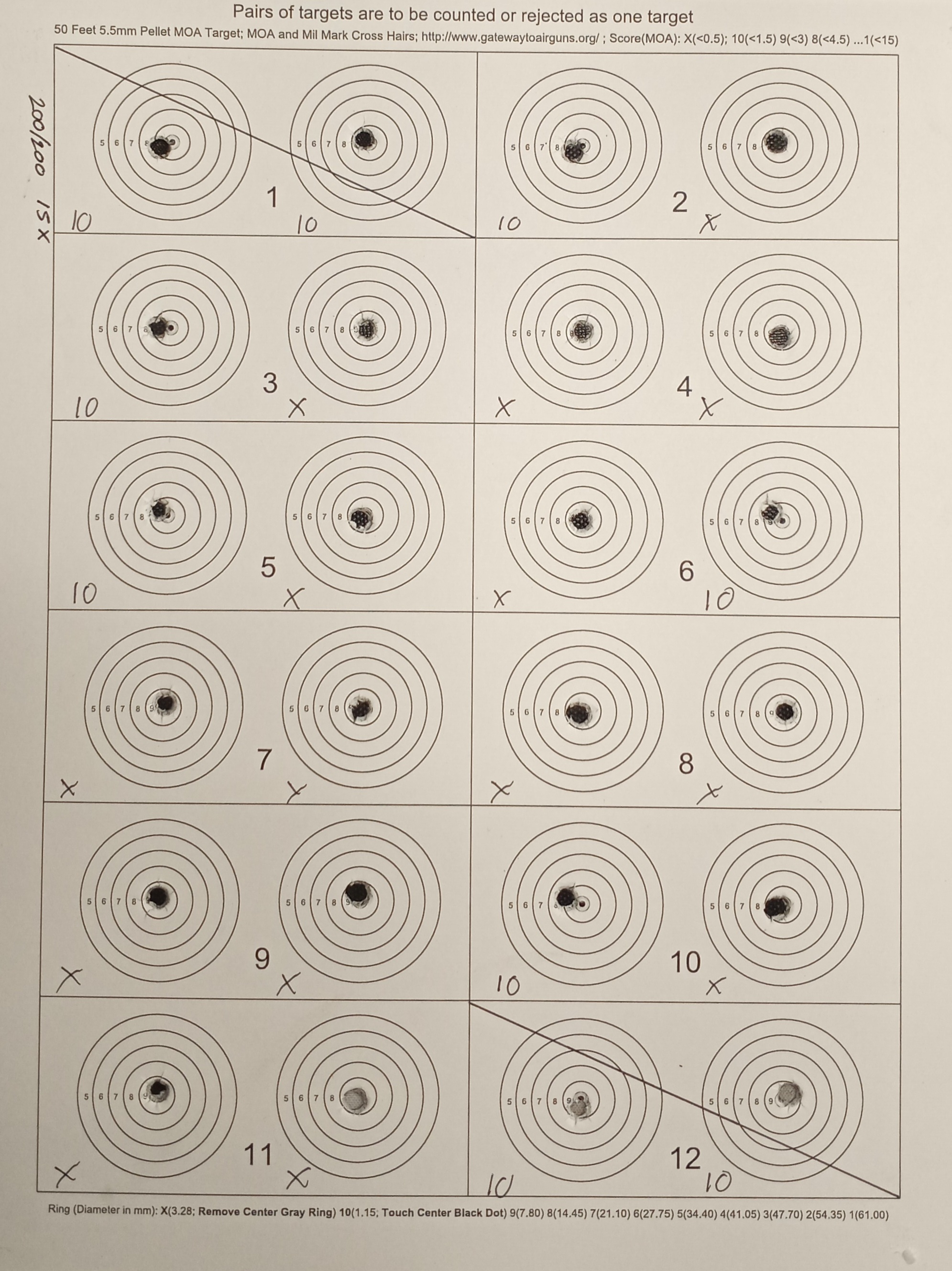

Airacuda accuracy? Just fine as far as I am concerned. Crosman Premier Hollow Points, THE cheapest pellet in existence today, 200/200 score.
Yes, it's 10m but it's also -20°F outside rightnow so inside range for now.
