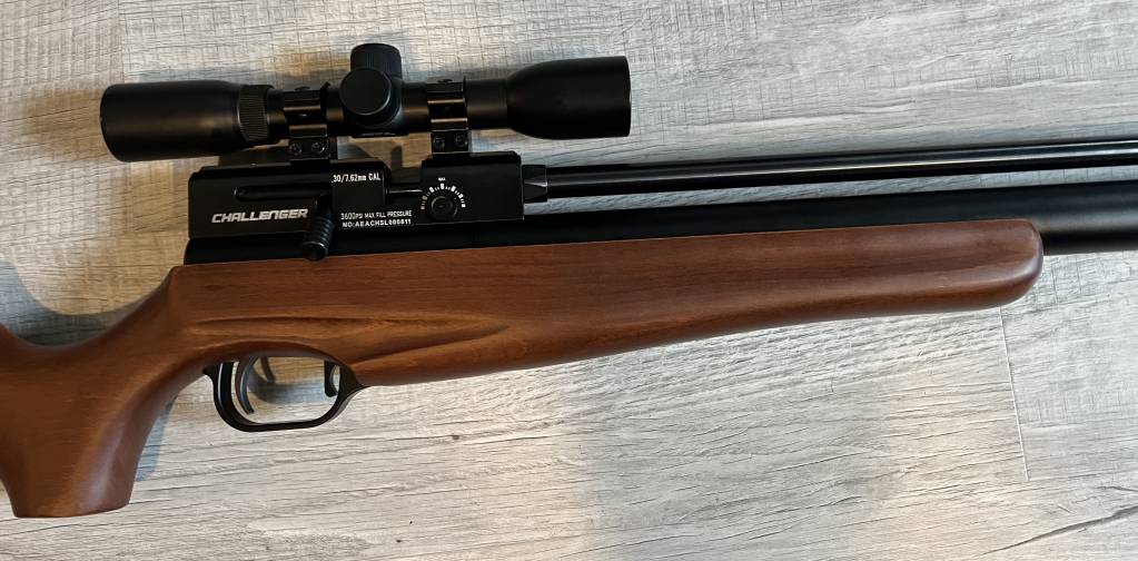

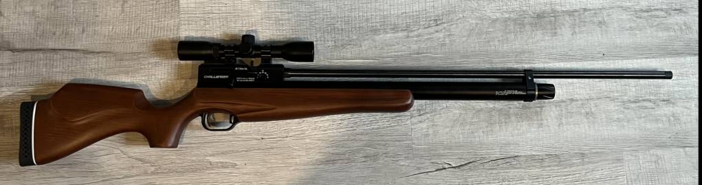

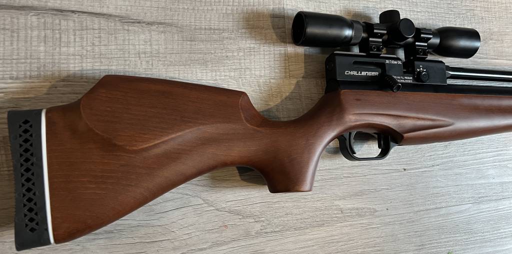

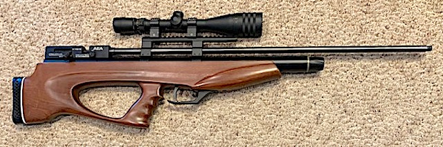

My New AEA Challenger .30 Special Edition

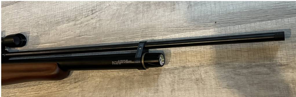

I just received it a few days ago. I put on a Bison barrel band. Center point 4x32 scope. Build quality seems decent for the price. I have several slugs and some pellets to try out. I initially filled it at 3200 psi with 75% power and the 44gr pellets broke the sound barrier. I will chronograph each slug and pellet next to see how it does at different pressures. So far so good!

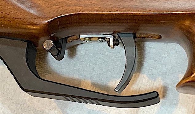

I've written more than once that simple trigger designs respond well to simple trigger-smithing techniques, and the Challenger trigger is a good example. Once I'd done the usual replacement of the trigger and/or sear return spring(s) with as light as I feel maintains safe function, I moly-lubed all trigger and sear pivot and engagement surfaces (anything in the trigger/sear mechanism that rubs).
Those things helped a lot, and reduced the let-off to 3-4 pounds. But at that point I felt adding a sear-engagement screw would get me closer to a competition-worthy trigger action. So I fashioned a sear-engagement adjusting screw that attaches to the stock just in front of the trigger blade; the adjusting screw simply limiting how far the trigger blade can return forward. Now by adjusting the sear-engagement to one side or the other of what I can get away with, the trigger let-off comes in between 2 and 3 pounds. It seems 2-1/2 pounds is enough that it doesn't start slipping out of engagement after dozens to hundreds of shots. But when/if I remove and reinstall the stock, I'll usually have to fine-tune the adjustment a little.
