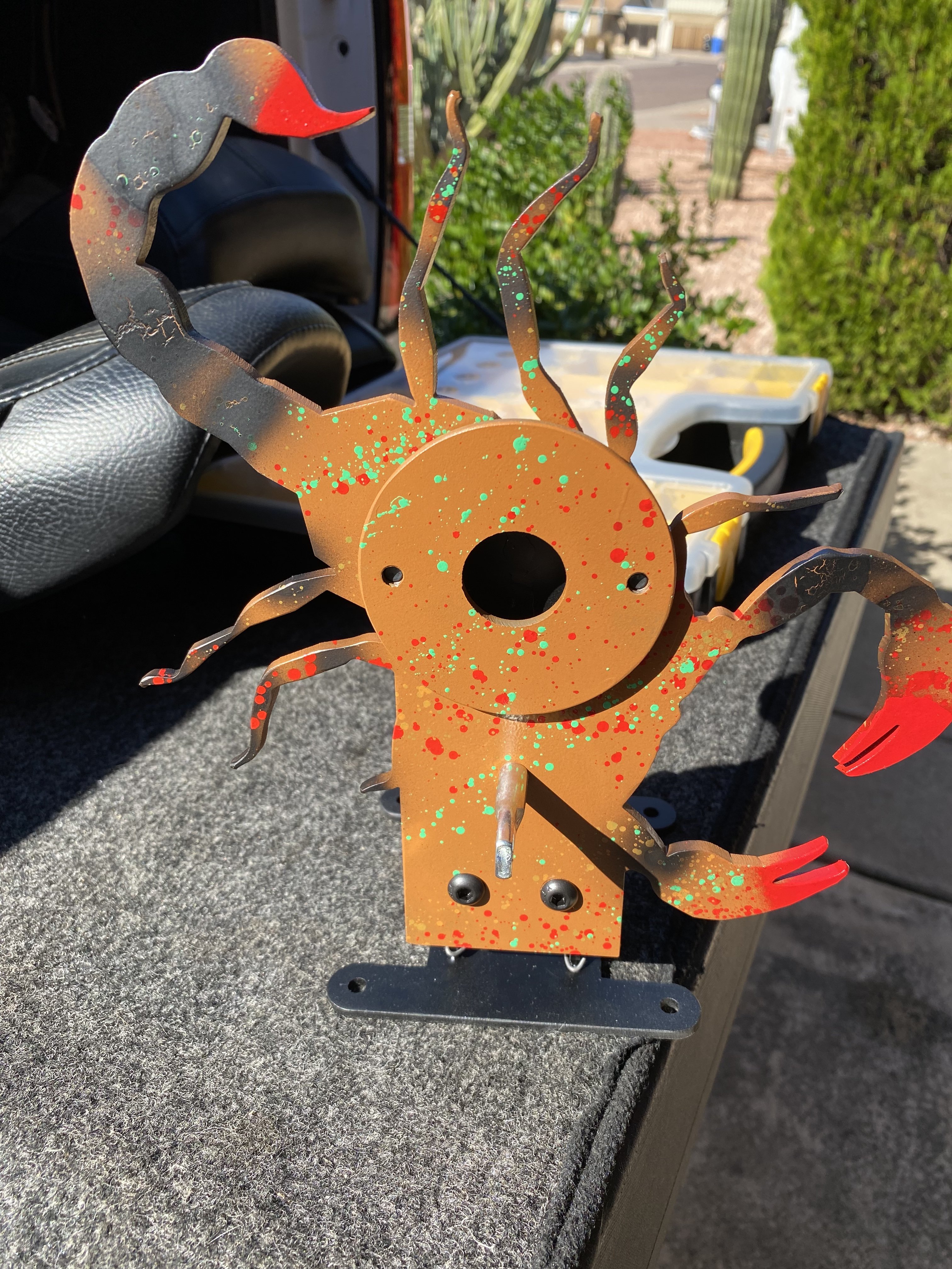

My new .177 Field Target Design
Another Scorpion target going out to a new home.

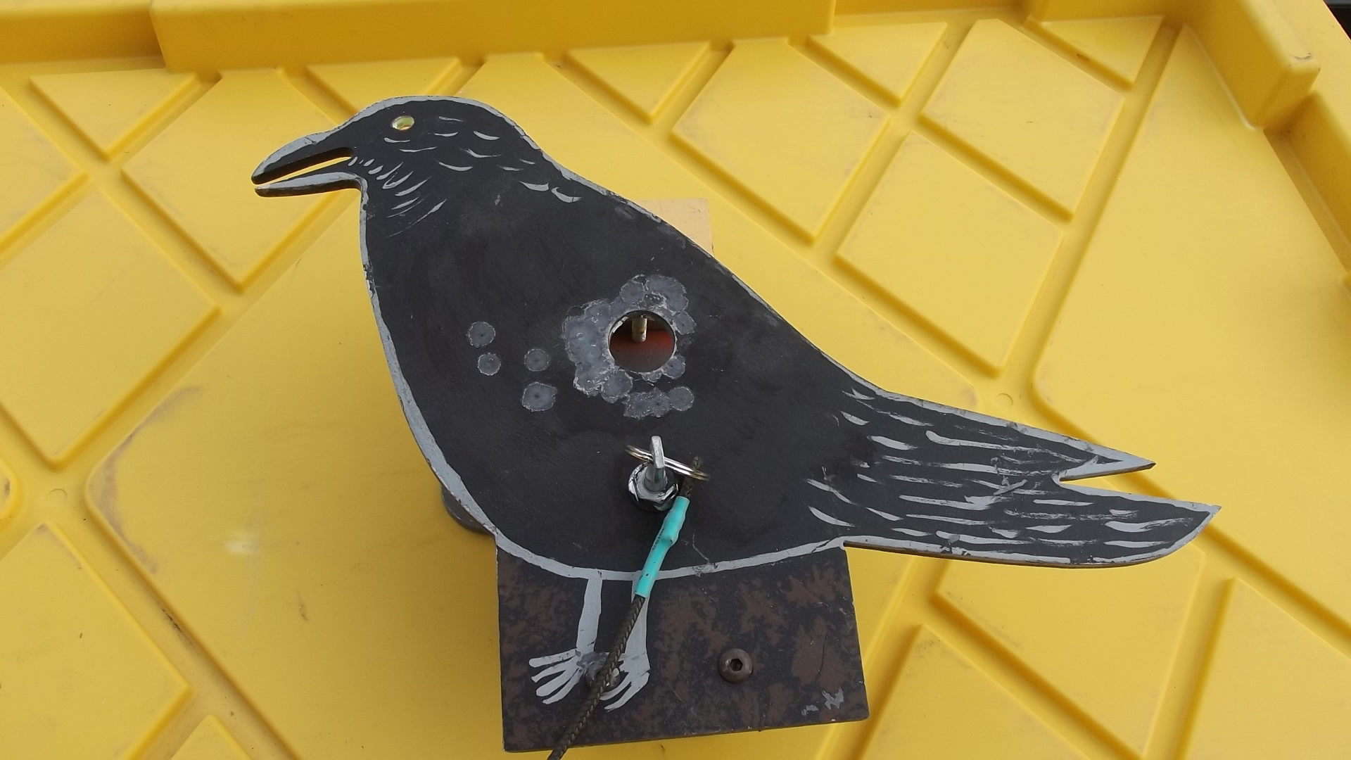

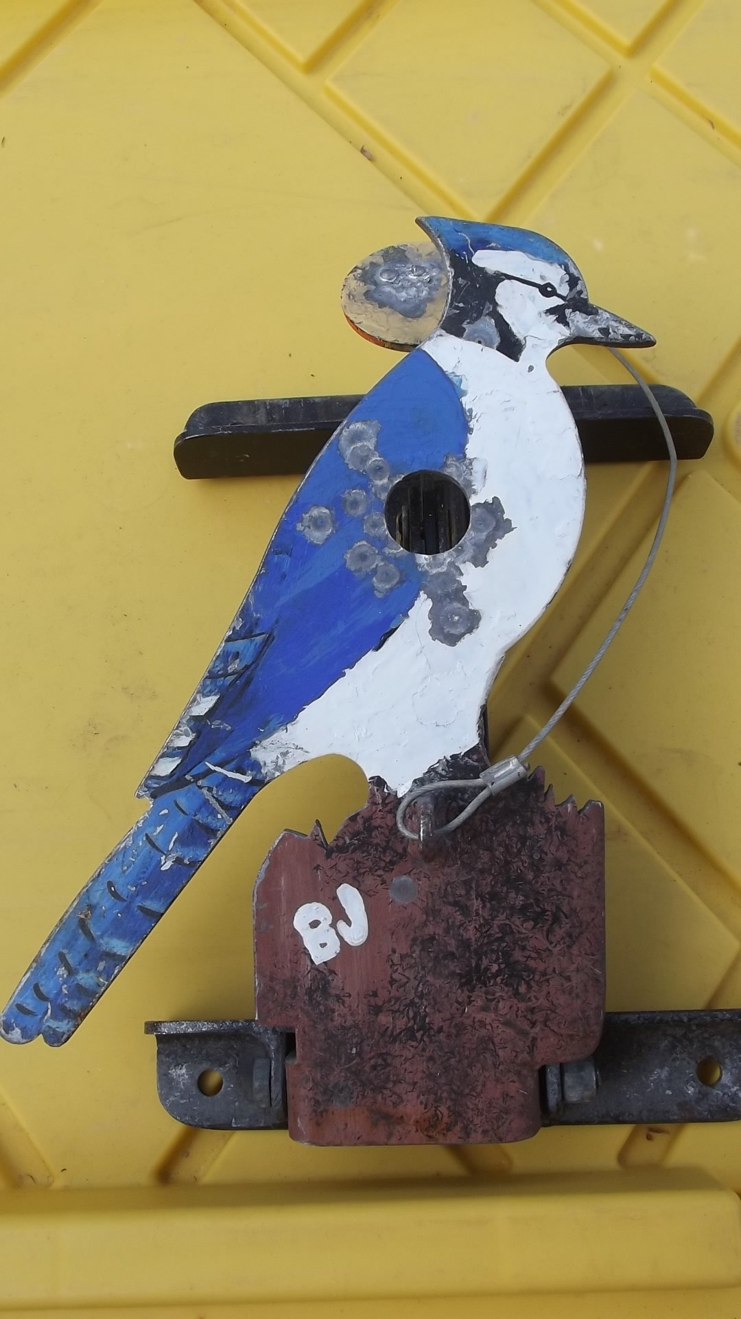

Only issue with snazzy targets is they end up looking like this after 1 match.
The repaint crew has there work cut out if repainting monthly .. ask me how i know LOL !!

I sure am not an artist. Usually the reducers take most of the hits

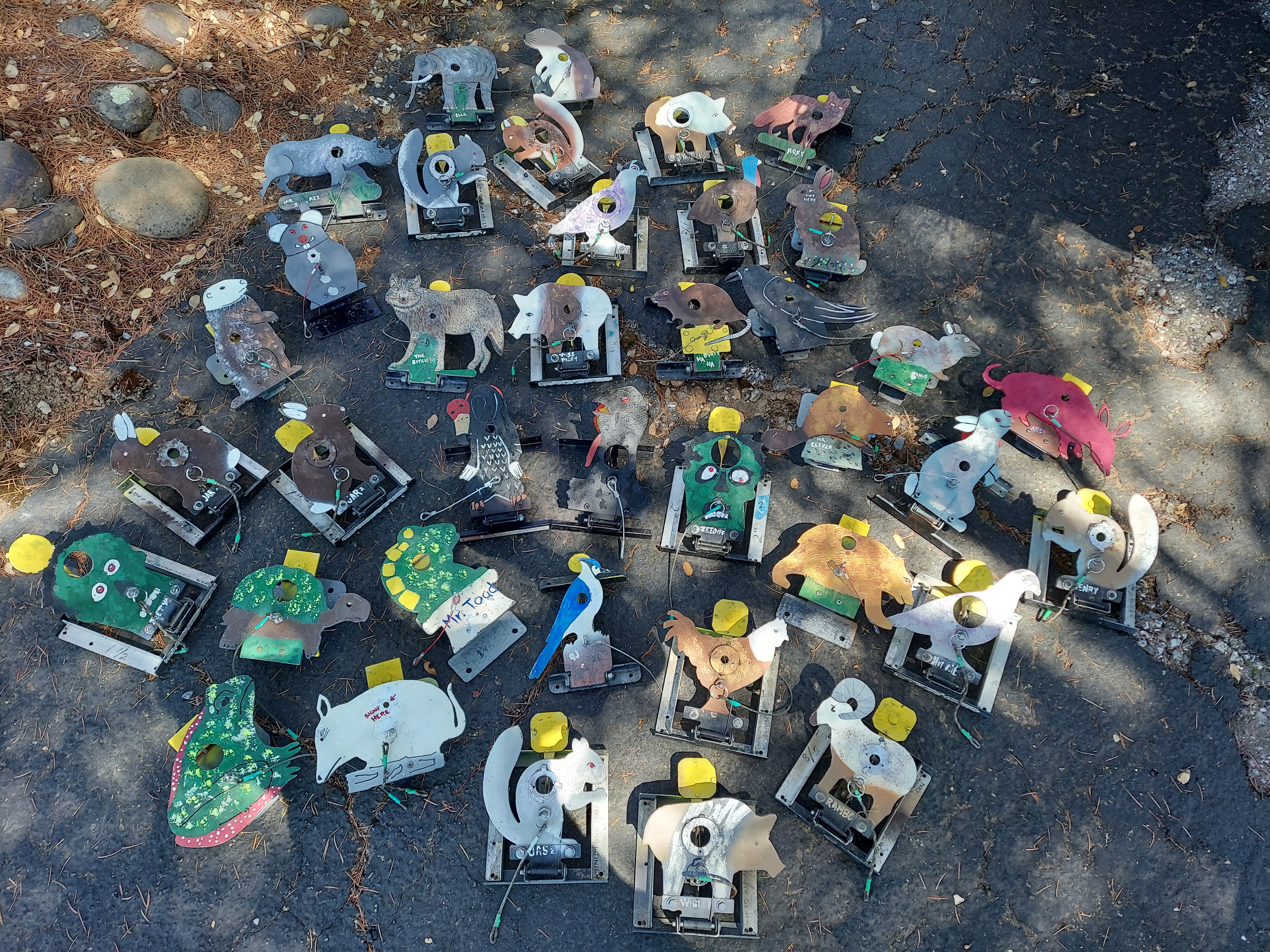

In the SVFTC we're slowly weeding out the older KZ reducer/s type targets. patterns tho vary greatly and all get the snot beat out of them monthly !! here about 2/3rds of our invertory

To get us back on topic though....we've been banging away on @Sturkis targets for a couple years now in Xtreme Field Target and they've withstood all of it like champs. And that's up to 100fpe. These are the same design, just smaller profile. Amazing targets that'll outlive the owner.
We have been using reducers for 2 years for the Xtreme matches and haven’t lost a reducer yet. We even shoot them with rimfire. In looking at your inventory there are a lot of Gamo targets in there. They will taco and have reducers damaged with a Red Rider. In the day they were probably sufficient. With the newer PCP’s the technology has evolved and so must the targets.

The Rhynos & Copies, Target art and some unknowns are becoming our primary sets.

They do get beat up. That’s why I use AR on the paddles and the reducers are only $10 to replace. But usually you can just turn it over and it’s like new.
