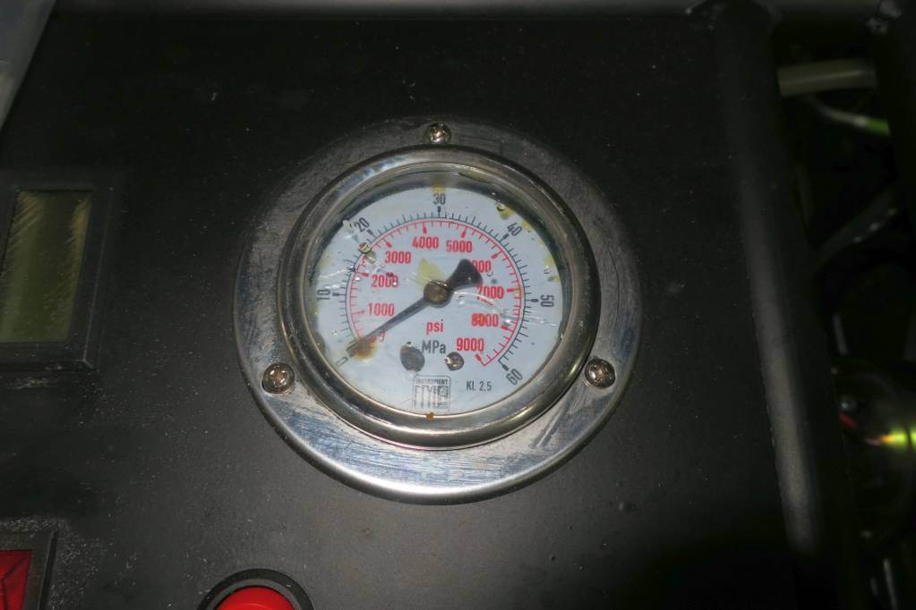

One of the units I received had lost the plug in its gauge, and therefore all of its glycerine needle damping fill. It was rusting and corroded inside, and couldn't be considered functional:
Panel mount analog gauges of the seemingly correct diameter were available for +/- $25 on eBay from a U.S. seller, and were available in a more reasonable full scale of 0-5,000 or 0-7,500 psi. I bought one and it worked, although it didn't fit into the (metric?) hole in the compressor lid, so it stood about 3/16" above the metal instead of fitting nice and flush.

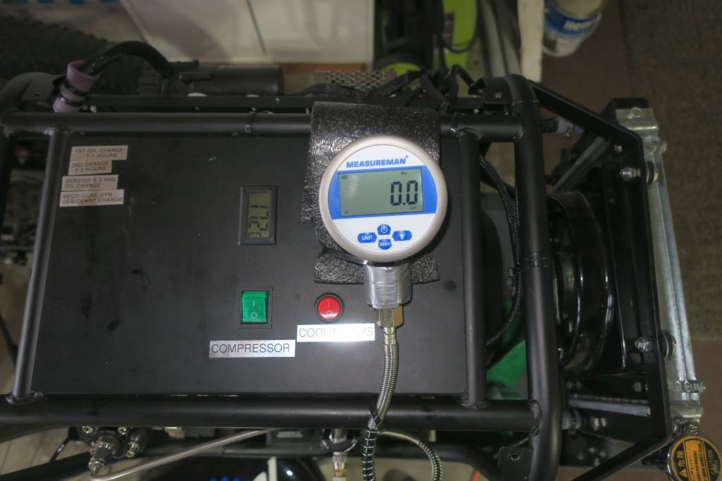

I then thought about maybe looking at digital 3" direct replacement gauges. None I could find were flush panel mounts with back inlets, so I just got one with a bottom inlet (1/4" NPT) for proof-of-concept. It cost me just under $100, and was soft mounted on the compressor for function testing:
I really liked how this worked as it really showed the progress of the pumping operation, and whether it had stalled (like if the bleeder valve was not completely closed). Clear to read, and accurate from what I could tell. (I assume that the electronic gauges on my Daystate rifles are likely the most accurate gauges I have, so I check any pressure gauge against at least 2 Daystates). Digital gauge appeared to be within 1-2 bar of the Daystate readings. Without sending it out to a test/certification lab, this was the best I had.

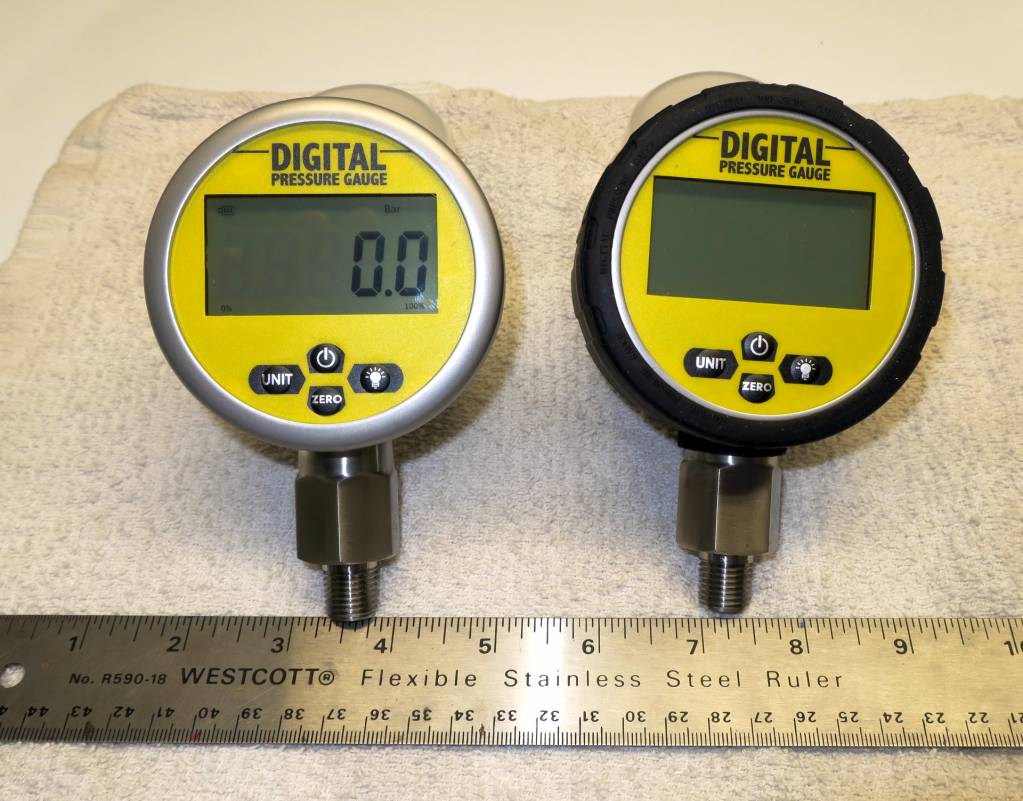

They are full scale 0-400 bar, and I received them today, exactly 21 days after I placed the order. One reason I went with these was that they had the needed 1/4" NPT thread on the gauge (others seemed like they shipped with thread adapters), they were of the best full scale range for my use, and they were available at a reasonable price.
They arrived well packaged, both functioning, in good shape and wearing thin rubber covers (which won't provide much protection, but since the covers are so thin they are easy to remove for battery replacement):
It is nice that these gauges are very easily readable, and if you have a gun which fills to psi, you can set them for that unit with the quick press of a button.

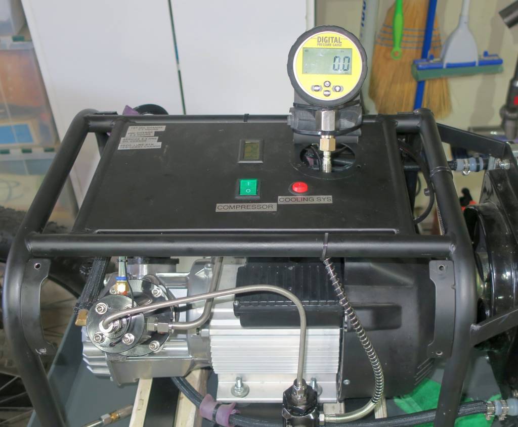

I just bent a little piece of sheet metal and mounted it using one of the existing holes for the analog gauge on top of my compressor. The gauge is soft mounted to the back plate with a couple of zip ties, since it will need to be removed periodically for battery replacement.

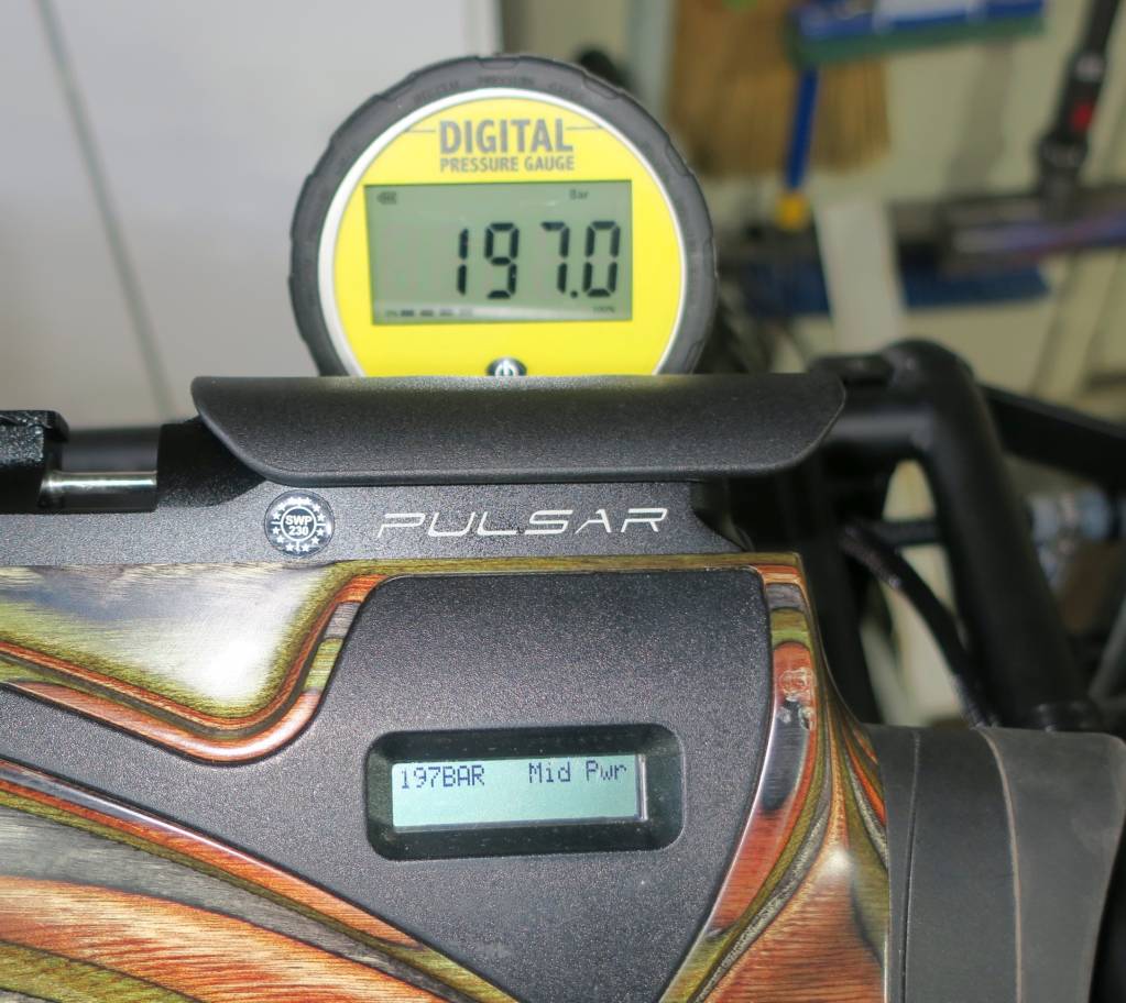

I tested it with a Pulsar, and if anything it reads up to 1 bar under what the gun reads, which if it has to be off, that is what I would want.
