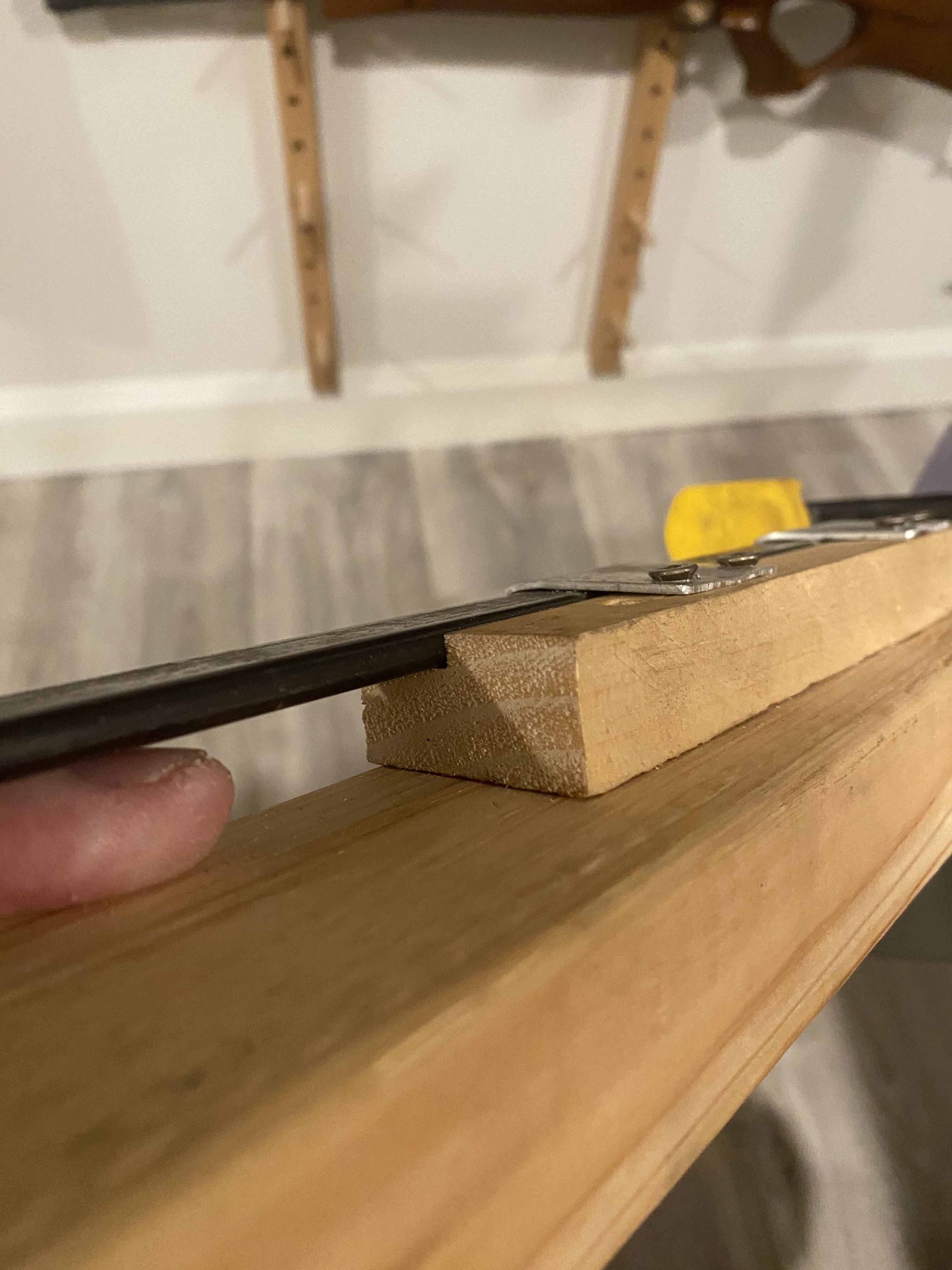

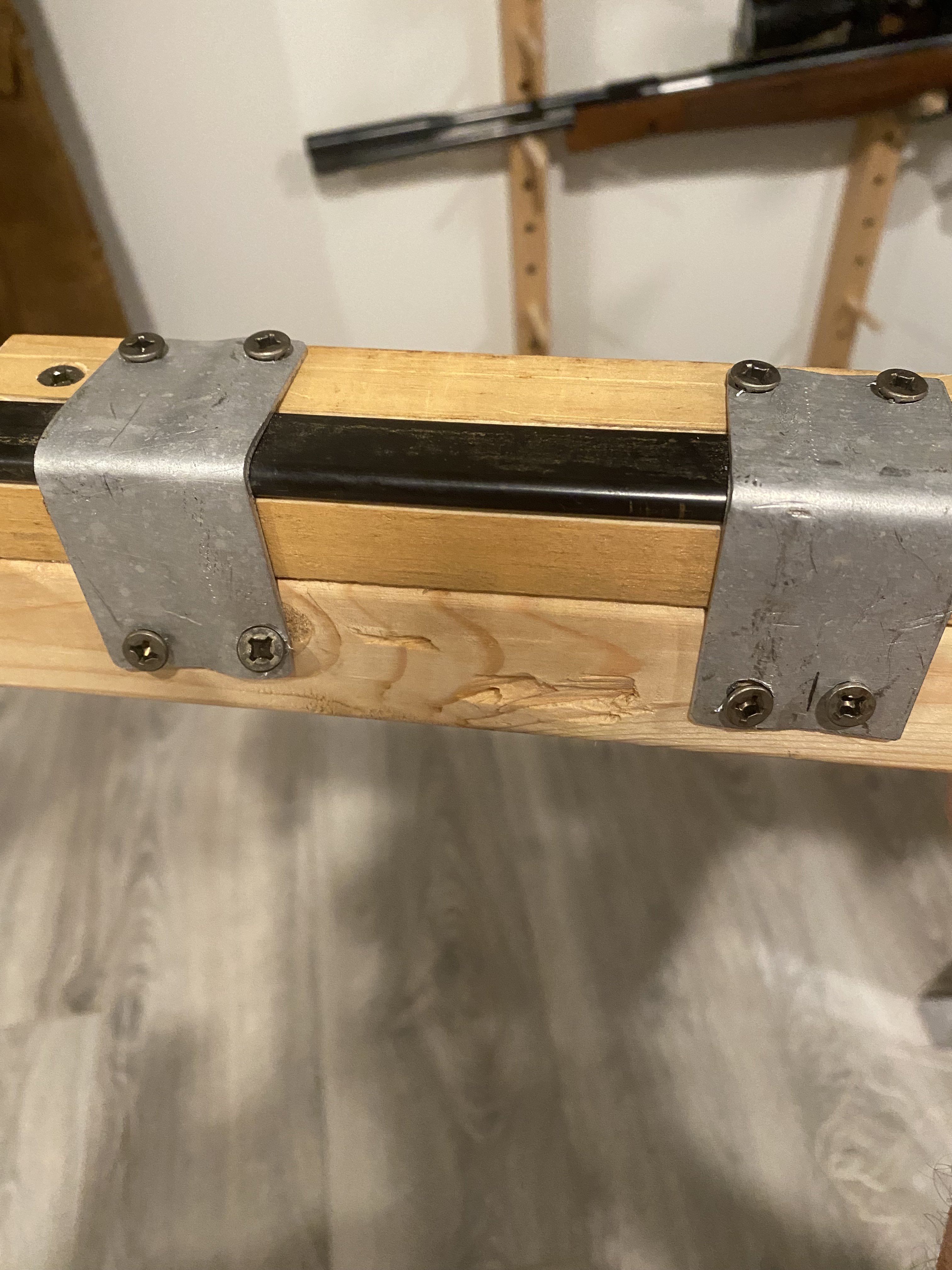

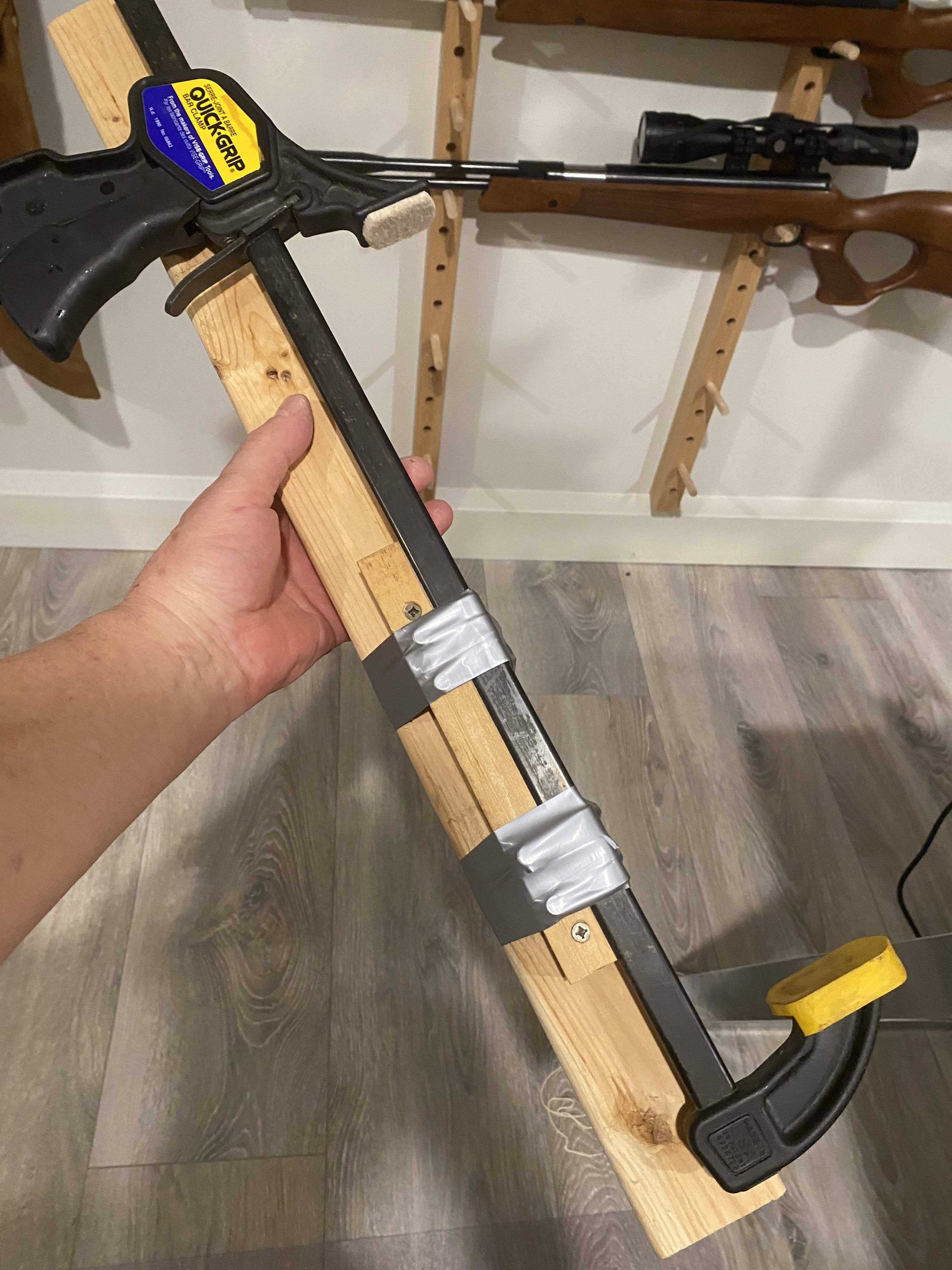

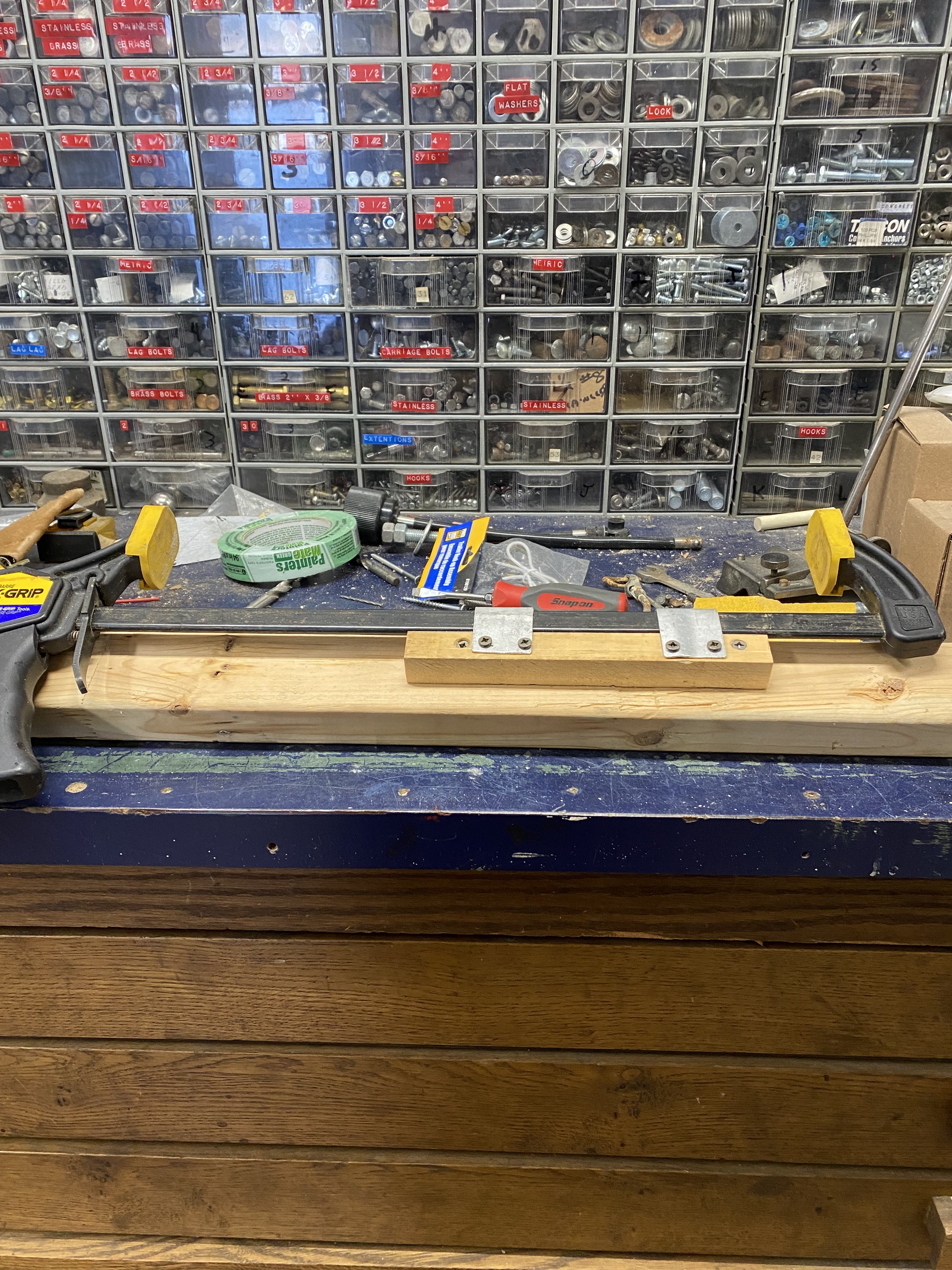

I went to go go shooting and I remembered this project. I went down and made from scrap, minus the clamp. 1/2 an hour to make. Nothing to brag about, but it’s going to work better than what I had. I would of rather had 4-5 tins of lead instead of the press.
I notched 1 x 2 x 12 inches to seat the bar in. 975FAB30-4275-4BA9-9363-046C167B60BB.jpegAttached it to a 2 foot piece of 2 x 3 to allow the clamp to travel, attached 2 metal straps stretching them by forcing the screws to pull. 0D070C3B-FA1F-4FFB-A510-F5E216A3EB84.jpeg

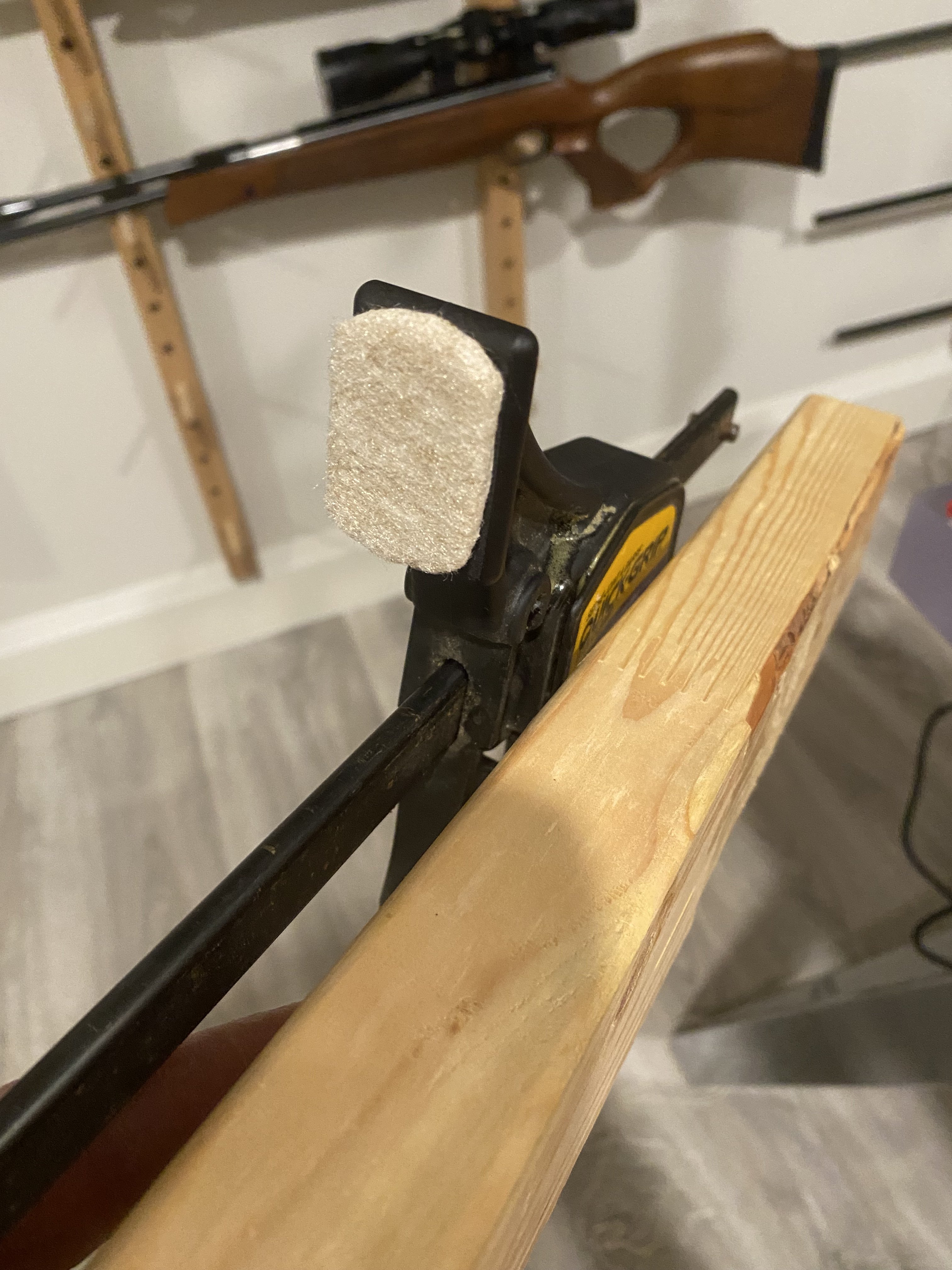

The one end has rubber. On clamp end I removed rubber and put felt for under your furniture. 4DC719C0-F70A-4D2B-985C-68427914A4DE.jpeg
A little tape around the plates and screws. Done 036D4F36-0142-4FA1-A25B-D9BCC910DA8F.jpeg
I’m going to look for something I can attach to where the felt is a small disc that spins. Crow

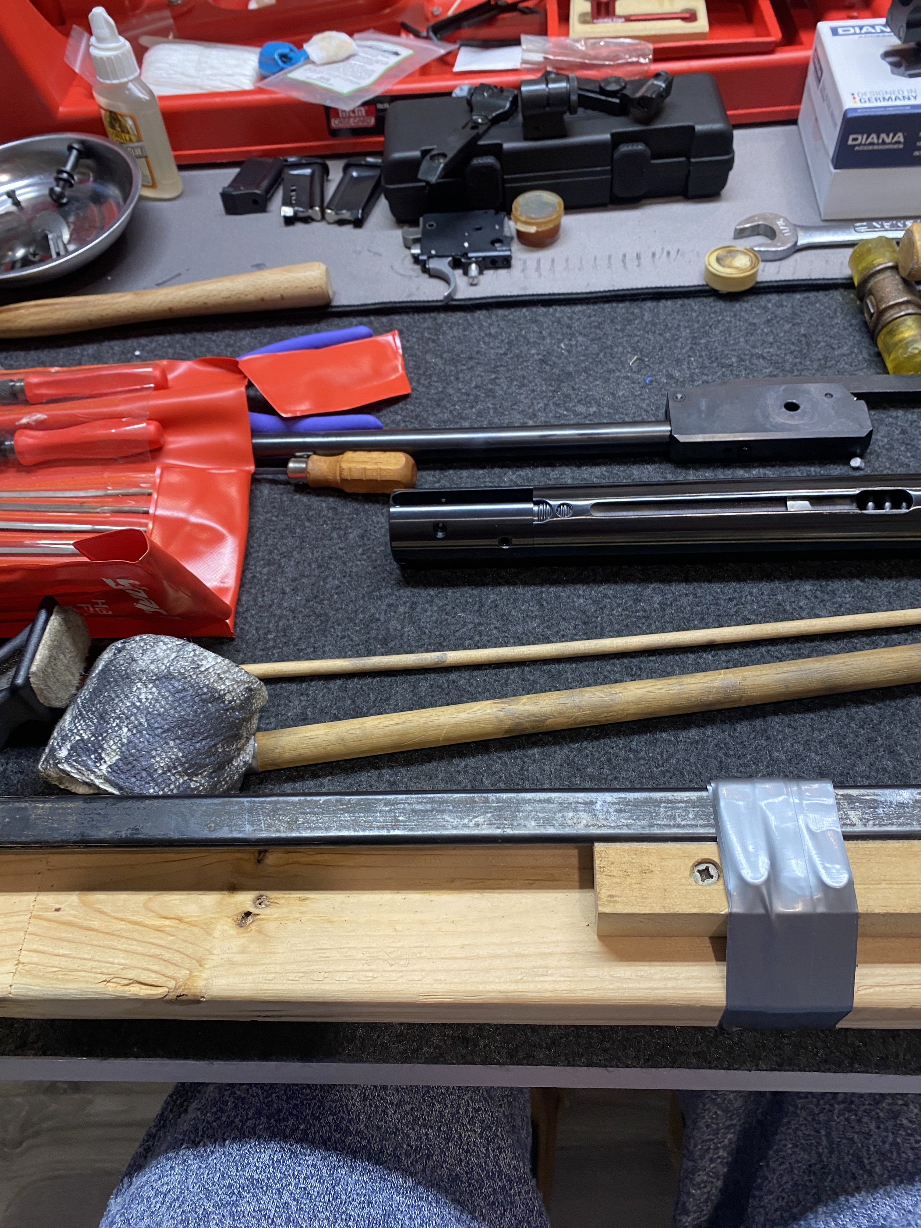

Sorry about the mess

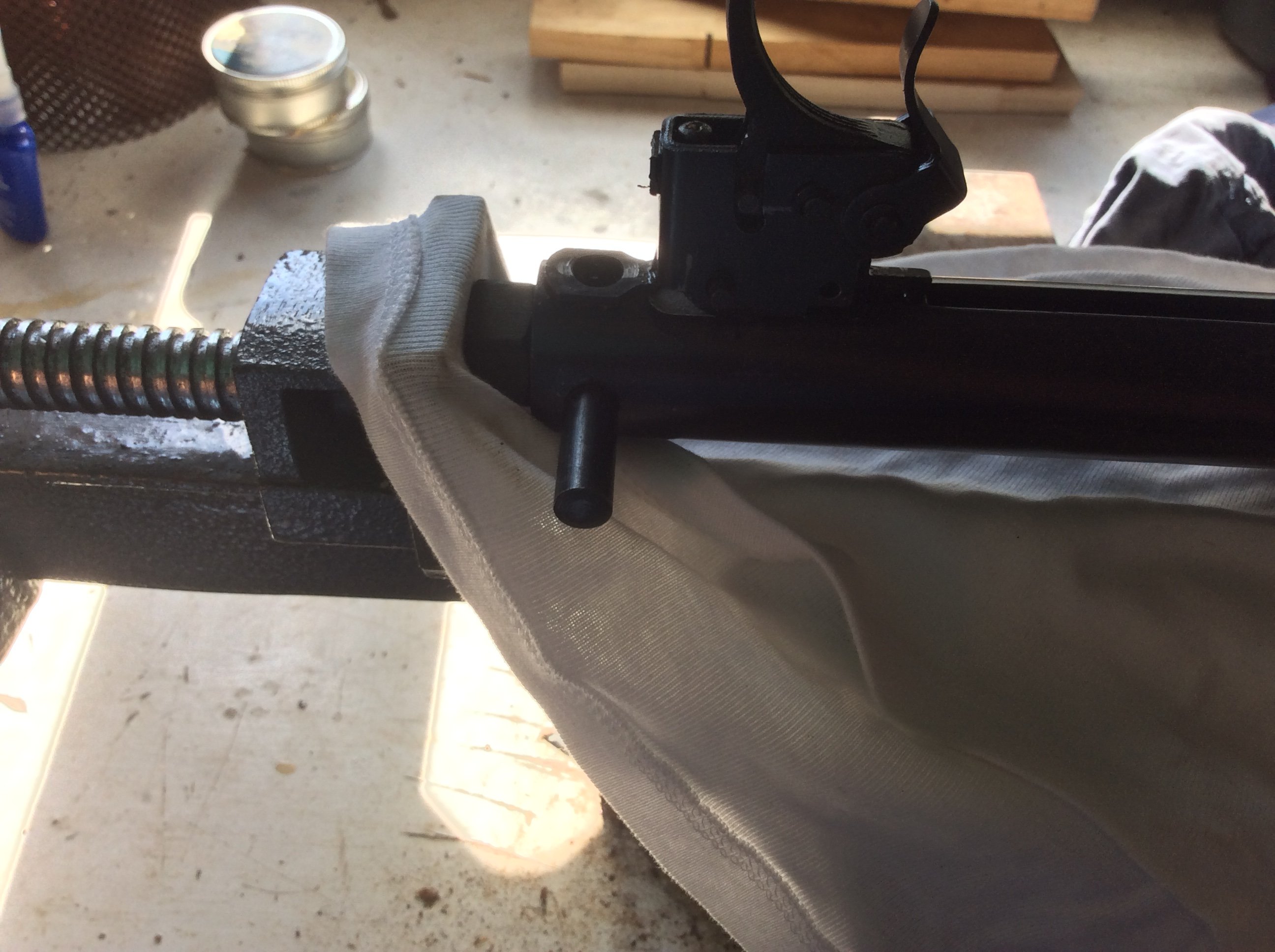

Awww Crow! Didn't I tell you earlier in the thread to make sure that you put the barrel on before putting the cylinder back together? The pivot bolt will now be under spring tension from the mainspring and or detent. You're going to have a very difficult time getting the pivot bolt aligned and started without damaging the shims, bolt and receiver threads. IMO your better off removing the mainspring then installing the barrel and then reinstalling the mainspring.
Sorry to be the bearer of bad news.
PM me for my phone number if you'd like further verbal assistance.

Hmmmm.. dont guess ive had issue with that .... yet. Lines up pretty dead on use a lineup pin to center the shims then the pivot bolt should go in. Also remove the breach seal will help relax pressure between the reciver and block if it wants to be a tad off.. that's my stuff but another maybe different to do .
Youll figure it out ..lol

Crow I use a sash clamp when working on my rifles. No manufacturing all I do is clamp it in the vice and use a cloth to stop it from scratching the metal. I sometimes use a piece of pine on both ends. EZY peezy. Much better then those quick grip Irwin clamps that bend when pressured.
Gary
Hey Gary , good to hear for you. Thanks, great idea. Probably have forty of them. Merry Christmas Crow
