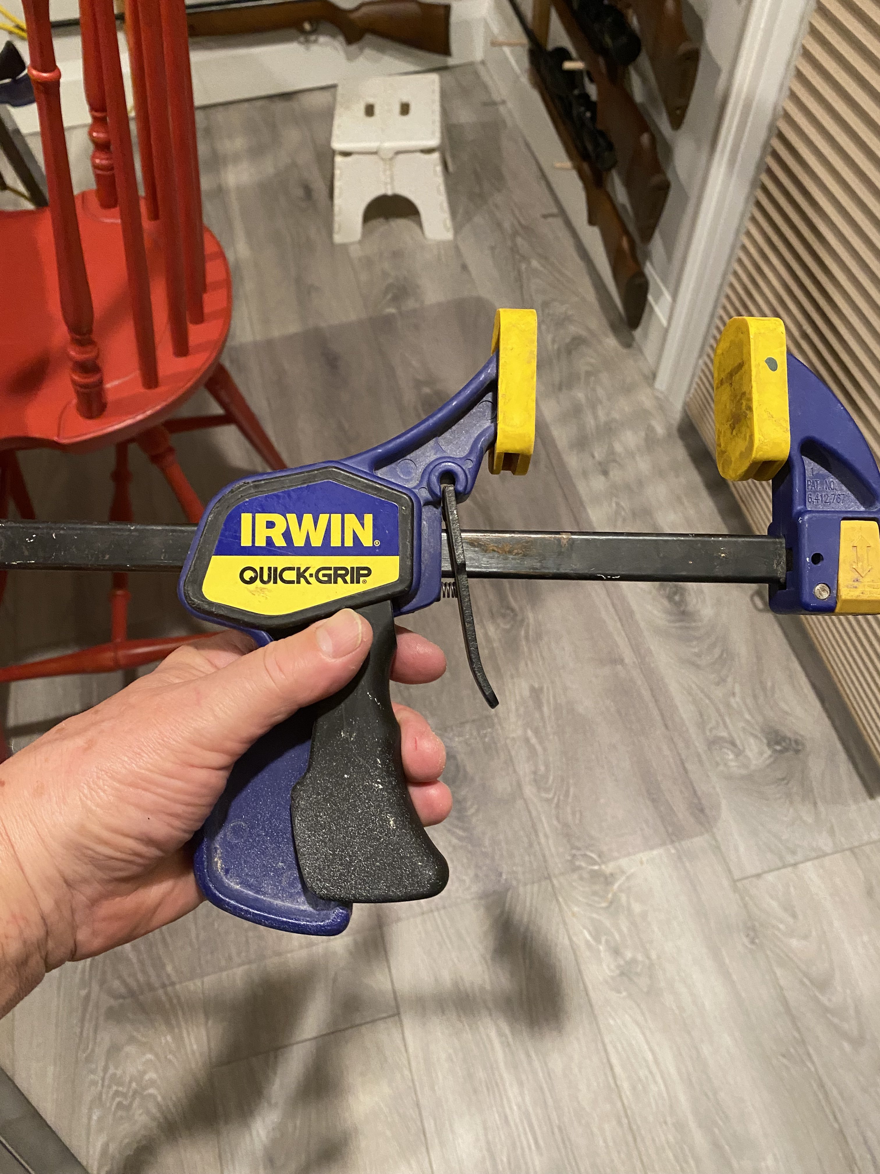

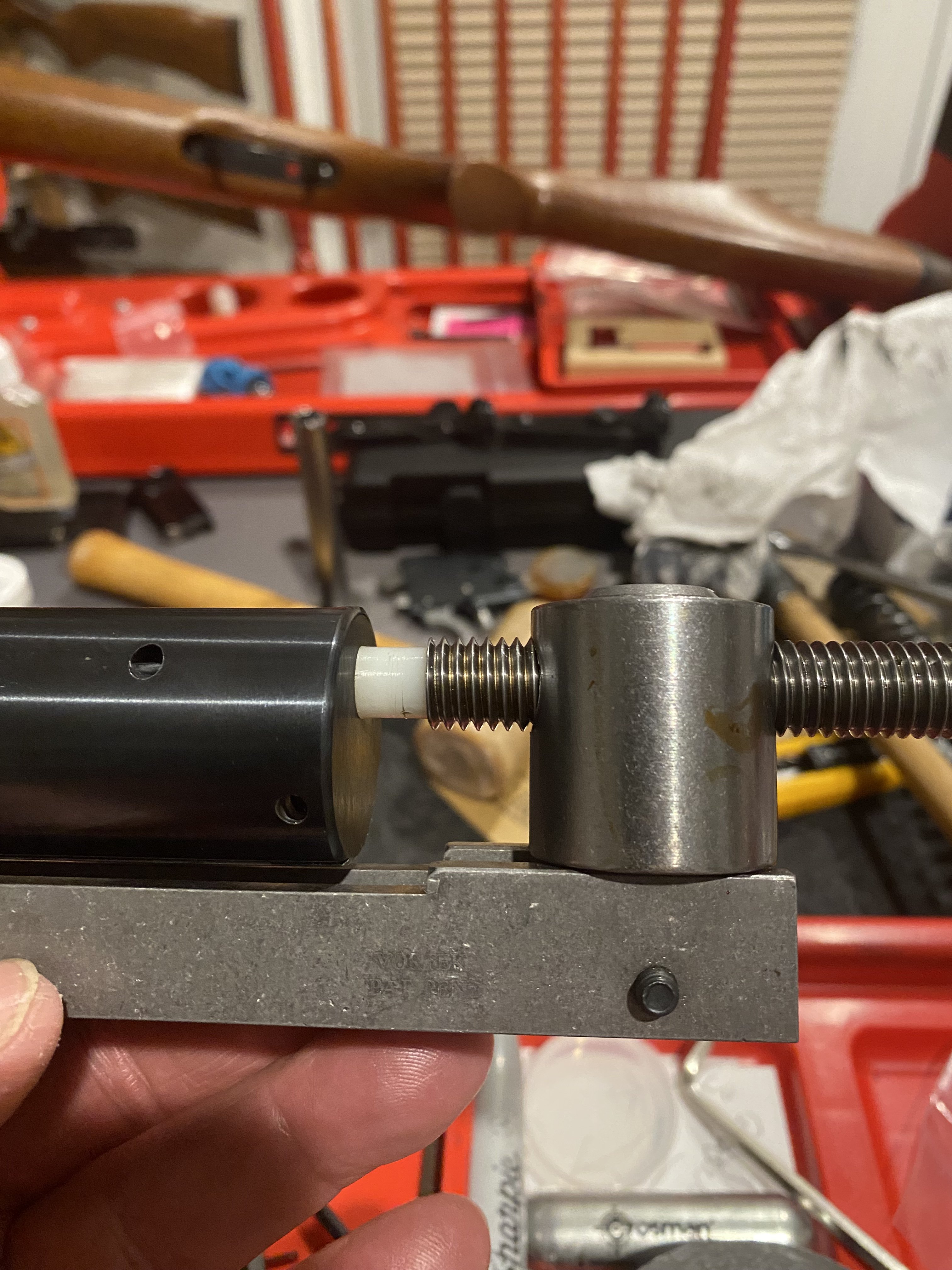

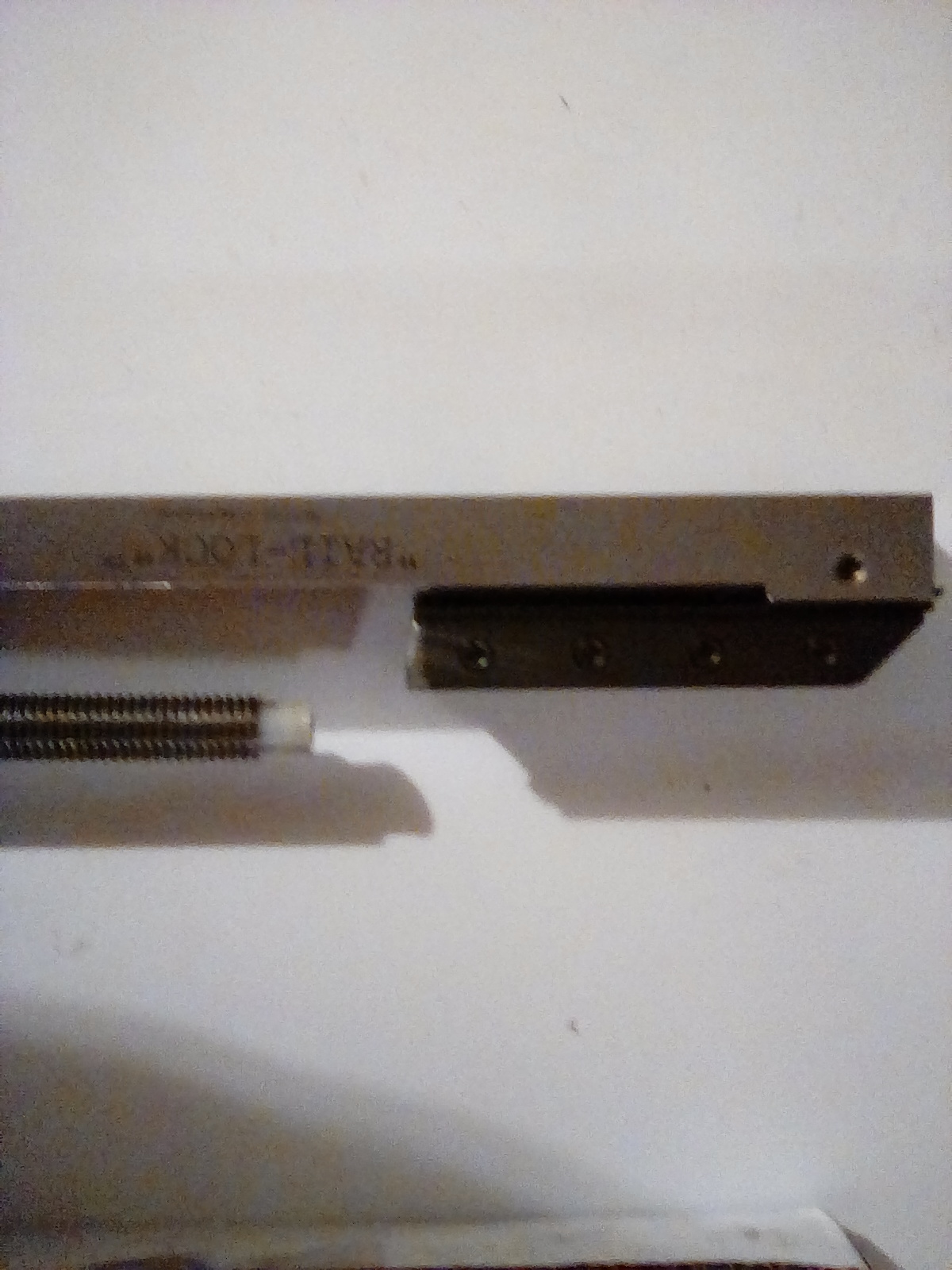

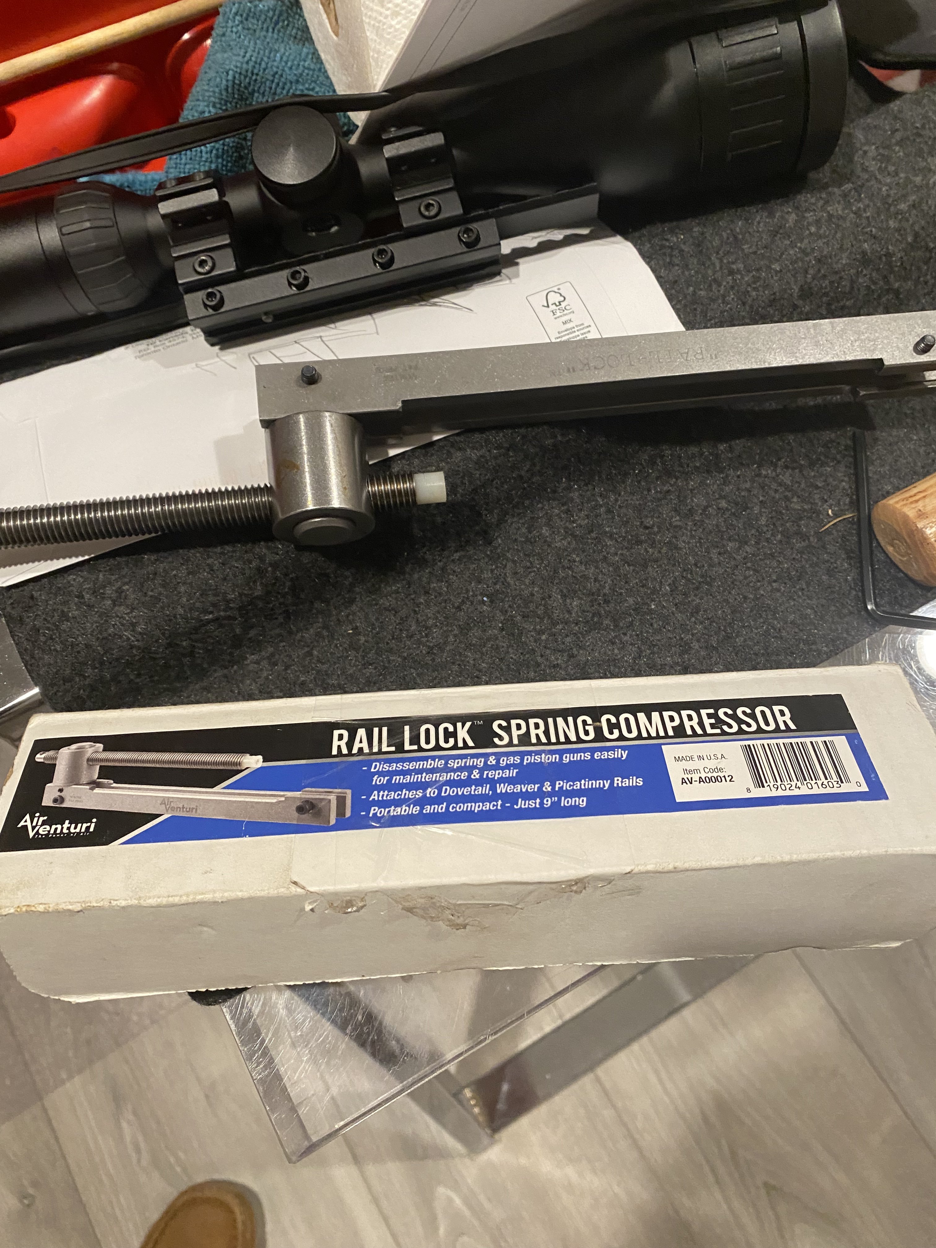

Tried to screw the trigger housing back on. Using the Rail Lock Spring Compressor. 1BD35780-E0FF-4725-BCF9-8703D27EEE3C.jpeg I’ve used this twice now a same thing both times. The screw does not hit the cylinder in the center. 4012551F-48DE-4602-8F45-462EB6E41554.jpeg So when trying to screw back on, forget using this tool. NFG. What a waste of $130. Again I’ll make one. I’m going to try to use a Quick Grip, just squeeze 600 lb. pressure at your finger tips. Have them on 24 and 36 inch bars. 4A97BCF5-D546-4DC3-90BC-57C7E716B12F.jpeg I think this will work, making it easier by squeezing instead of screwing. I’ve got at least 30 of these to screw on. I need an easy jig, made loads of those. Crow

Tried to screw the trigger housing back on. Using the Rail Lock Spring Compressor.View attachment 313750 I’ve used this twice now a same thing both times. The screw does not hit the cylinder in the center. View attachment 313751 So when trying to screw back on, forget using this tool. NFG. What a waste of $130. Again I’ll make one. I’m going to try to use a Quick Grip, just squeeze 600 lb. pressure at your finger tips. Have them on 24 and 36 inch bars. View attachment 313752 I think this will work, making it easier by squeezing instead of screwing. I’ve got at least 30 of these to screw on. I need an easy jig, made loads of those. Crow
I've got a Sun Optics spring compressor. Works pretty well, see if they are still available.
Honestly though I usually just manhandle the things together without it. A rubber pad so the plug doesn't spin, and your body weight usually does the trick.
I just went down and tried to screw in by hand, it’s just a little bit too heavy for my liking. That 80 spring heavy. Maybe if I had more experience with it I’d be more comfortable but I’m gonna make a jig on Friday for it I’ve got a day to think about it. Play it safe. Crow
Crow, I have the same spring compressor and had the same problem. Get an 11mm to 11mm riser mount and attach it to the rifle and compressor. That will make it line up. You can see how the riser mount is positioned on my tool.
I was thinking that, didn’t know there was such an animal. 1/4 inch is all I need. Thanks Moog. Hopefully I have one before the day ends. Crow
Reactions: Moog
