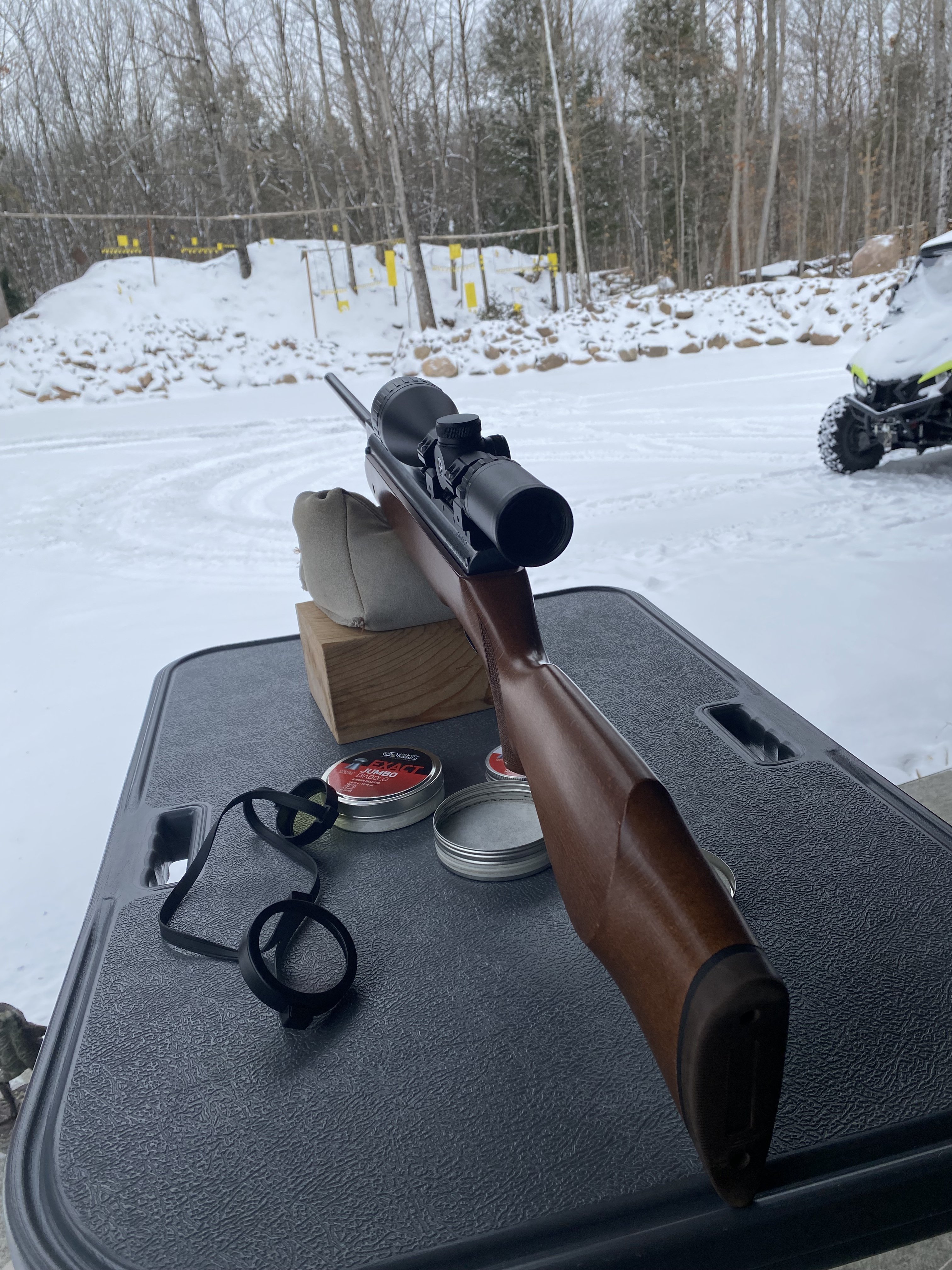

I think this is my first casualty. My 80 .25 normally hits my spinners with authority. 339E5FCC-157C-4AB7-AB19-D06ACA5AA708.jpeg Today the 80 didn’t hit any harder then my 30. When firing it has a muffled sound. I thinking a broken spring. I do have a Vortek kit for it. Breach seal? Looks like my first repair coming up. Crow
Any suggestions?

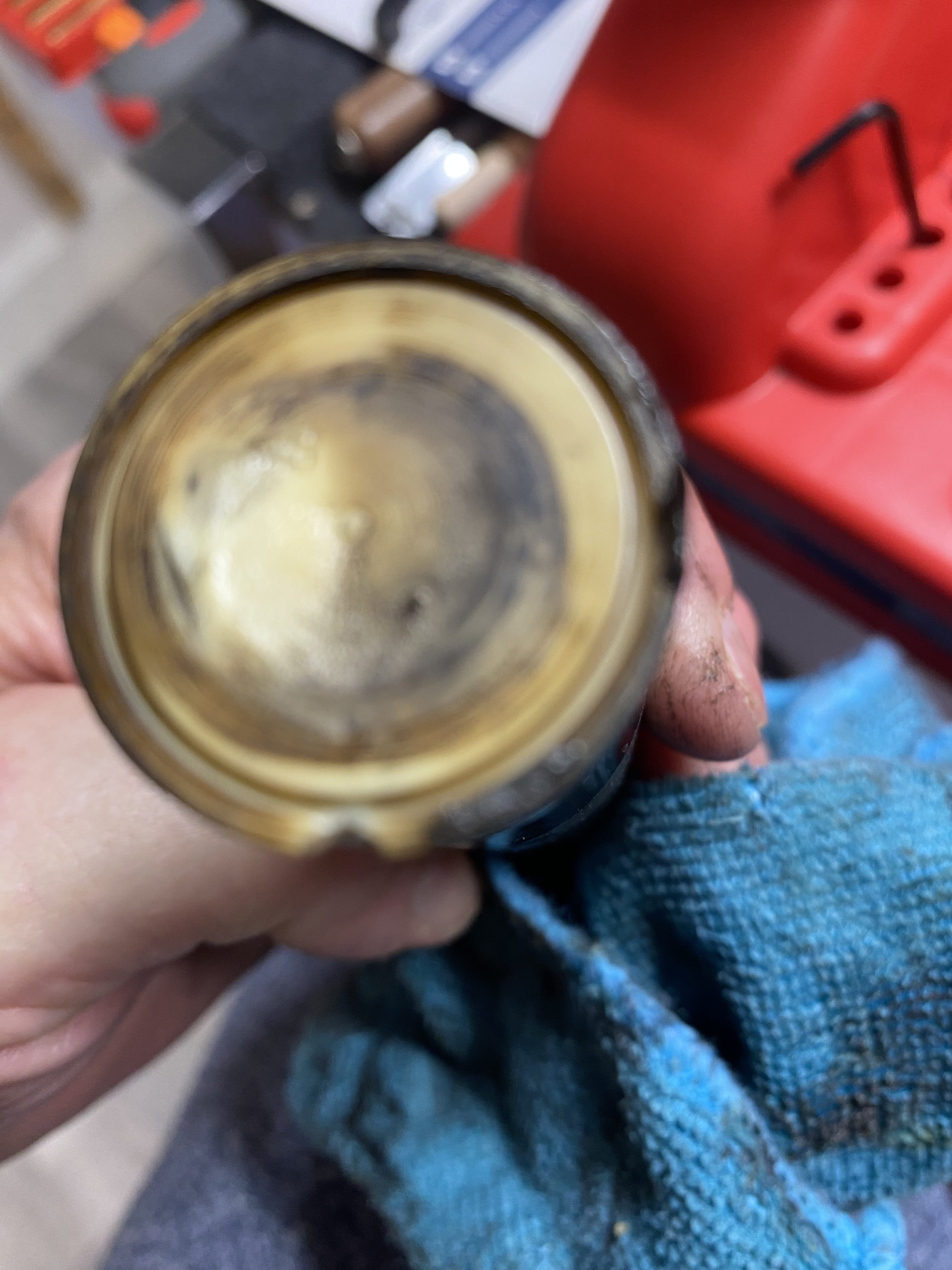

Check the very end of the compression tube for slag sticking out of corner seam. There's usually voids which isn't great but won't kill the seal. I recently found a bead of slag sticking out of the end plug braze on someone's brand new Hw50. Something like that would deform the seal and create a hot bypass that would burn the corner of seal. Weihrauchs have been coming over lubed for the last few years. That usual creates excessive dieseling which usually burns through the seal near the transfer port. That's why piston seal was my first guess. To have the corner burn through is unusual unless there's a problem with the tube or the seal was damaged badly upon installation.

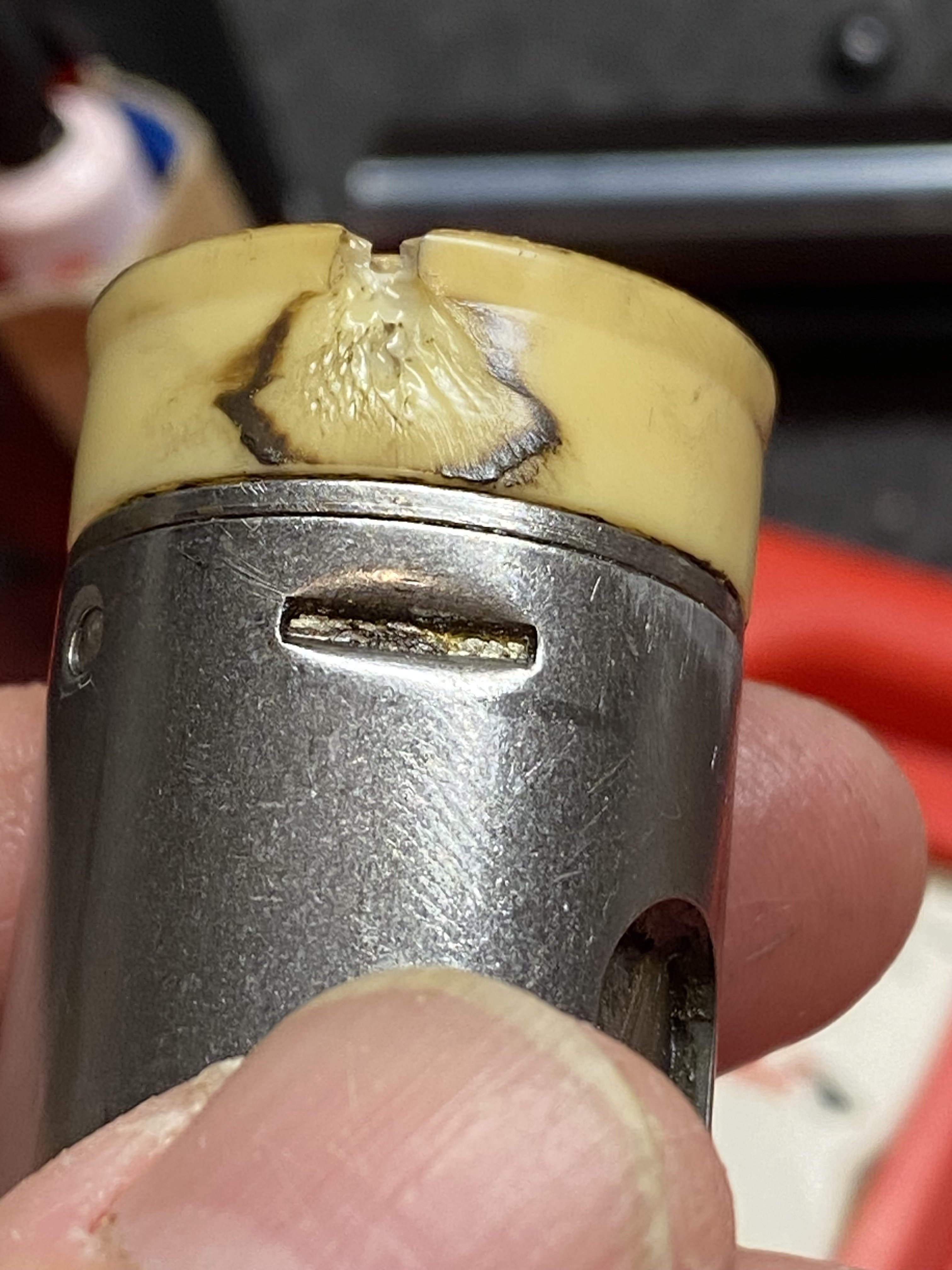

@crowski , that first picture was blurry but certainly tells the story. Looks like several portions of the outer lip of that seal are gone. All the carbon residue looked like excessive dieseling to and was what was going through my mind just as Mycapt made his 2nd post.

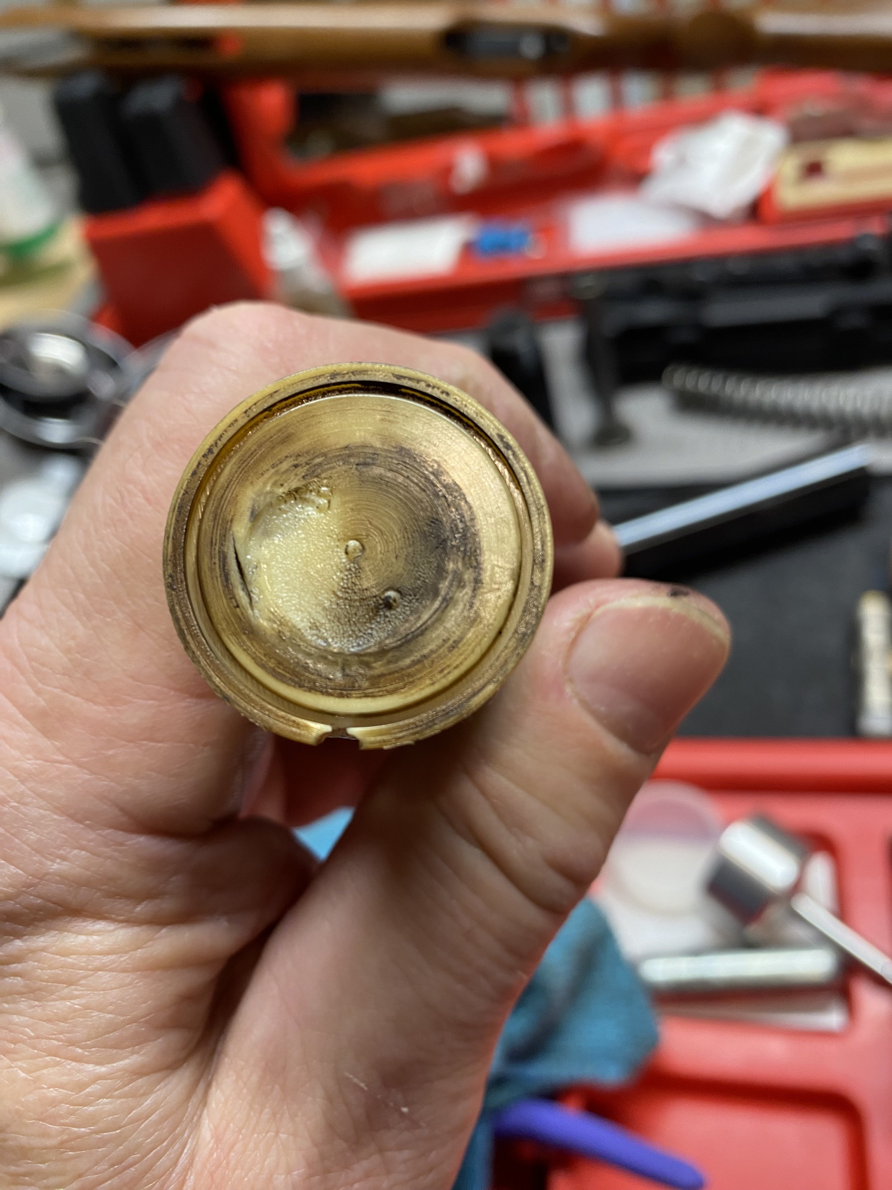

Definitely inspect the inside of the compression chamber where the transport port is very carefully for debris. It hadn't occurred to me that they're would be brazing filler or some other mechanical obstruction in there.
It's also possible that that seal was cut during assembly. Try to deburr the cutouts in the receiver tube before reassembling and fitting your new seal.
I would clean and degrease both the cylinder and spring and apply non-combustible lubricants of your choice. I'm still using the old school Moly paste sparingly on piston and seal, burnished into the chamber and the light spring tar. Usually only get a few light dieseling shots upon reassembly and testing
I'm not sure what the factory puts on the springs but as they vibrate during the shot cycle, stuff can be flung off and eventually work its way forward to the compression area and may contribute to dieseling if it's not the right choice.

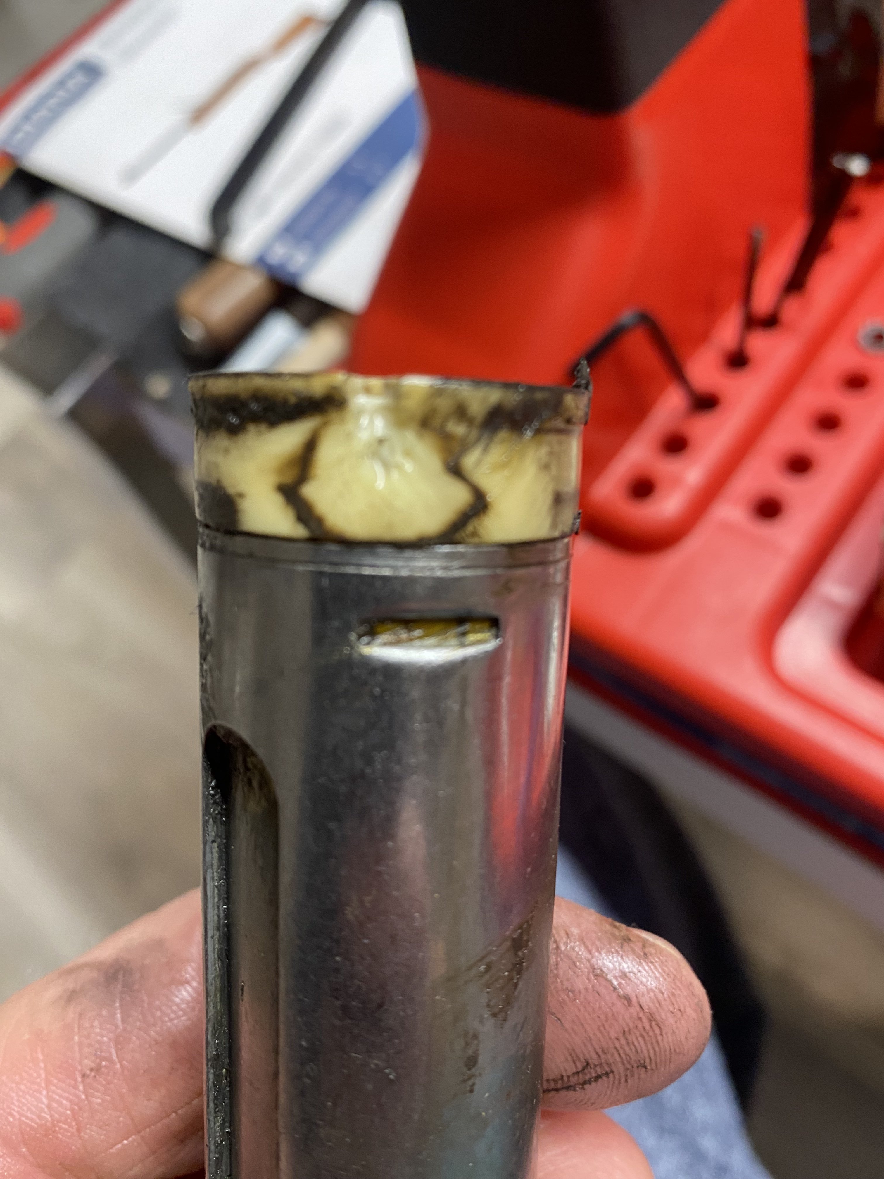

Feinwerk that’s wild probably when you were writing your post I was taking new pictures. I’ve got those last night late and my eyes are bad they look good then61930B51-E4A2-4890-A364-3F4BDA5DFE7B.jpegF8310A4D-91FC-4056-8760-87785CC2DAB9.jpeg.

Okay much better pictures and now I see that the lip of the seal is blown out in just one place. May have started with a cut during assembly. You can definitely see where repeated heat from the compressed air during the shot cycle was blowing by and started to melt that synthetic seal on the side.

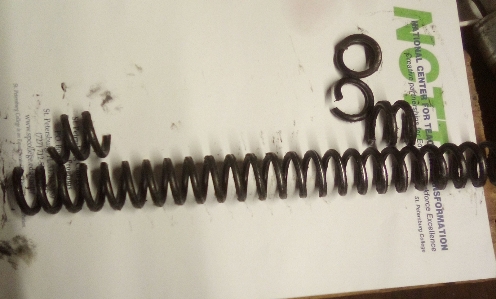

My hw spring broke in like 4 places in like 6 months of use from new .. seal was not burned but cracking
I know you know this but for others. Both the seal damage and the broken spring were caused by excessive dieseling from poor assembly practices and or over lubing. Very common in recent Weihrauchs. That piston seal is burned from the dieseling. It may not have completely burned through yet but it would have if the spring didn't let go first.

Maybe . It looked like new after a good clean up except for the cracking (seal). Sadly it was one time i did not pre inspect/ disassemble new out of the box . Well now has a arh spring and another hw seal. All a guy can do after the fact is shrug shoulders order a tune kit rebuild and keep on shooting.😁. Nuttin but a thing to deal with.lol.
