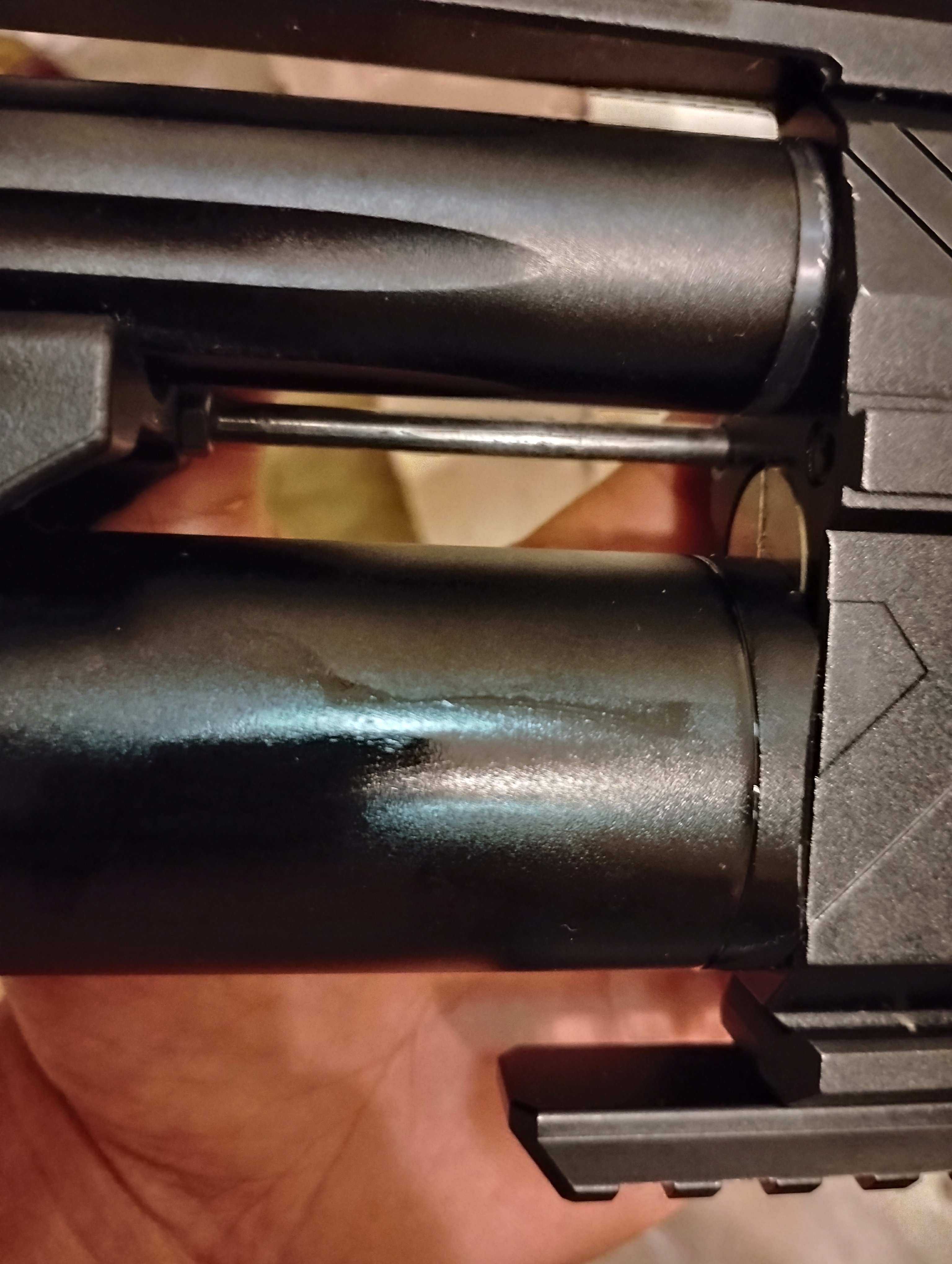

Every few days I'll notice a stream of silicone oil down half the length of its air tank. No drop in pressure that I can notice. I lube up the orings pretty good and coat the inside of the tanks. Out of all my pcps (about 10) this is the first time silicone oil has managed to get out of the tank. It's a aea megalodon. Has this happen to you before? Has to be a very very almost non existent slow leak? Because the pressure is at the same spot if not a tad higher.
Pic

use less oil, with PCP's, only use what is needed, excessive oil will cause dirt to stick and collect on the gun, I use 5-10 drops of Silicone oil Every 20 fills of air, applied through the fill port hose, it is only for lubing the O-rings just enough internally, to much can cause O-rings to swell and will create a possible leak, so in this case too much of a good thing is bad..... go a bit easier on the oil....;)
