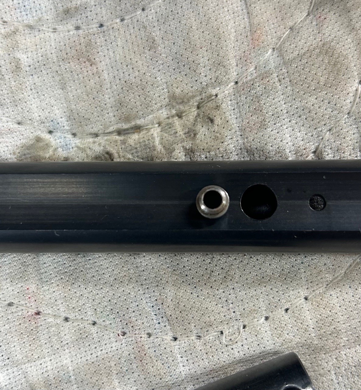

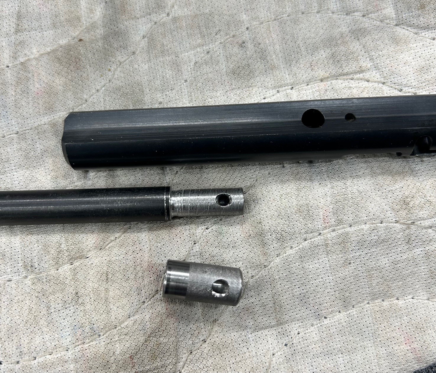

So, I made "sleeve." to act as the connection point. Then turned the barrels to be a slip fit with the sleeve. The transfer port holds the sleeve in position. After fitting the barrels I spot drilled a locater 90 degrees from the transfer port to locate each barrel.
