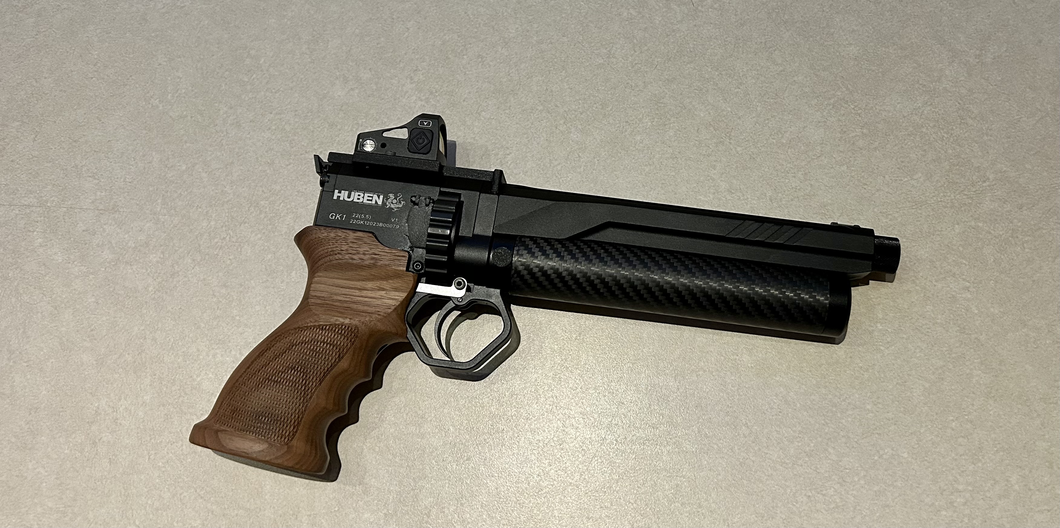

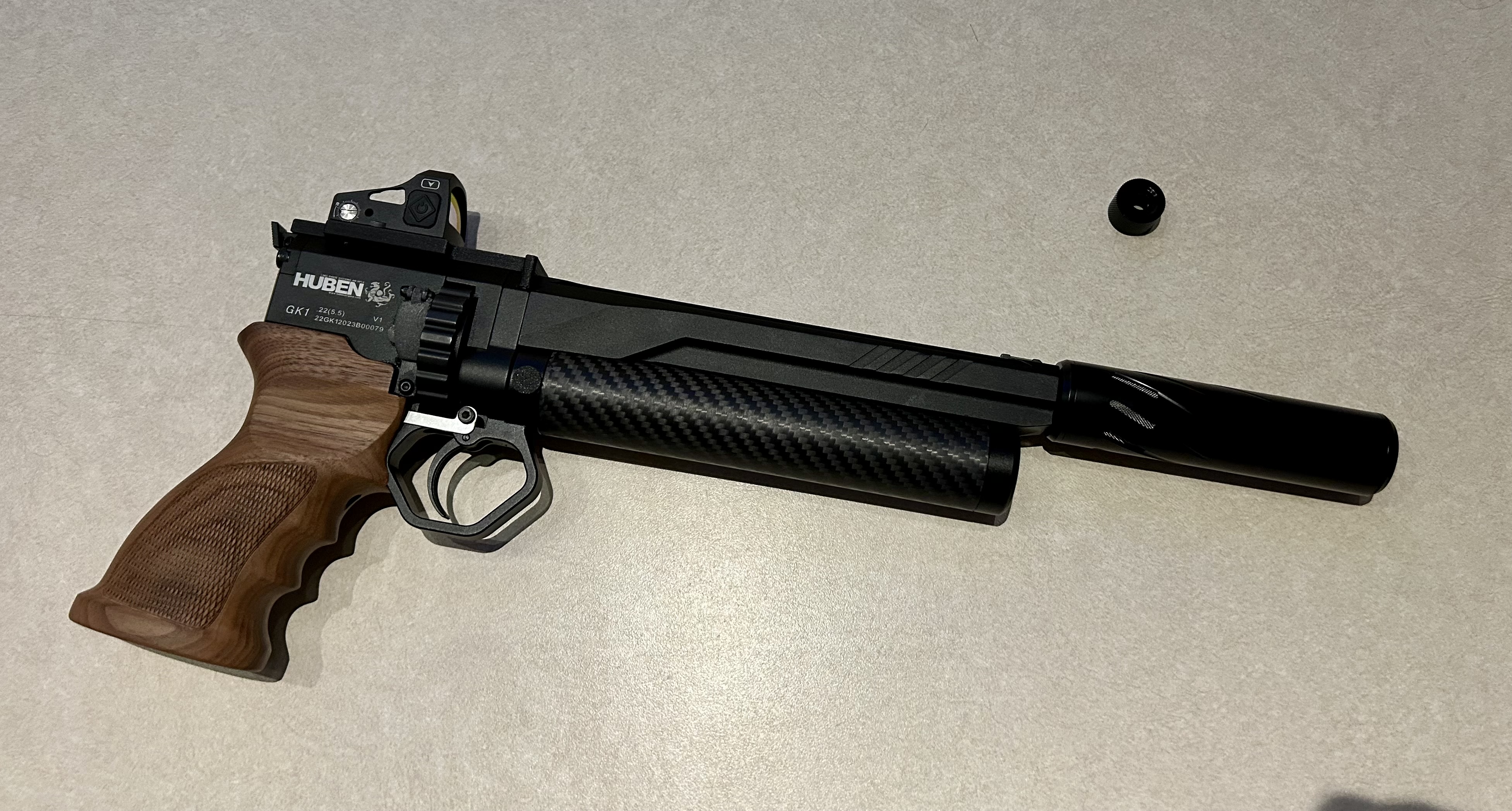

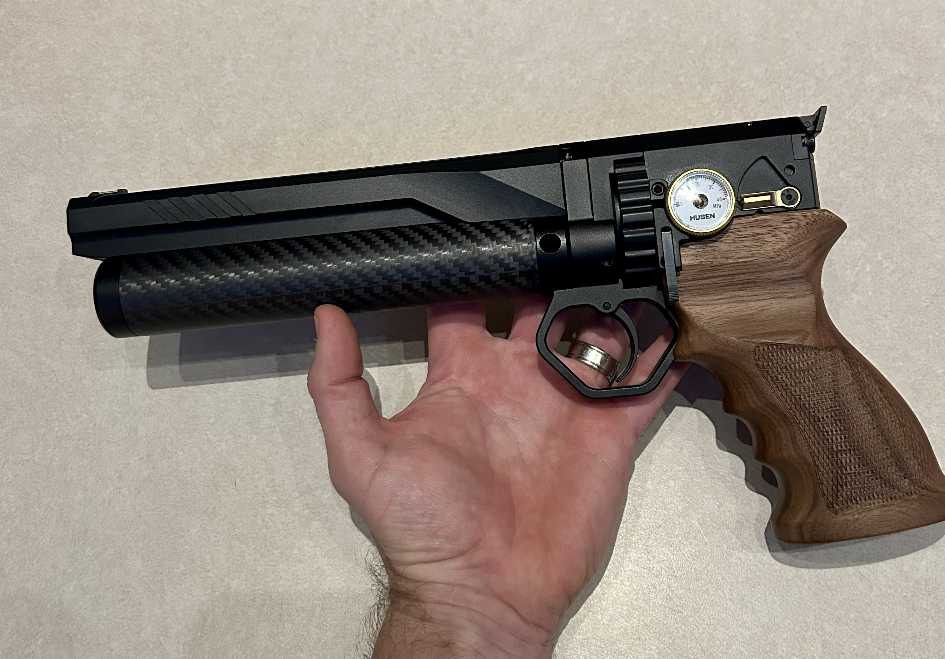

Huben My GK1
Got my GK1 in the other day. Been playing with it since last eve. Killer pistol. I had accessories waiting for it to deliver. @M0ist0ne makes some goodies that I’m utilizing. The red dot mount & load gate are very well make 3-D printed pieces. The load gate allows for 3 projectiles to be loaded and doesn’t require you to force them in, just drop ‘em. It’s finished off nicely with a magnet that snaps it back in the closed position. The red dot mount is precisely made. Love it! Also, a fill port plug that keeps the dust out 👍🏻

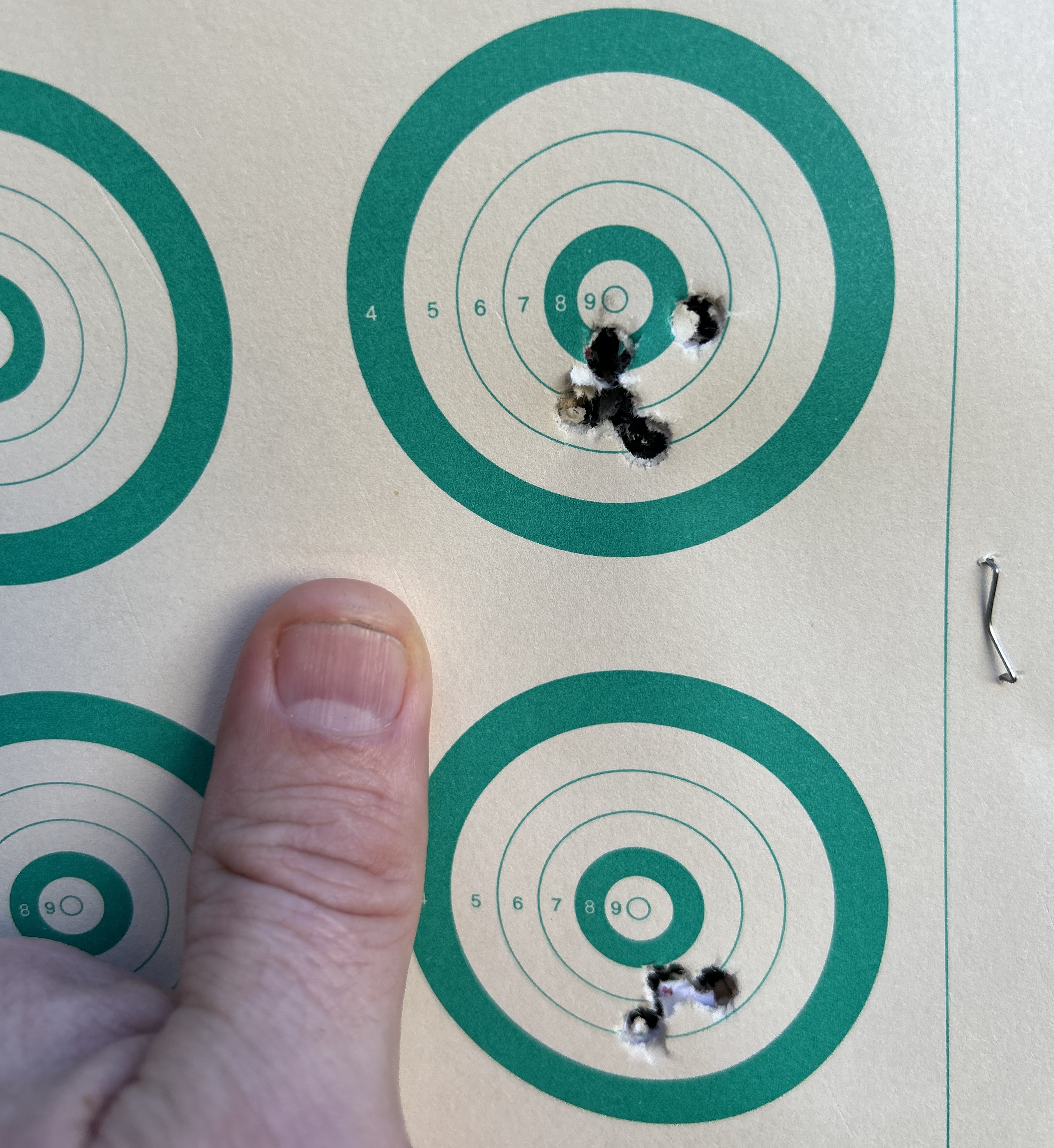

The Huggett tames the bark quite well. I was pleasantly surprised with accuracy as I got it about sighted in. Below are a pair of 5-shot groups (rested) from 25 yards (not 50)
This is a very fun and capable little pistola.

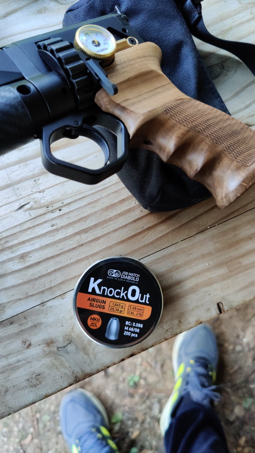

Try out some varmint knocker slugs, they shoot better for me than even the GTO's which shoot better than JSB 18's. I was hitting my 1" spinner at 50 yards about 4/5 times. Every other (larger) spinner EVERY time. They pack a much more satisfying smack at 50 yards than those GTO pellets do!
From a 300 bar fill, I get one full mag at 810-850fps (43fpe), with the 28.5gr .223 slugs.
Thanks for the tip. I have ordered some. I’ve tried everything else, so why not!

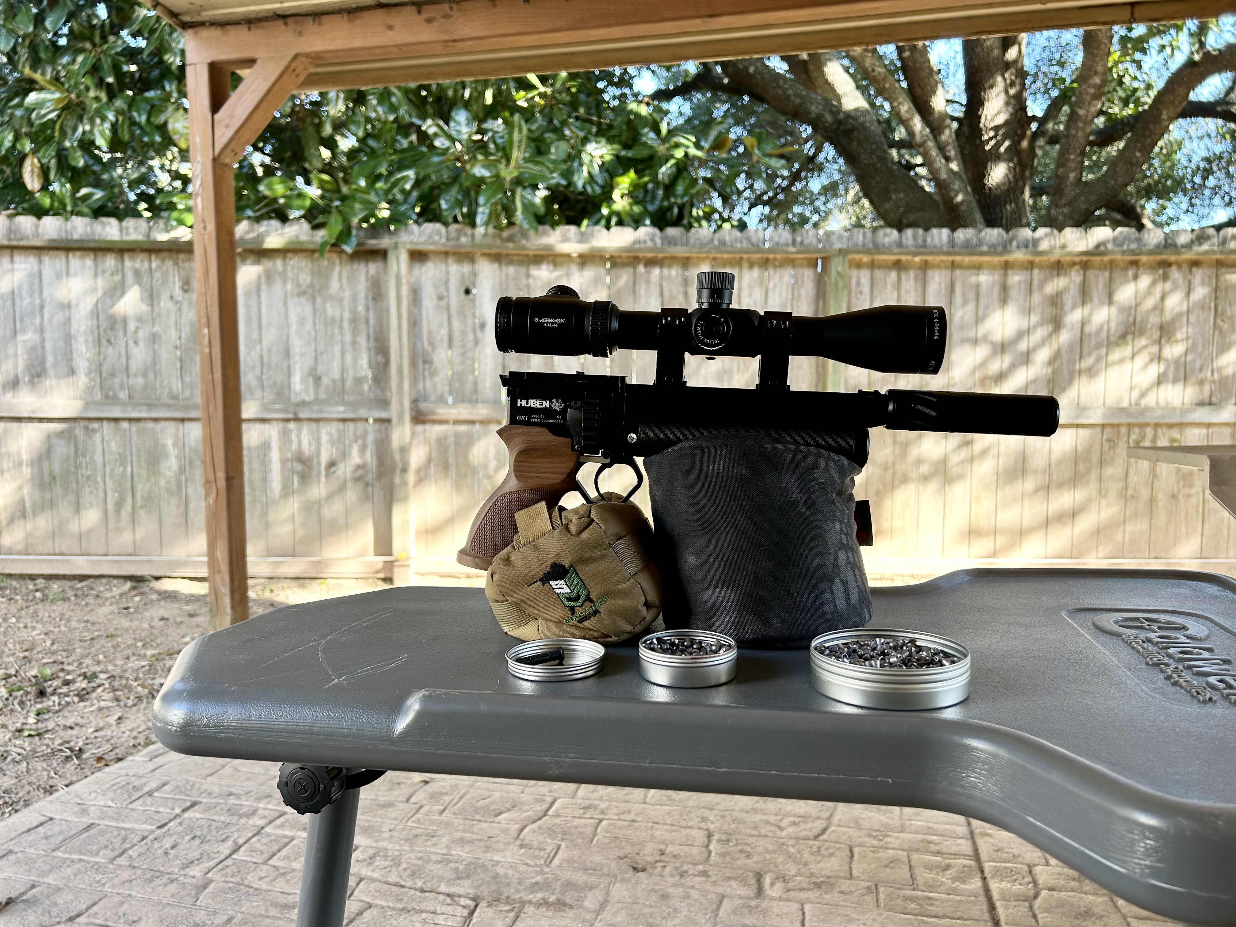

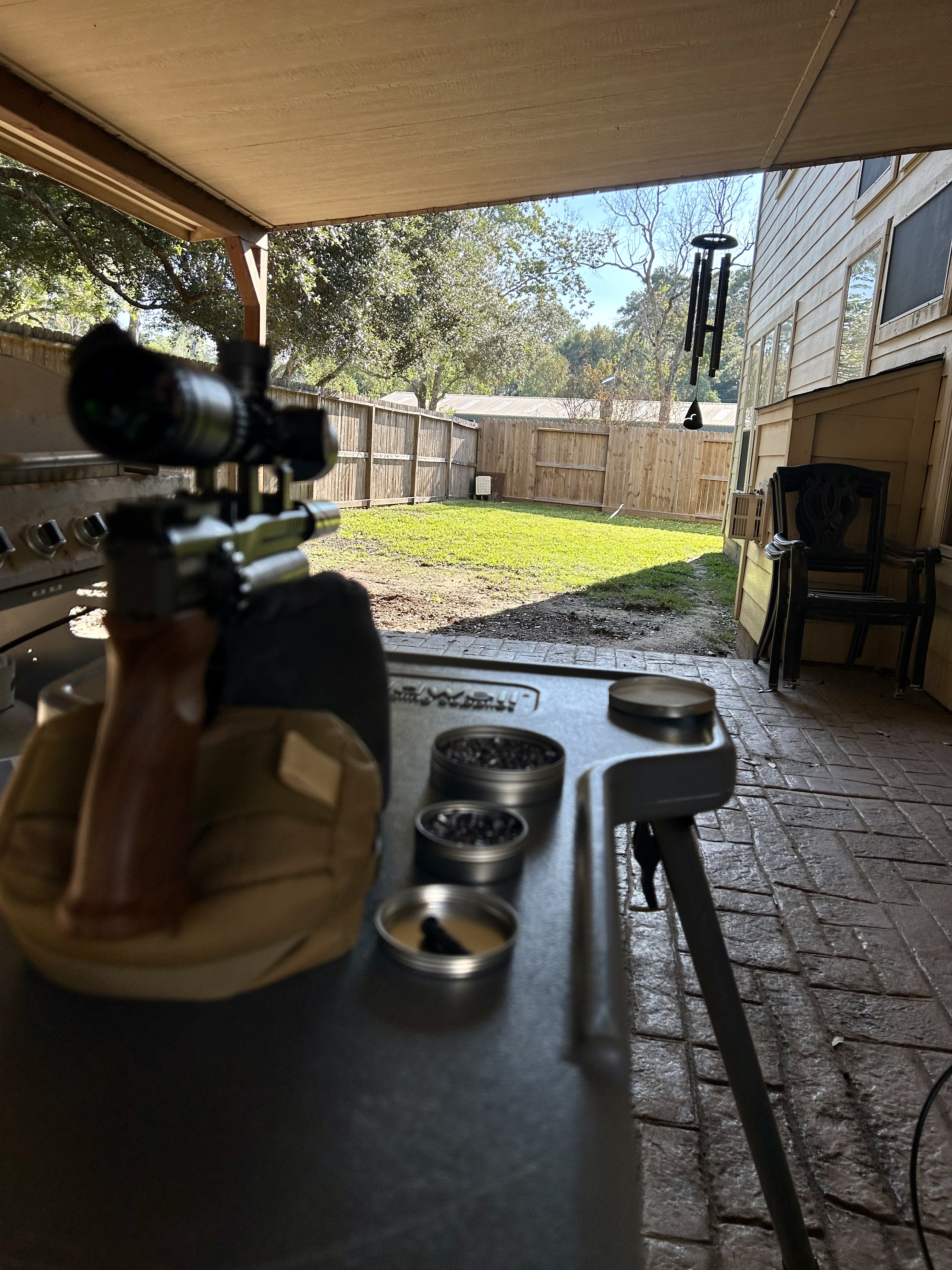

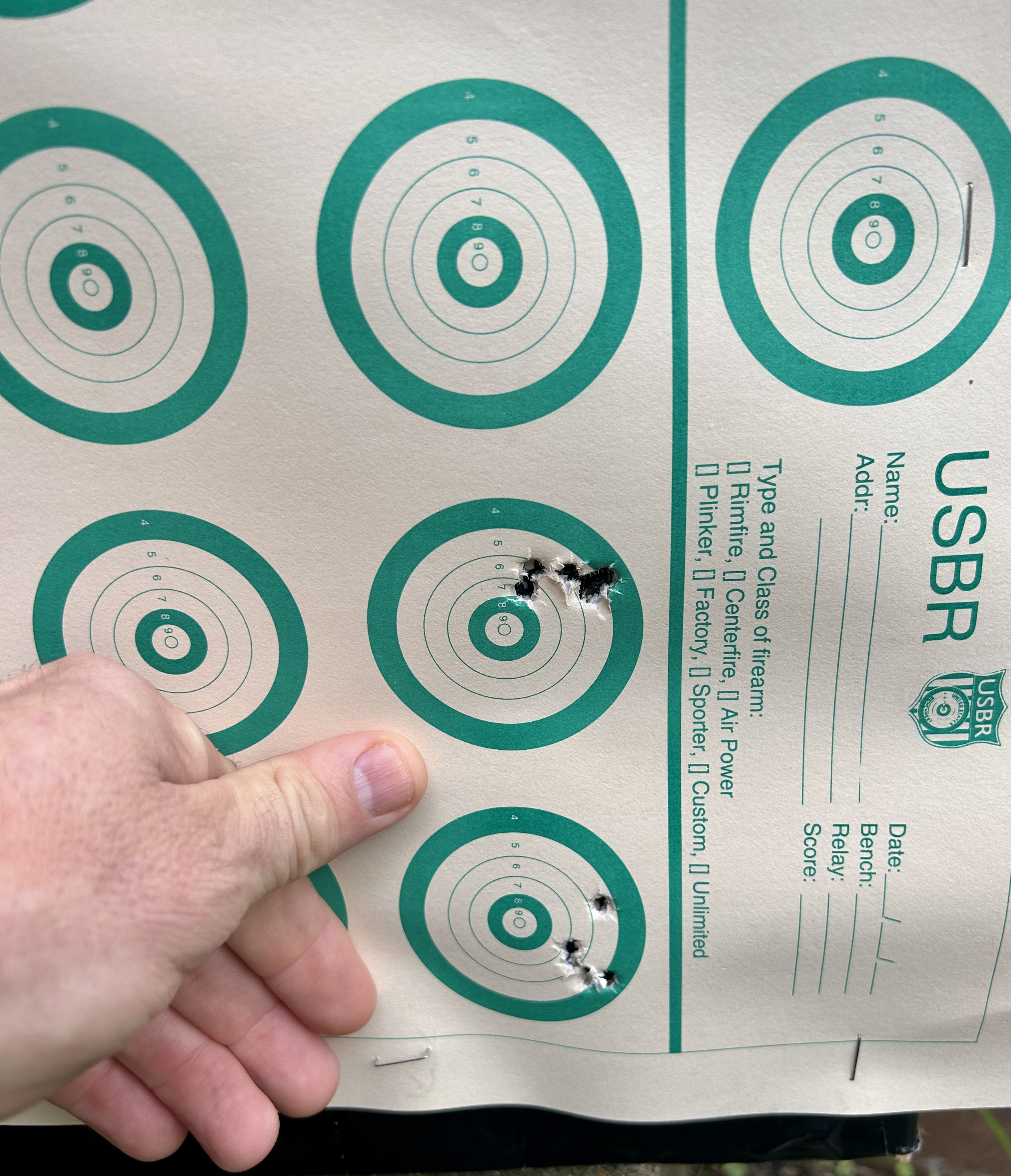

Well, had to find out what it’s really doing for accuracy. I mounted a scope and put it on the bench. Tried JSB 18.13s and 15.89 Hades. Wow 🤩 for semi auto pistol, this little guy rocks‼️I’ll see the JTS 21.53gr semi-dome do next week.
Here’s (2) 5-shot groups with 18.13s at 25 yards:
And same for Hades:
