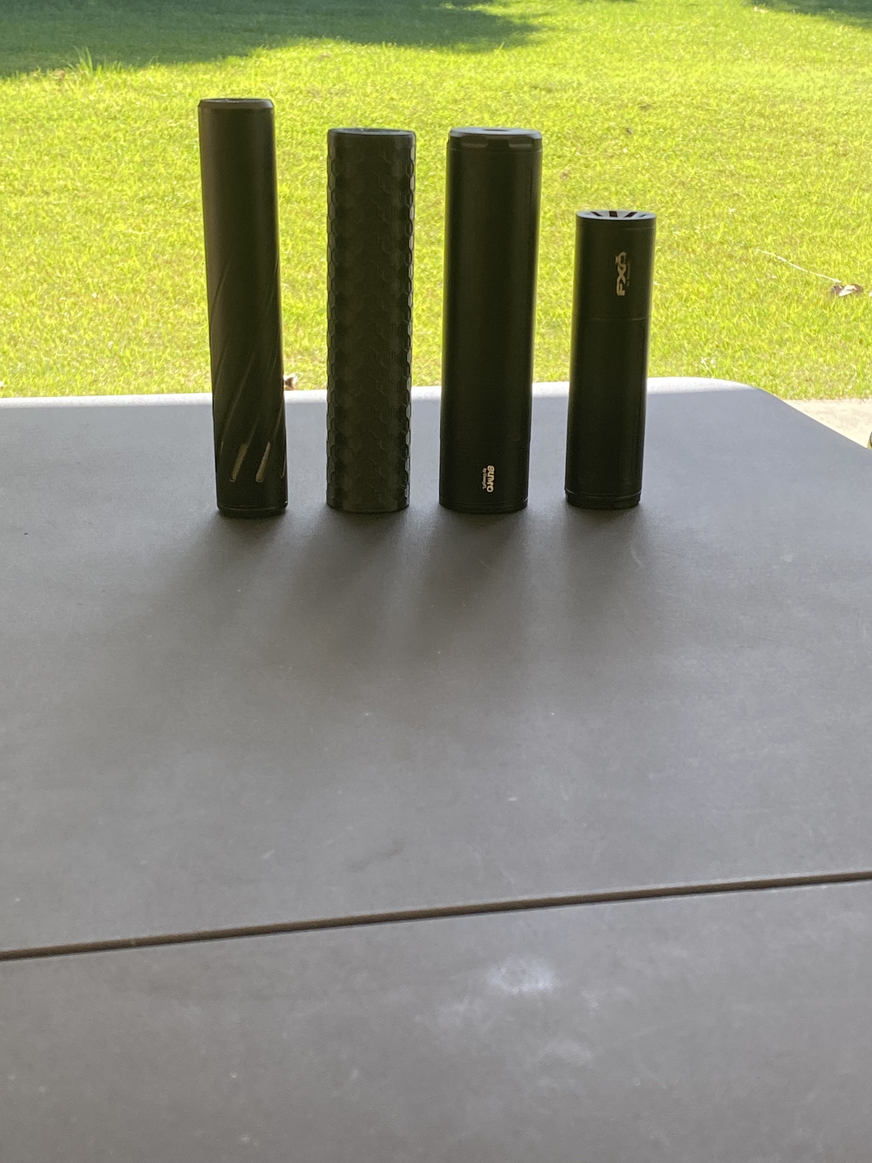

Thanks for the info, If these new FX King are backyard friendly I will not hesitate to buy one, in fact before selling the cricket I removed the Sumo and installed one of my Huggett moderators and became even more quieter which is why I decided to sell it along with the rifle to put another on the next one I buy. Currently these are the ones I am using on my others three Avengers. From left to right is the Huggett snipe standard, the Buck-Rail 3D printed, the sumo and FX DonnyFL moderators.
with that selection it's got to be hard to shoot? which one today? why not two? oh well drag them all out and then run out of time.. that collection is wonderful

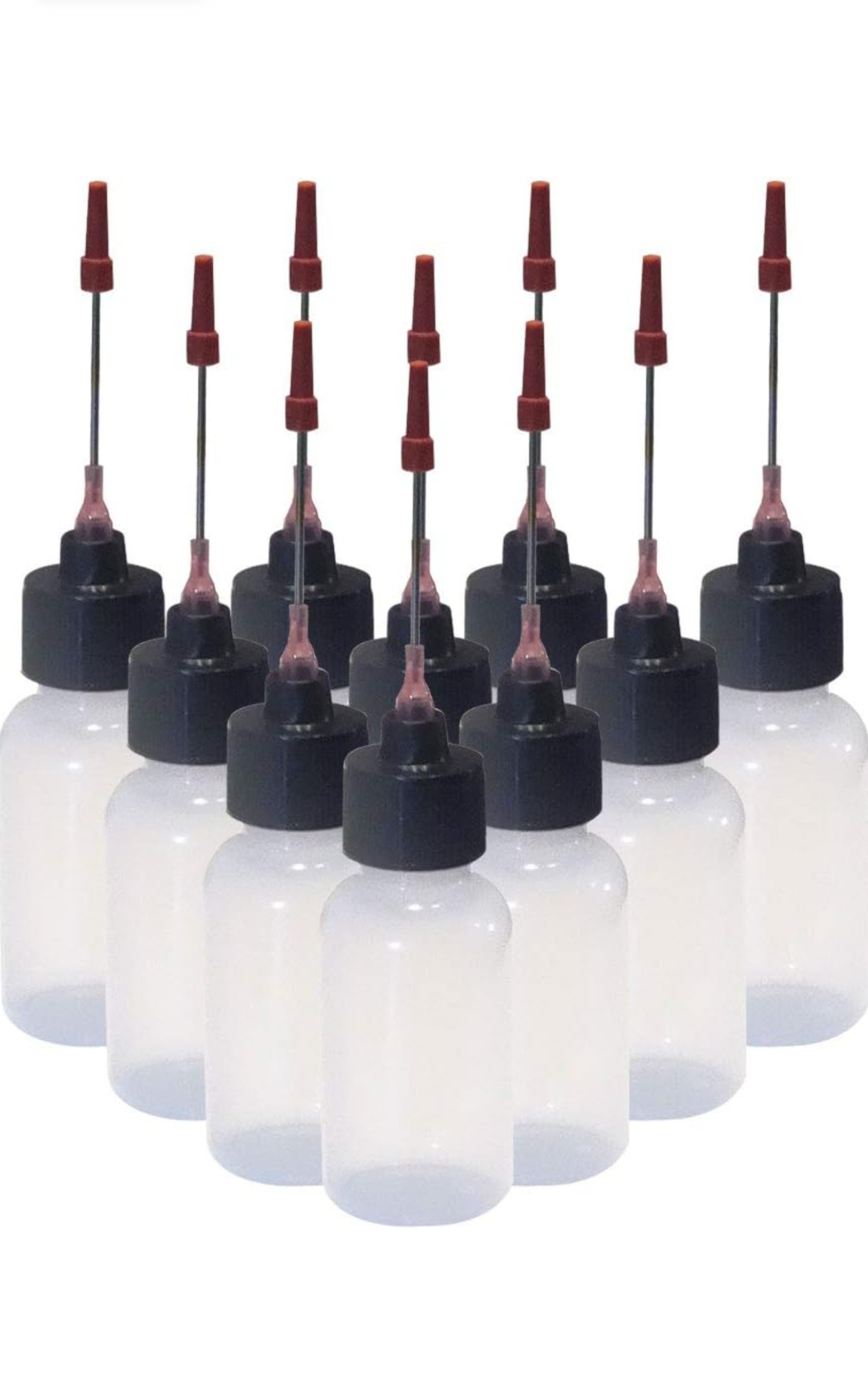

Nice post. When I can't find a leak I dunk it.
Get yourself some of these and add non corrosive leak solution.
