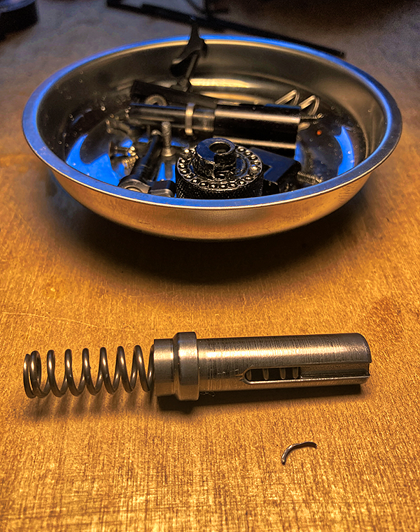

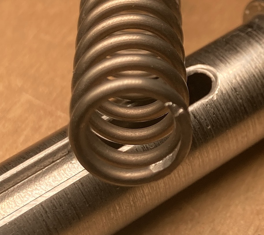

Mine got a tiny piece of the spring wedged in between the hammer spring housing and it's OK now after removing it and polishing the end of the spring where it broke off

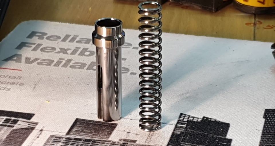

I never had a damaged spring like Goldwing - And I am using the harder Huma Tuning spring.

Nb. I polished spring hammer and guide greased with slight bit of molycote powder.
