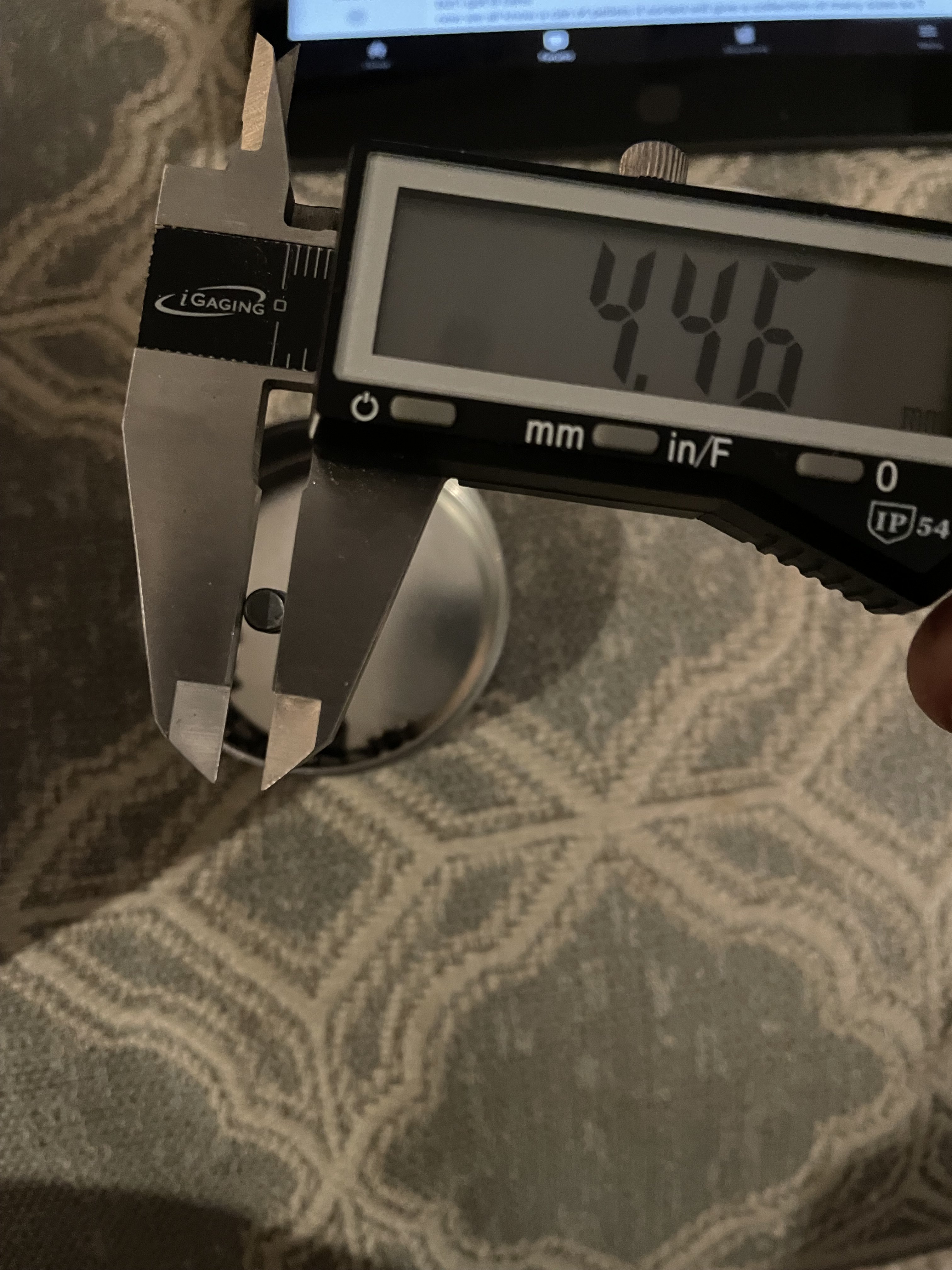

“Or have another wadcutter that works well in the 300S?”
Maybe try some RWS Basic 7.0gr. I randomly measure a few and the head size was 4.46mm. I can’t speak for these in a F300 but my Diana 75, Walther LGV Spezial rifles, Diana 6 and 10 ten meter guns do really well with them and they are reasonably priced. I believe they have a good overall following and great all around paper puncher and plinking pellet. Your mileage may vary!
