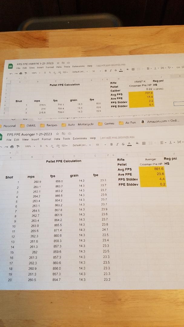

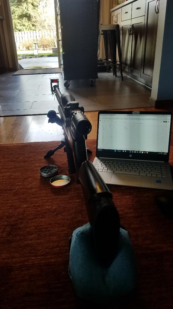

And set everything up today. Took 21 shots for no particular reason. You can see my results below for the Avenger and another for the HW97k. Both in .22
The unit can be set in fps, mps, and joules (with input). I just chose to record the mps and build an excel sheet to save.

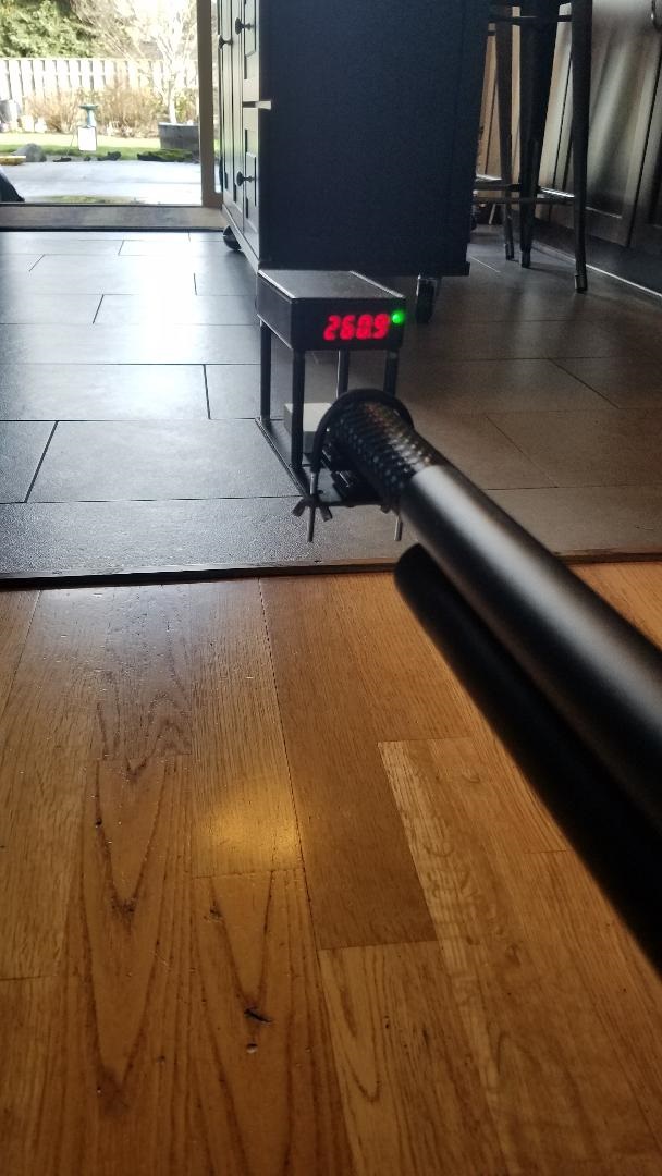

Good job on gluing a piece of wood? in the middle to protect the far light. Wished I had thought of that before shooting out the far light on my first chrono.

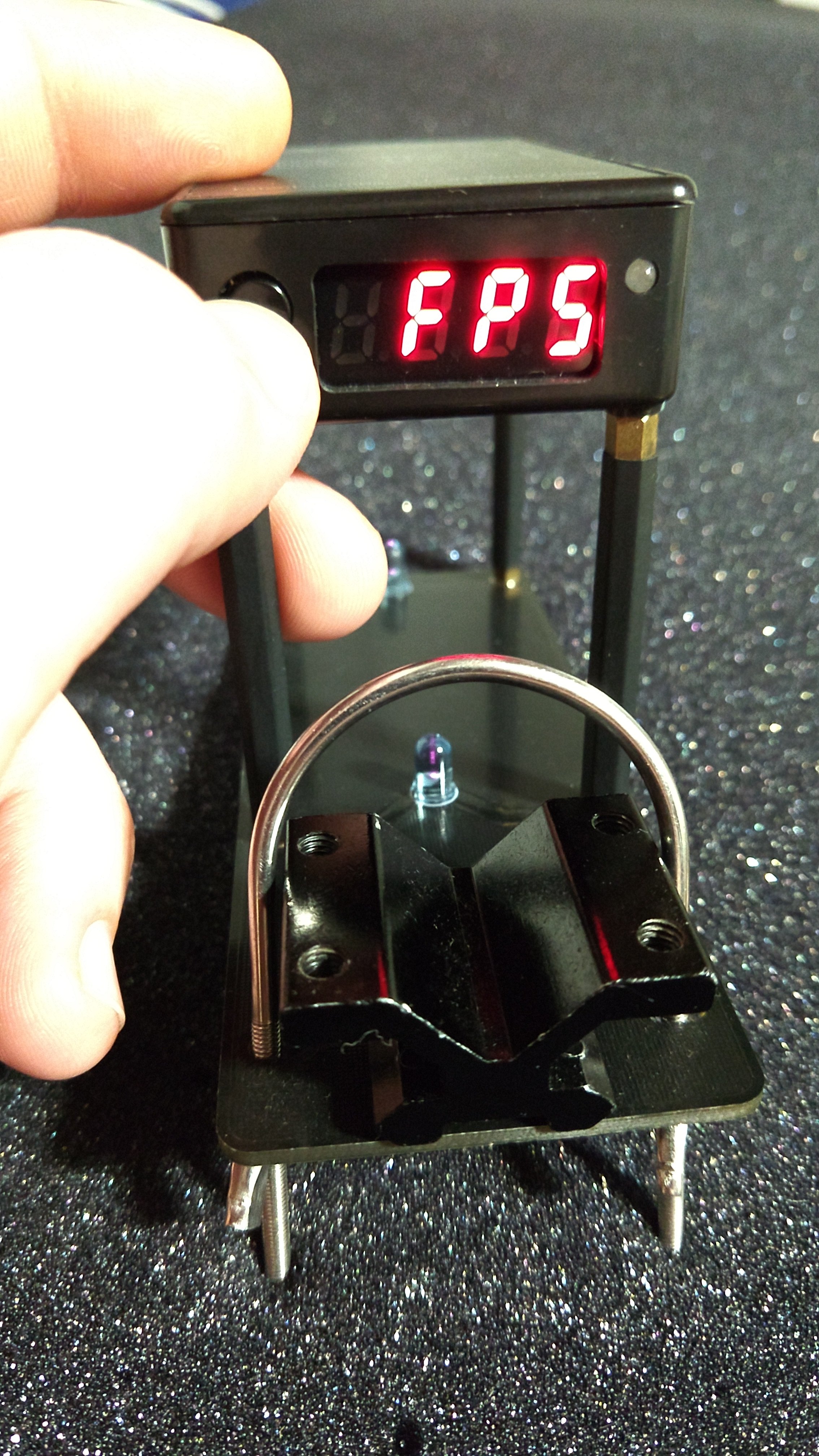

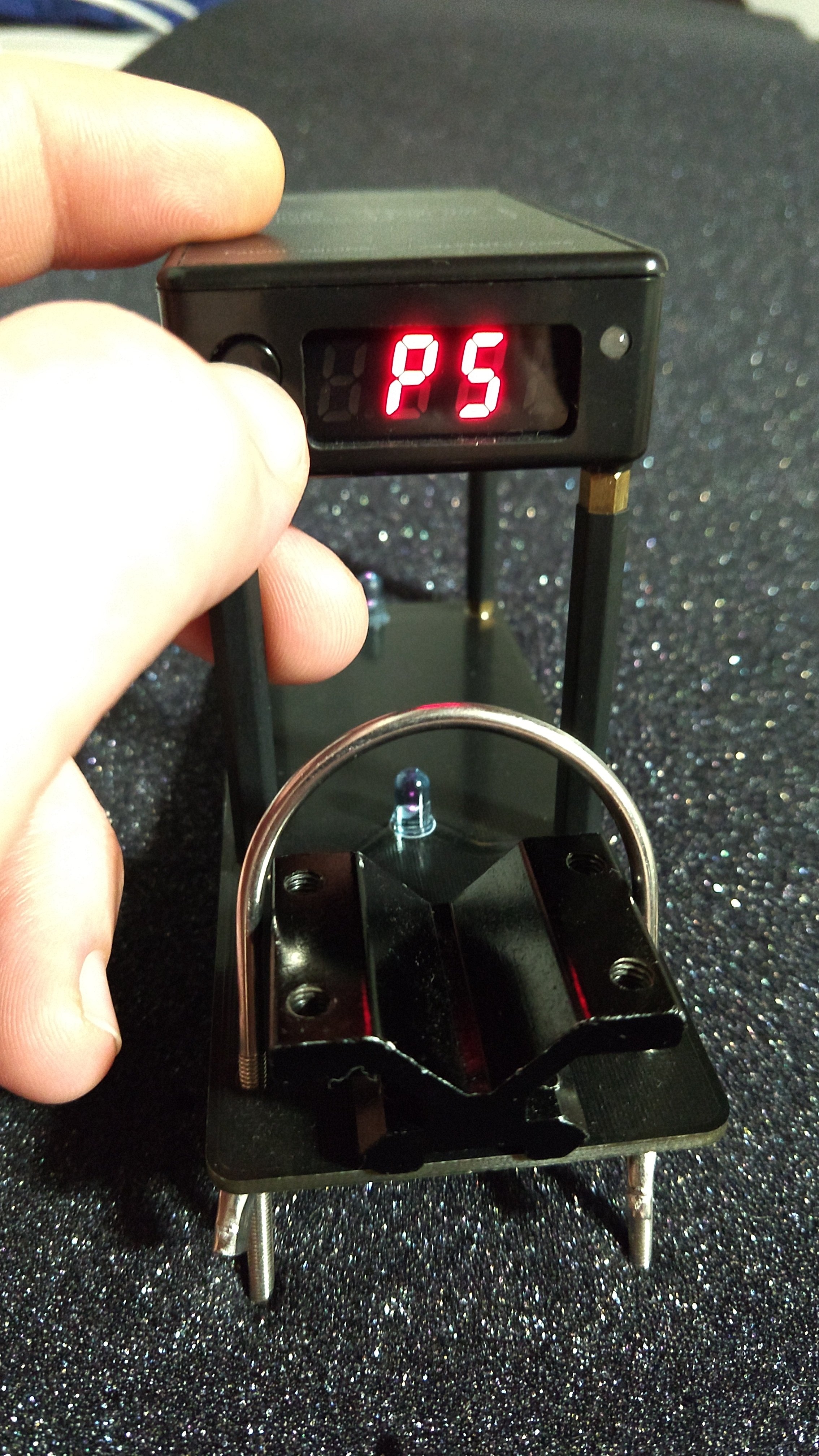

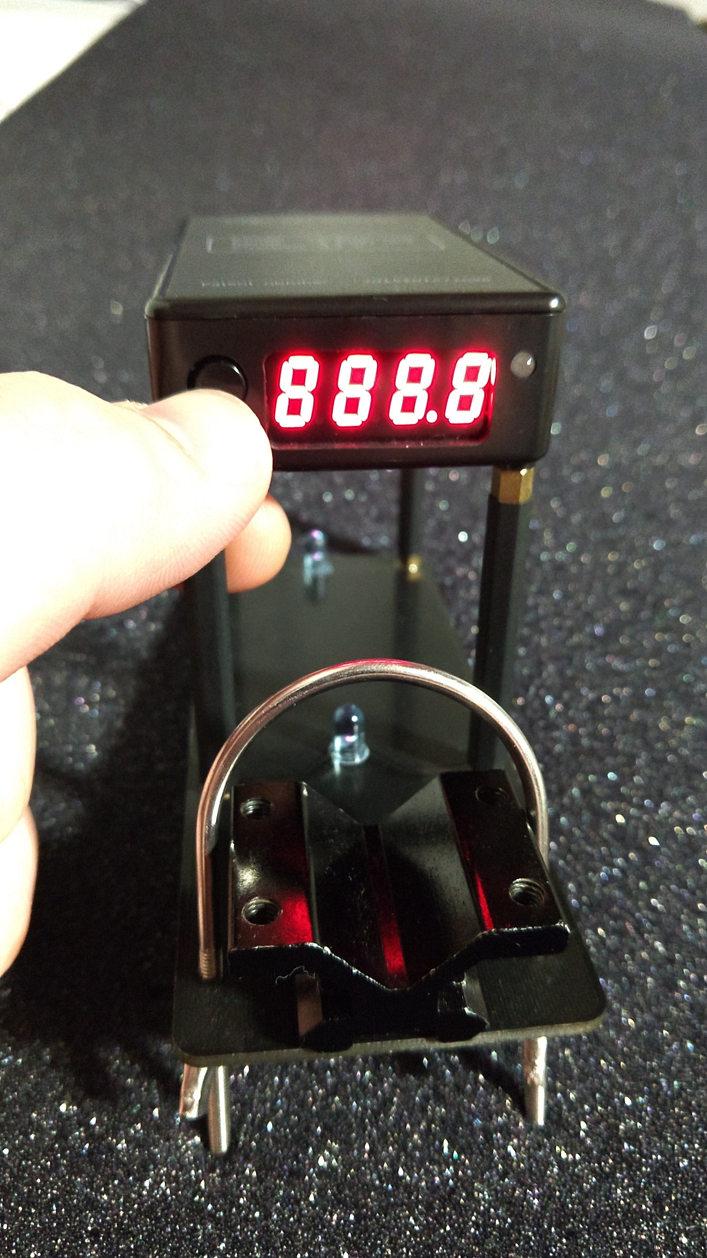

I have that exact chronograph. When you power on the device, it'll say On, then 888.8, then wait til it says PS then hit the button once and it'll say and swap to FPS. Never programmed mine and can't confirm it's accuracy. When I increase HS the FPS goes up, so it's gotta be close! Lol Also like how it can clamp down, and how light/portable it is. Definitely worth the $
The clamp-on version only has 3 digits. Not 4 and never displays 888.8 when "booting up".
So you do not have the "exact chronograph". You may have the other version, but not the clamp-on version.
Two little LEDs. I read where a guy shot one and replaced it with one out of a tv remote.
It works in the dark. I bought one because I couldn’t get a Caldwell to work in my basement, and I didn’t want to fool around with light kits. This, for me, works so munch better, especially from a convenience standpoint. No set up, clamp to the moderator and shoot. That also keeps me from shooting the device. There is a huge thread on GTA about these. Well worth $30.
It does change the poi, so be mindful of that. Test speed and accuracy separately, and don’t shoot the wall...DOH!!!

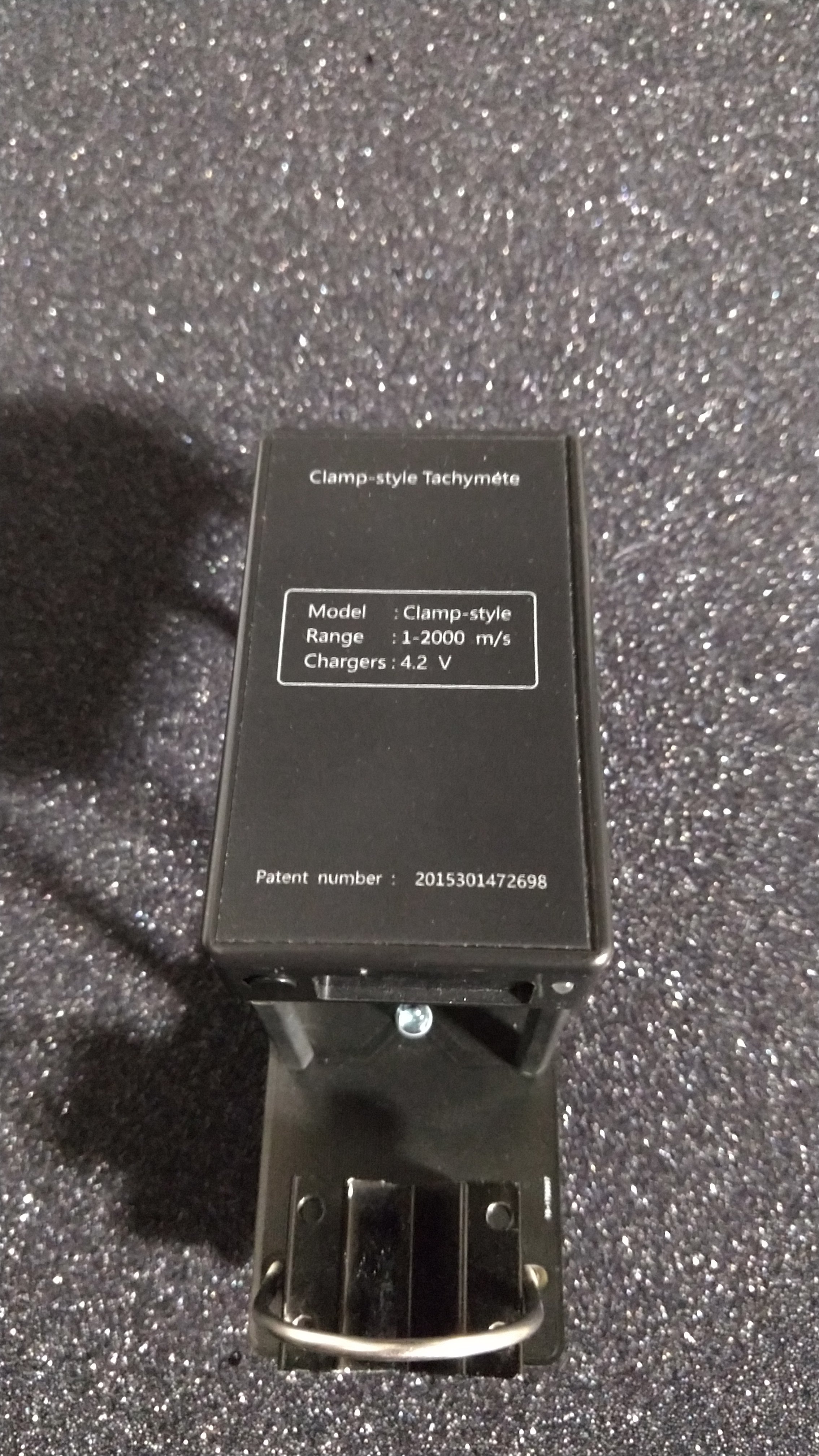

Sorry but I can't imagine what would make you think you can know what I "do not have" when it's literally the same one as in Post #1's link, as I said. I clicked that Amazon link and it says "purchased on xxx xxx date" at the top.
Anyway, here is proof showing my clamp on version. Which says... "Clamp-style" right on it.

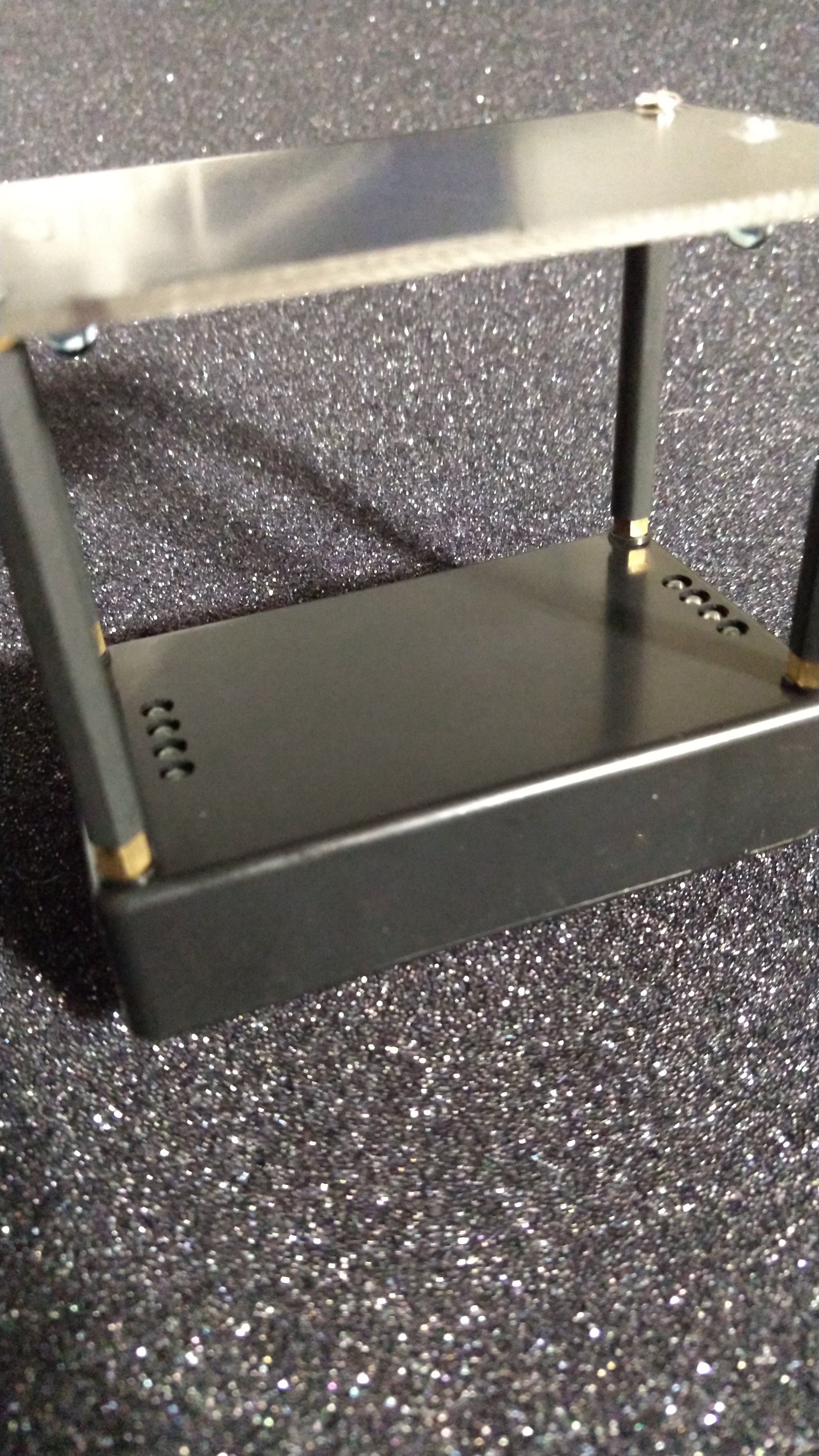

Here's a picture of the underside that shows the sensors that capture the light from the 2 bulbs on the bottom. Pretty cool how it works!

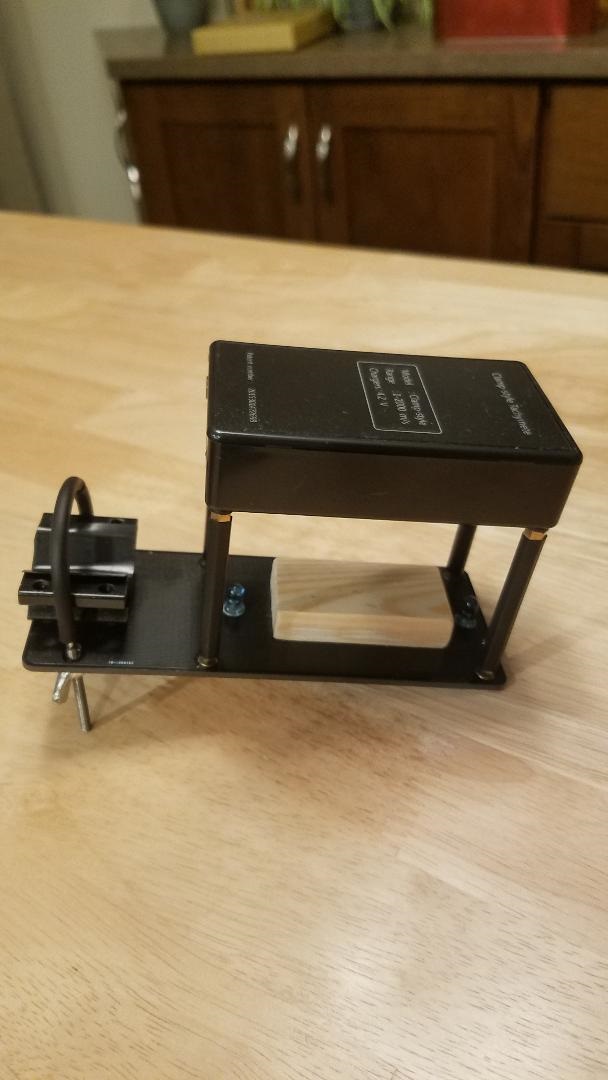

I didn't bother switching to FPS as the reviews states they reset when turned off. Working aerospace engineering I have no issues with metric, so I just left it as delivered and used the excel sheet for any conversions.
I did add some shrink tape to the U bolt and some electrical to the v-clamp for protection. I also added a piece of wood between the LED's to keep me from shooting the front one. Going to run the R7 through some paces this AM.

Yeah I got mine last June. So the 4 digit, FPS version been out a little while, and I do not do metric well. Lol So like it was stated yes it does reset every off/on so you have to swap to FPS. But real easy, just power on, wait for it to say PS then hit the button once and it says FPS.

Just finished running the Beeman R7
635 FPS (9.1 stddev which I though was large)
6.6 FPE (0.2 stddev)
CP Pointed 7.4 gr
So I did three guns this weekend. All using Crosman "inexpensive" ammo. I'll do it again in a few days with some upper-class ammo. Still learning and will play with the hammer spring a bit on the Avenger. I do enjoy being a geek...
