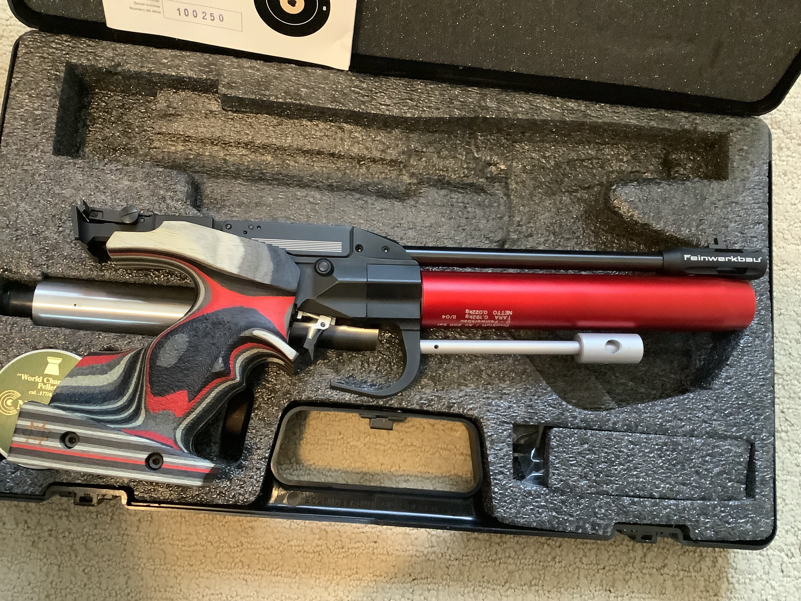

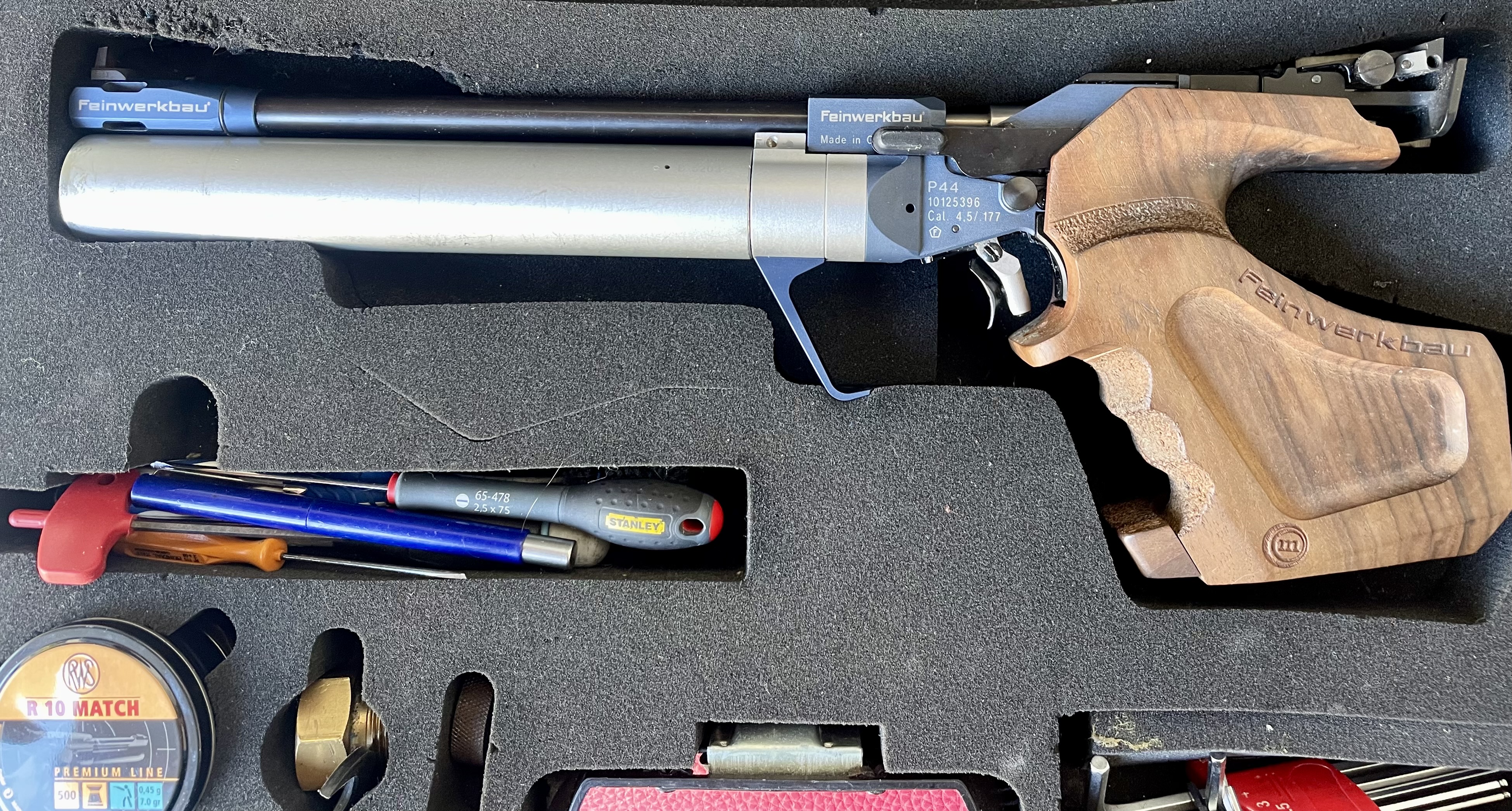

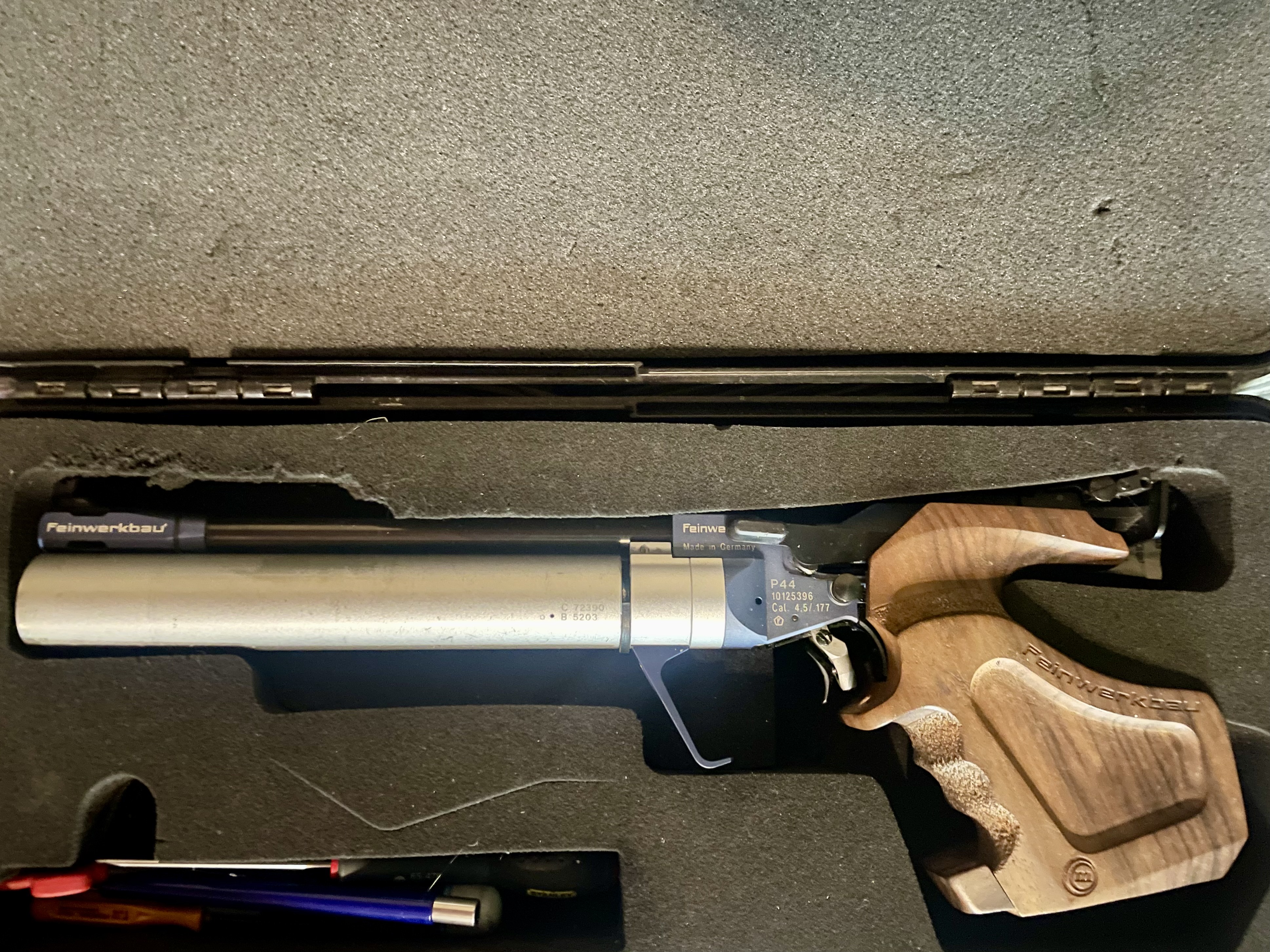

I have a Feinwerkbau P44 (christmas gift from my brother) and, for forum advice, I went to the regulating valve and a piece came out!
I spent a lot of money, but there I got all the parts of the regulating valve for a friend of mine who is a champion of the club and has an equal (and is an expert in Feinwerkbau) to assemble!
He opened it, cleaned everything, zenibre, accumulated lubricant, dirt, rust, finally all the crap and set up a seal kit and a new regulating valve and even had to make a spring that was missing!
She used to with a pellet of 7gr or 0.45 grams reached 151/152 m/s, now she is with 7.30 Joules reaching 180 m/s with the same pellet!!!
She is like she had never been and I pass today shooting and I had a lot of fun shooting with her!

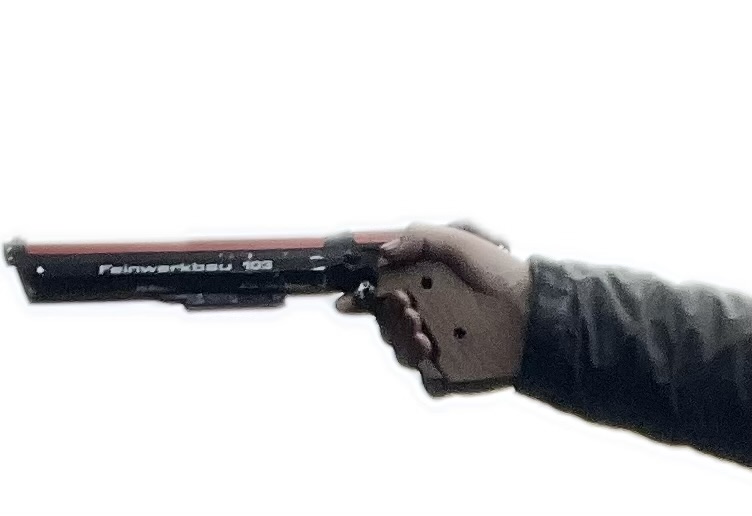

In 10 days with this pistol I went from 492 with Feinwerk 103 to 517 with Feinwerkbau P44!!!
