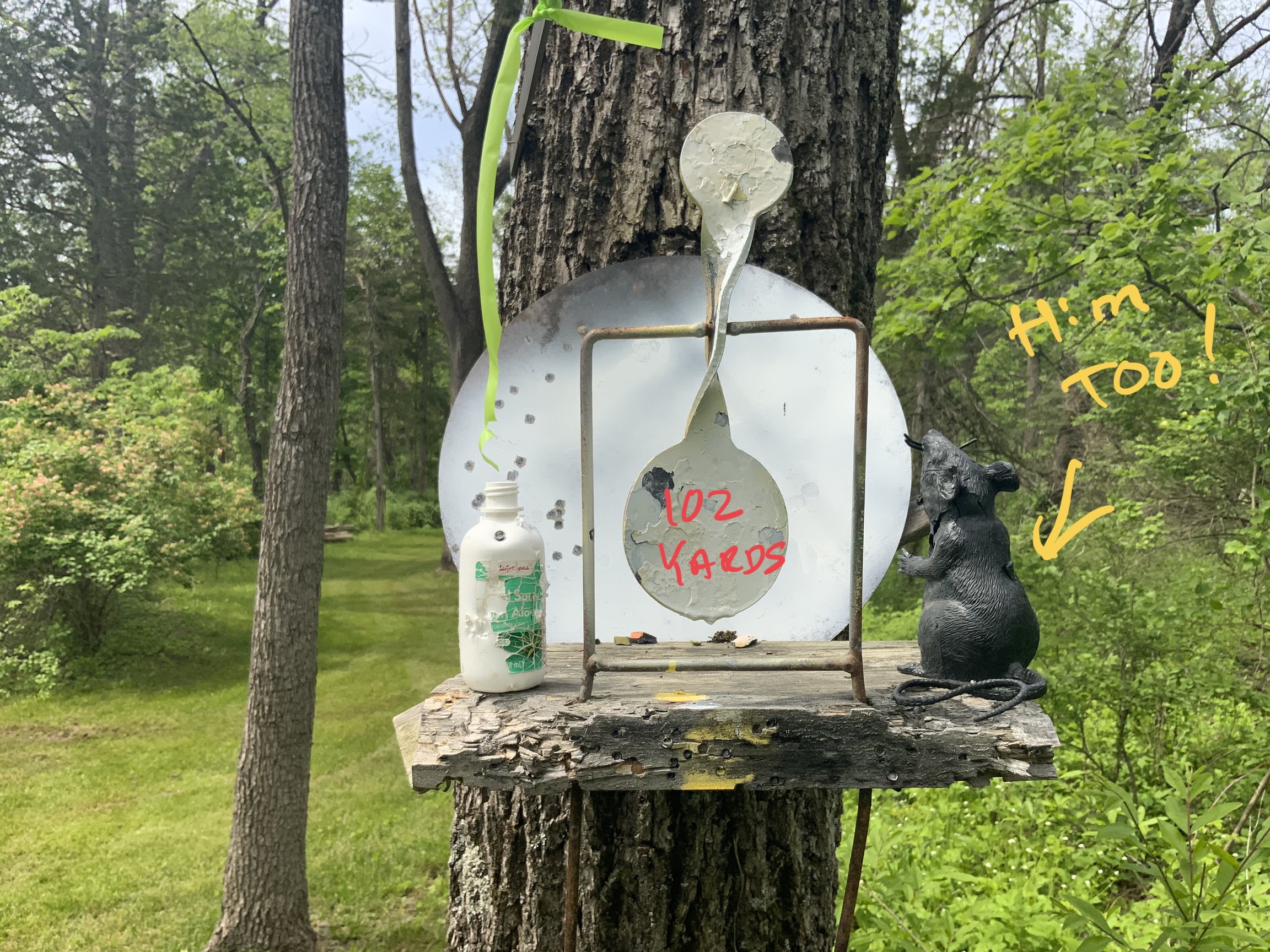

24x24 white butcher paper w/ 2 or 3" orange dot for 500 ? Hits would be easier to spot.
That is the size plate w/indicators we shot at a ELR match yesterday . 18x18 @ 450 ,& 12x12 @ 400 .
Reactions: iAMzehTOASTY1
As far as targets go - at XLR/ELR distances the seeing of where you hit or miss is super important!
Instead of using paper targets using steel targets is the way to go.
I saw a company years ago that had a steel target with laser engraved scoring rings on it which would accomplish most of what people want as far as score goes BUT you can see where you hit because of the splash mark much of the time when they are painted white.
Make the 10ring center a flapper for a bonus reaction.
Place this target/s against a background where you can see your misses and the experience will be more fun and less frustrating.
Then use these targets of different sizes depending on distance. Also it'd be a good idea to make these out of 1/4" AR 500 and hang them in a way so they make that awesome sounding CLANG we love to hear.
I was shooting at a Buffalo target at 421Y with a 60 fpe pcp using .142BC slugs and the horizontal spread was 3 feet wide due to wind. If I hadn't seen where I was hitting or missing the experience would not have been something I would waste my time with.
