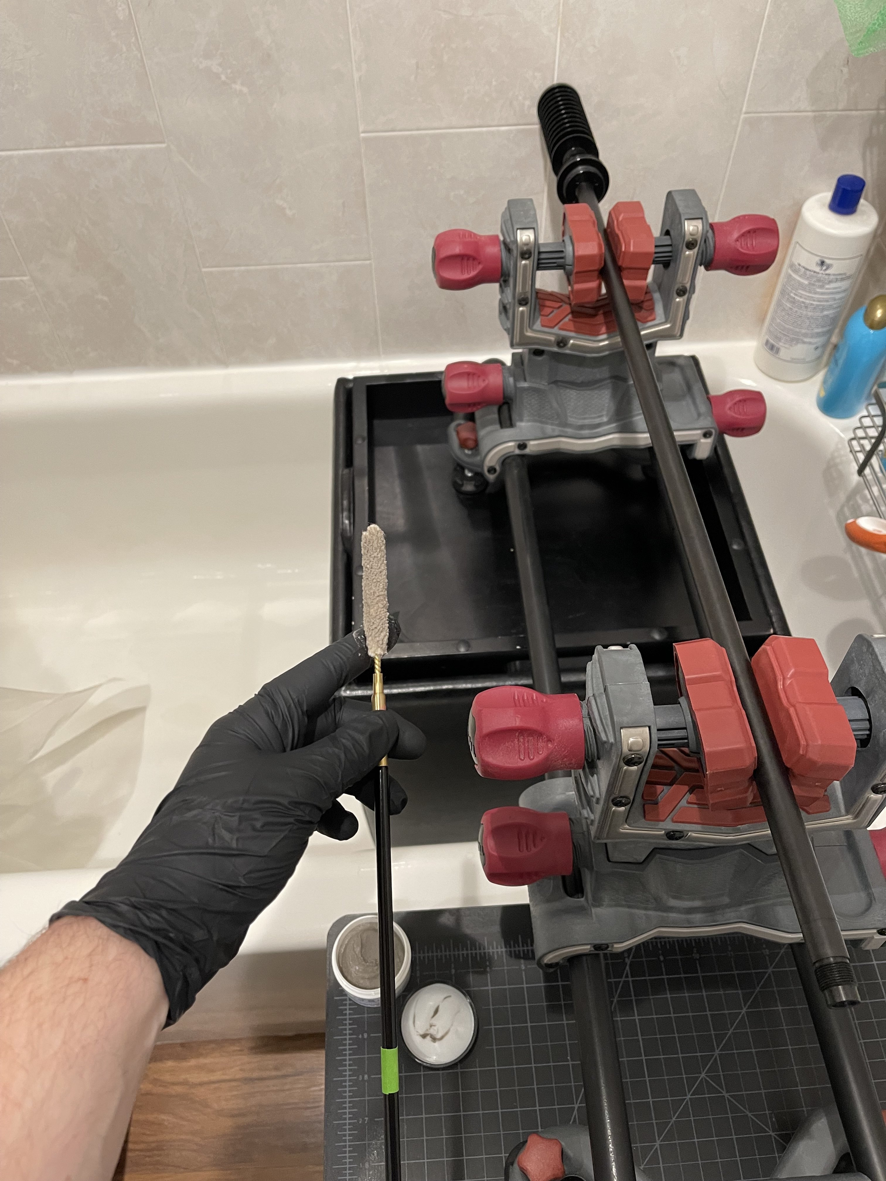

I was in a bit of a tough situation though. The moderator was attached with blue loctite and I live in a small apartment in the city with no good ventilation and nearly no workspace. I decided I’d leave it on instead of busting out a blow torch. This proved to be fine, although likely a foolish decision simply due to making things more complicated than they needed to be and overestimating the hassle/difficulty in removing it. Once it was sufficiently clean, I measured a piece of dowel so that when everything was positioned against the wall it would extend through the suppressor and slightly into the barrel to prevent the brush from accidentally exiting the barrel and damaging the crown.
I measured the total distance to the end of the dowel which came to 27”. I took some painters tape and marked 9” and 18” on the Dewey rod.

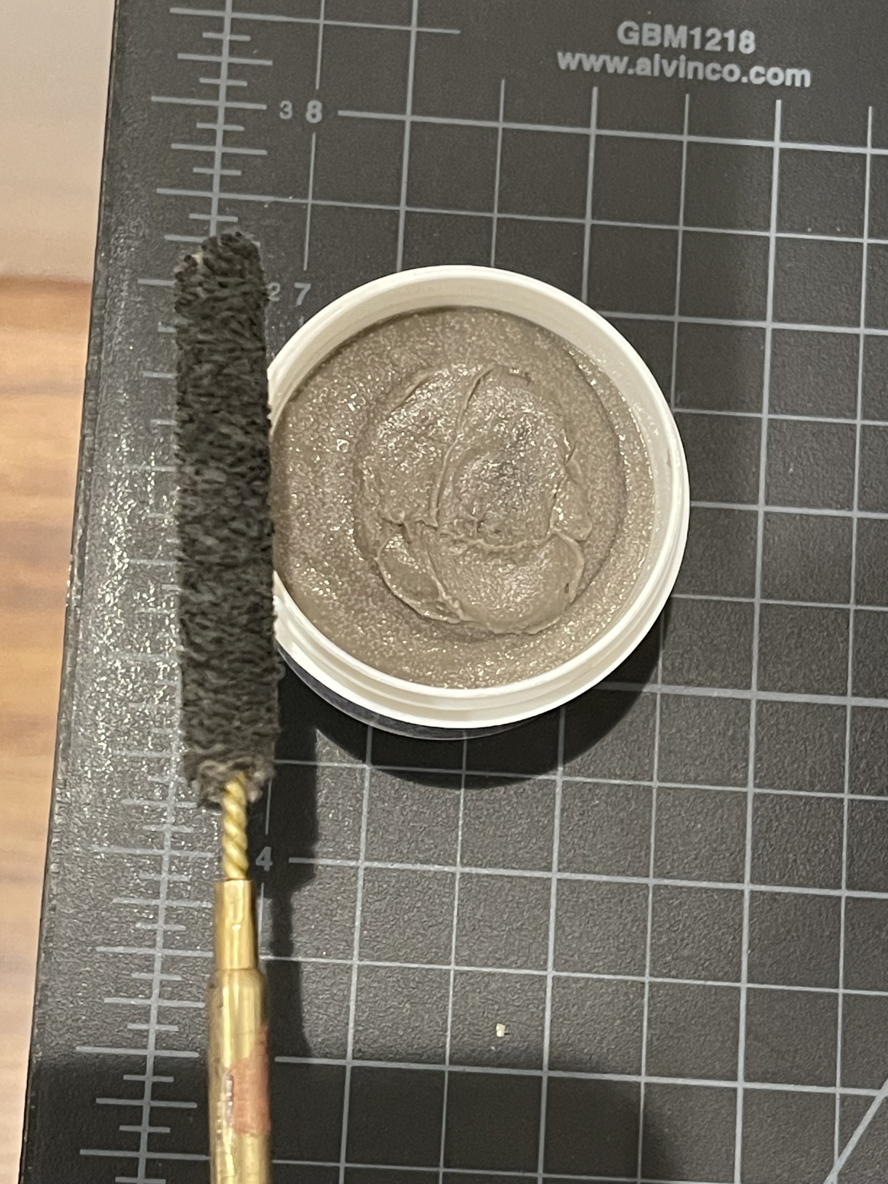

I started by applying a heavy dose of JB bore compound onto a .30 mop and proceeded to perform 33 back and forth strokes to the 9” marker watching to ensure the rod was rotating with the rifling and attempting to keep it somewhat centered. There was some resistance, but not a lot.
Almost immediately the bore mop darkened. I continued until I reached 33 strokes, at which point I applied more jb’s to the mop, removed the 9” indicator and performed another 33 strokes, this time extending to the 18” indicator. I removed the mop completely half way through, and rotated it 180 degrees before reinserting it knowing my Dewey rod had a slight bend. Upon completion, I applied more compound, removed the 18” painters tape marker on the rod and performed another 33 strokes, this time just going from breach all the way to the end where I hit the dowel.

Next up was the bore bright. This time I decided (due to it being less abrasive), I was going to do full length passes for every stroke. I set it up, same as before with the dowel blocking me from accidentally exiting the barrelI and damaging the crown. I did 60 strokes and then just like before, cleaned the barrel, alternating wet and dry.

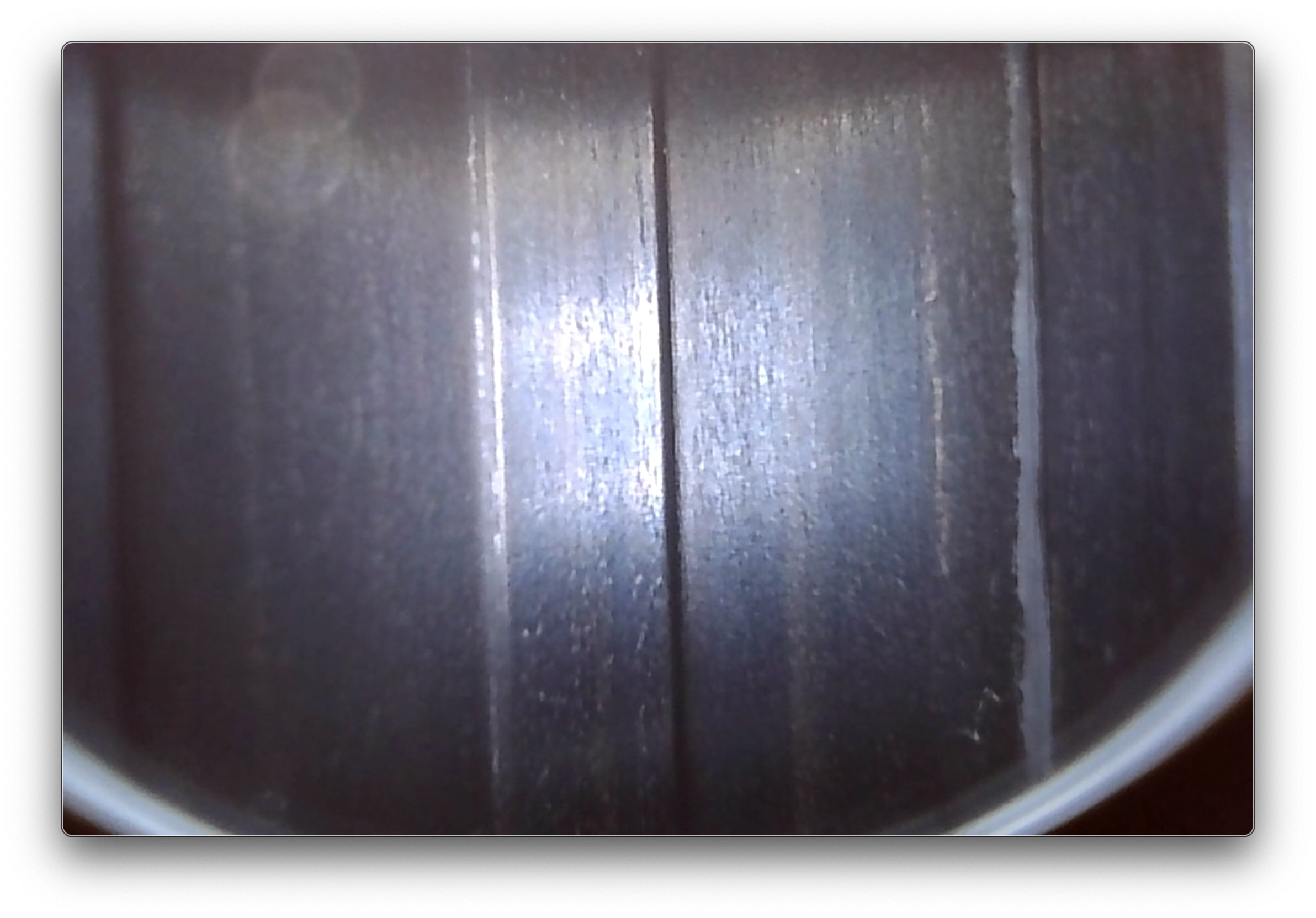

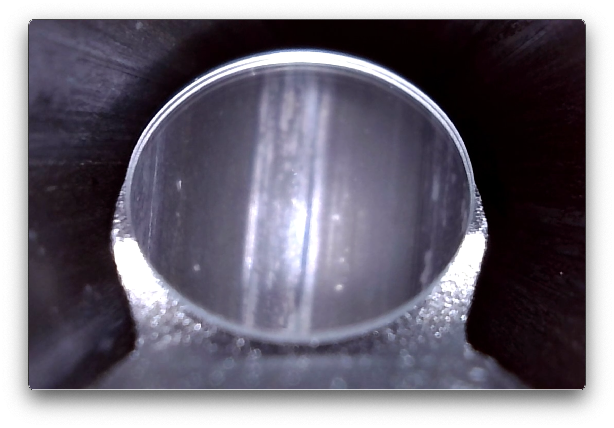

Prior to the process:
Post Process:
Borescope Rattler .357 barrel 90 deg view (low light) POST JB COMPOUND Breach 4.png
Borescope Rattler .357 barrel 90 deg view (low light) POST JB COMPOUND Breach 3.png
After an application of Frog Lube:
Borescope Rattler .357 barrel 90 deg view (low light) POST Frog Lube Solv & paste crown 1.png
