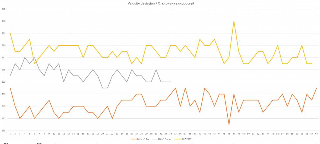

And the velocity of the projectile increased a bit and now on high velocity edge limit (300 meters per second) of accuracy for that projectile. If it goes higher, I'll start having flyers with my pellets.

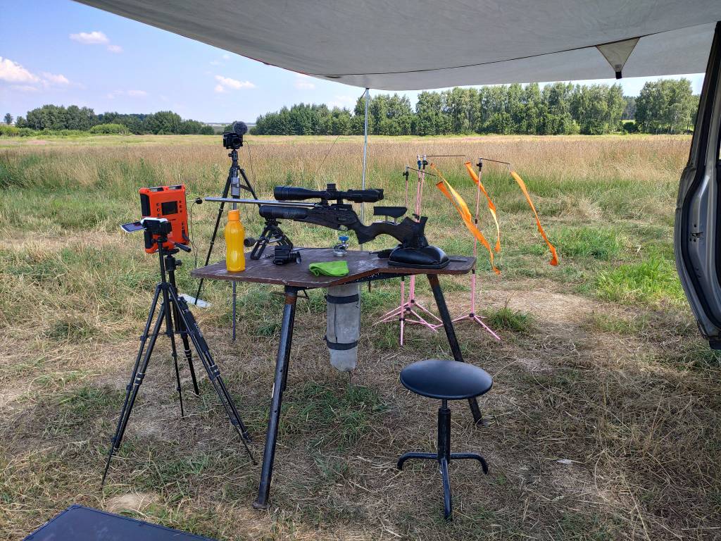

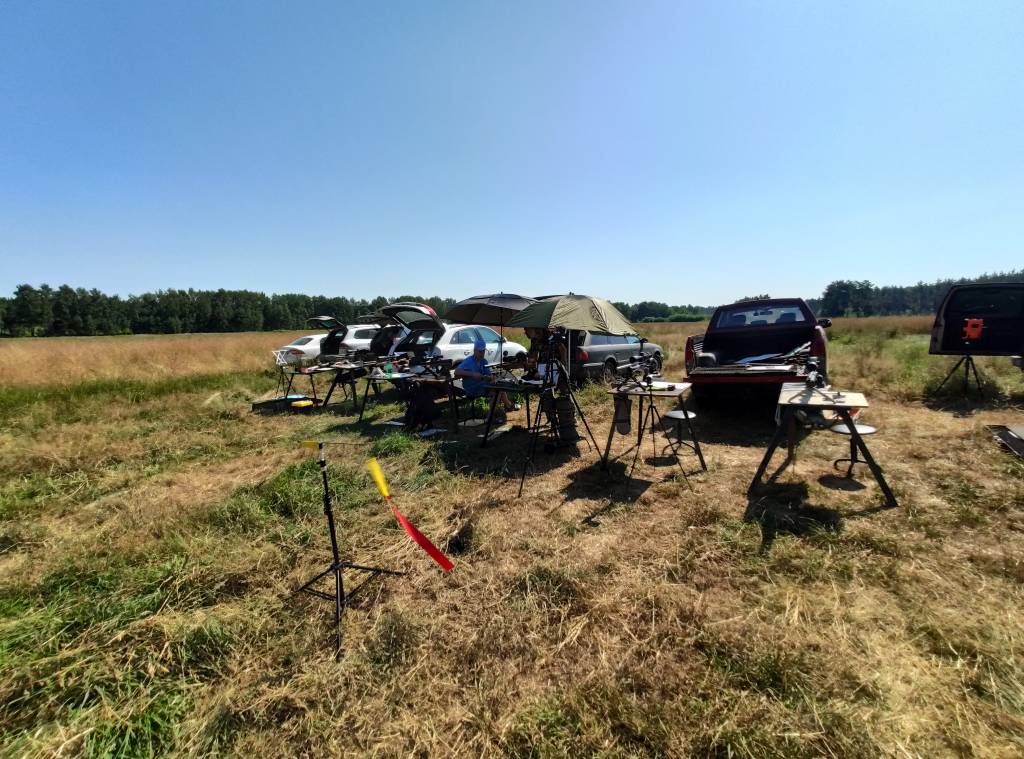

Very lucky day for me. I've taken all gold on Club Vostok benchrest competitons. We shot 3 divisions: 18gr pellets to 100 yards, all pellets (#extremebenchrest like) to 100 yards and slugs to 150 yards. If to count as Extreme benchrest rules I've got 236 and 4x scores.
All pellets divisions were shot with my Daystate Redwolf. Slugs were shot with my slug gun.
Anyway I've met what I was afraid of, as my velosity with pellets encreased a bit (see my previous messages) I've got one flyier in the second match due to high velocity and pellet gone to spyral, so it fall down to 5 score. It may be extremely critical on major event :(

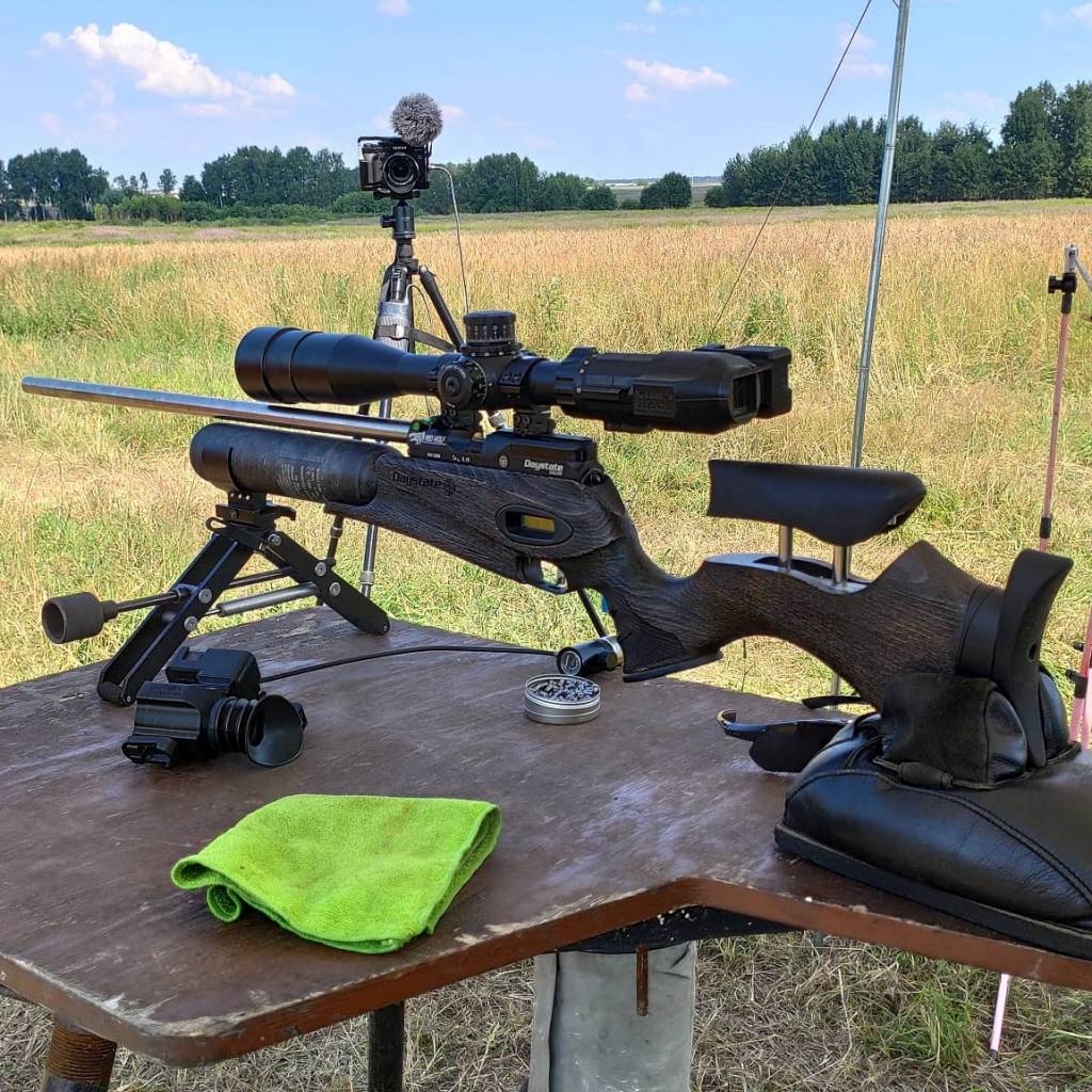

I have received an ART barrel from Daystate. Thank you!
Tried shooting it to 100 meters (110 yards) with 18, 25gr pellets and 25gr slugs. Then shot my barrel. All this on the video. As always crystal clear picture from Kahles scope with RusBear's ScopeCam.
The first thing I would like to say is that my program doesn't work on that barrel correctly. Too much differences: my barrel is 4 inches longer and has quite another system of air income – that is the reason I think. But I managed to find the pressures where the velocity is correct and stable.
https://youtu.be/gXKo1yE-3MY

For those who are interested, here is the graph of velocity deviation of my Redwolf.
Orange graph is the velocity before I increased the voltage by 10 bits (see my message here https://www.airgunnation.com/topic/my-ebr-prize-daystate-redwolf-safari-25-review-and-tests/page/5/#post-1036816)
Grey graph is the velocity after I increased the voltage by 10 bits
Yellow graph is the velocity from the video - I changed nothing here (after grey graph), it is just my gun's velocity deviation. Why is it dangerous for me, I explained in my last video.
