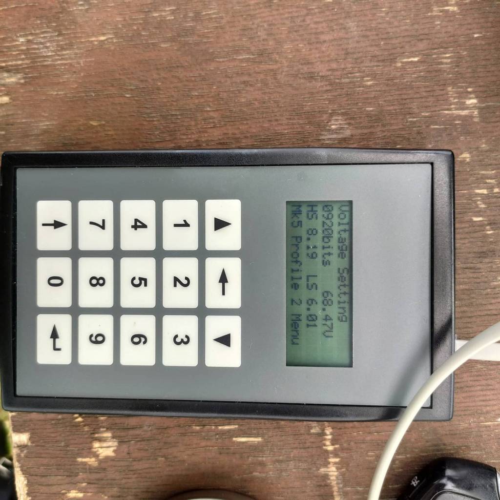

Extreme Benchrest shooting practice was very nervous for me today. Something happened to my Redwolf and it lost 15 fps of speed. It was very stable, but -15 fps. All the setups, pellets and equipment was the same as before. I tried to shoot first two matches at low edge of accurate velocity of this projectile (this very -15fps), but they were not stable at all and extremely affected by the wind. I became angry to myself and a bit crazy, because I didn't understand what and why happened :(
I had to reprogramm my Redwolf in the open field to get correct velocities and got 219 and 4x, which is not bad result as for me.
But the question exists. What if this happen right before I have to shoot RMAC or EBR? I will have to loose about 10 minutes to make all corrections (if the rules allow me to do so during the shooting). That is not good.
