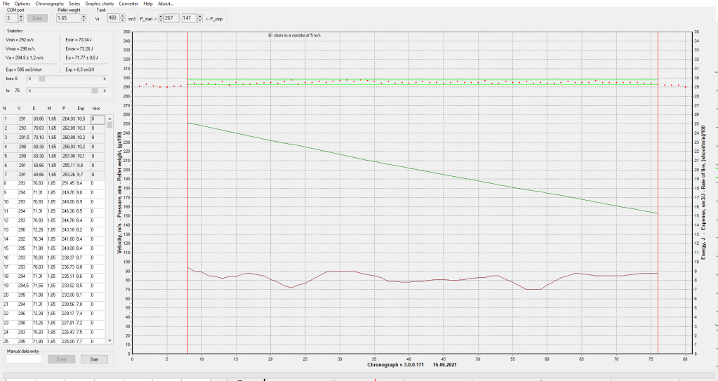

Well, I think that I've finished tuning my Daystate (at least if we speak about the quantity of shots and speed deviation). Before my last changes I had to shoot from 200 to 145 bar to get the most constant results (you may see the chart from the May 17 in this topic).
Just to remind you, my previous setup was 60 shots with the range of 963,25 fps +/- 5.9 fps from 245 to 145 bar.
Now I've got 61 constant shot with the range of 967,5 fps +/- 3,9 fps from 255 to 150 bar and it is really good as for me!

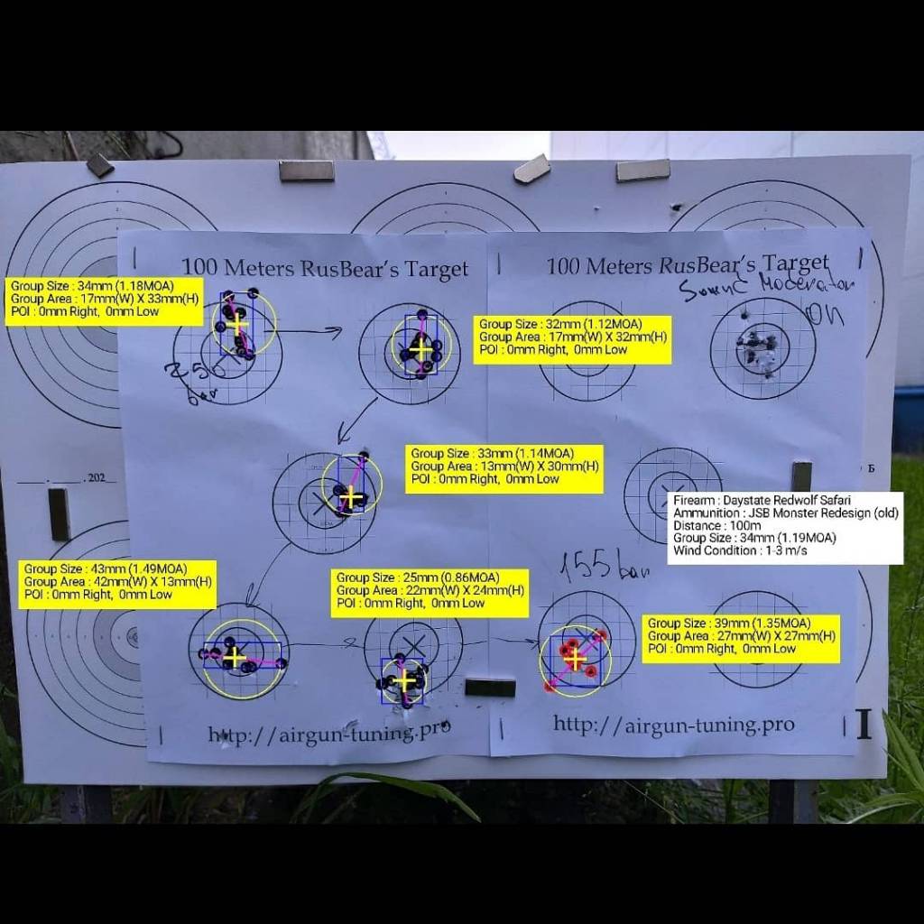

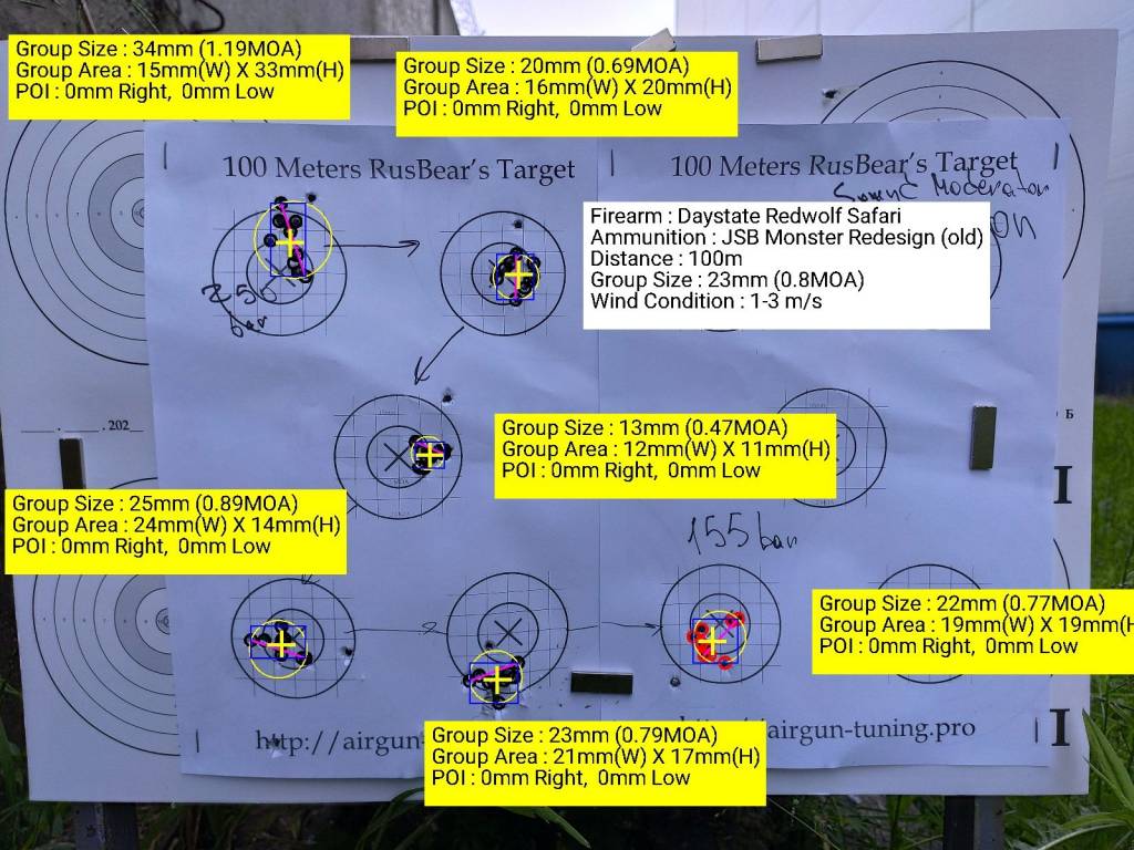

I think that the reason is that I didn't fix the barrel well enough. I've discovered it after making this shooting. It's my fault and it is fixed already.
What exactly did you “fix” to make the barrel better do that you didn’t get the occasional flyer? Thanks.
Mike
Mike, I forgot to fix the front barrel fixation screw. Shame on me! And I've discovered it after shooting. So my barrel was not fixed well enough (with the back screw only). I suppose that it is the reason, but not 100% sure yet - needs to be tested.
