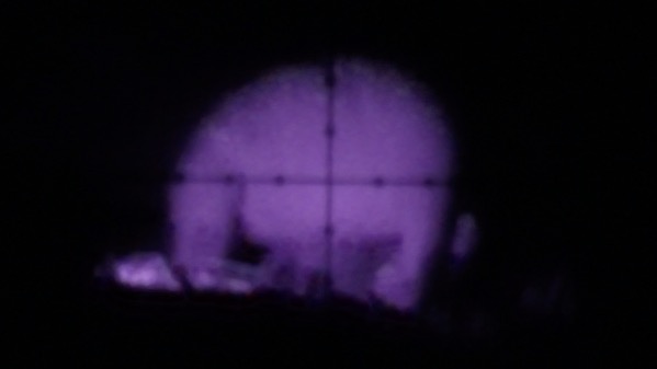

Also, after doing a test today at 25m in total darkness, I found that taking a photo with the camera produces a much better image than the video preview or taking a video. I think I need to do some proper testing with different gopro video exposure settings - as you can see from these two photos, there is quite a difference. The brighter one is a photo, and the darker one is a frame from the video. I definitely noticed that the light faded when using higher magnification on the scope - these images were with 6X zoom. I used my son's toy pig as a subject and I was aiming from my arm in the dark it was difficult to adjust the focus. I will do some more testing and keep you posted - but I feel positive that I can get this setup working well.. These images were from 25m at 6X magnification with the IR flashlight sitting on the ground 1m from the toy pig.
apparently there is a way to edit the Gopro's firmware in order to optimize for night vision by setting a higher contrast and changing to grey-scale - I am still trying to find out how to do this. Also there are some suggested camera settings that will achieve a better image: Standard SettingsLow Light Active: Will only be available above 30fps. This function slows down frame rate to increase exposure. We suggest this on.Spot: Off unless you are using a super bright light and need to expose to the center.Advance SettingsProtune: On | Color: Flat  | ISO: 6400 | Sharpness : Low | EV: Adjust for your torch
