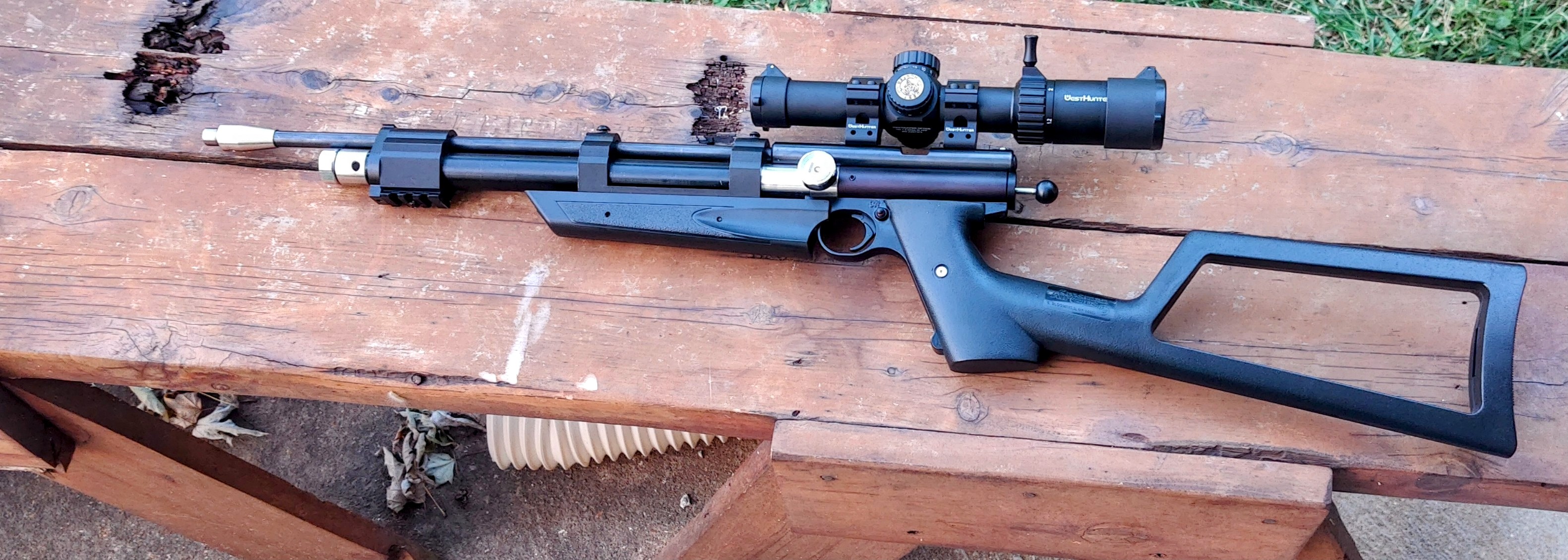

I have done the hipac, and more brute force methods, as well as pressurized tube and a chinesium kit as pictured. It's no power house but it does well and has a very high shot count for a 220cc bottle. I don't recommend the hipac or pressurized tube(unless you find a custom shop gun).
