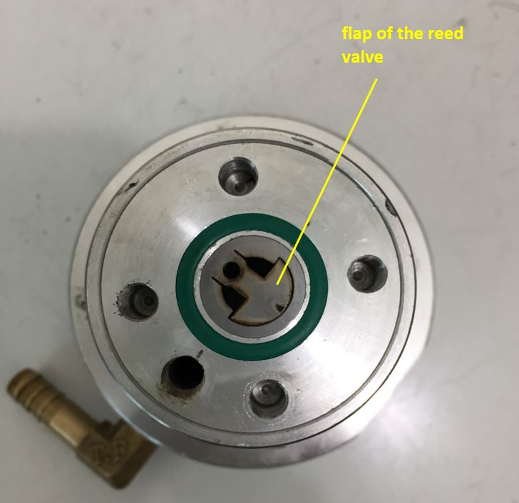

It's not just the water that does the cooling. Compressed air leaving the compressor carries away a LOT of heat as well. May be it's worthwhile to check whether the reed valve blade at the top of the 2nd-stage cylinder is installed properly. The hole on the blade should be aligned with that on the cylinder head but there is NOTHING like alignment pins to ensure that.
Compressed air leaves the cylinder through that hole. If the hole is partially blocked because the blade's orientation is off, the air flow will be obstructed so more heat will stay in the cylinder.
