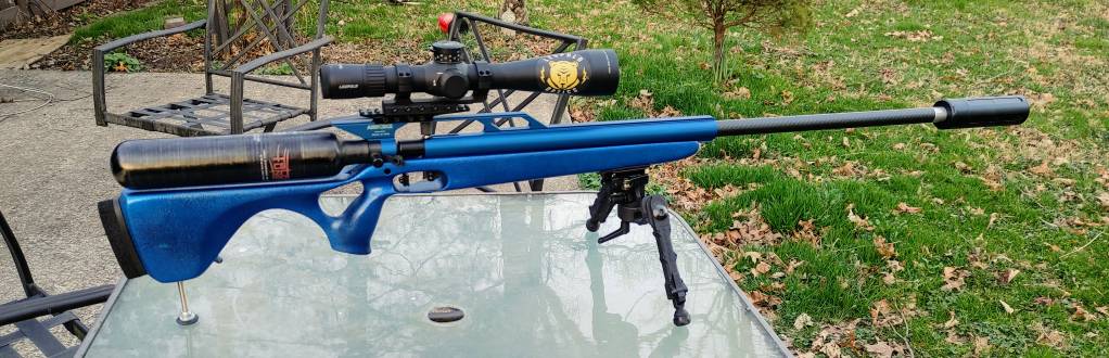

My camo painted Texan .308
I was out turkey hunting yesterday and just snapped a quick picture of my Texan. Mad Dog
stock, Hawke scope, HS silencer, and custom tank cover.
Reactions: davidsng
It was really easy. The beauty (pun intended) of it is that you can't mess it up, lol. I wanted something camo but also 'worn' looking. I ended up using digital camo stencil that I got off of amazon and Rustoleum camo paint (3 colors, along with flat black and dark brown)
Kind of fun and the finish is just what I was looking for. The paint is wearing off (it's been almost a year) where my hand goes on the fore end but whatever...it's black underneath and just adds to the 'worn' look. I didn't have the guts to spray the scope.
Not that hard just tape off the lenses. I would suggest using a scratch pad to scuff up the scope a little to allow the paint to stick better.
