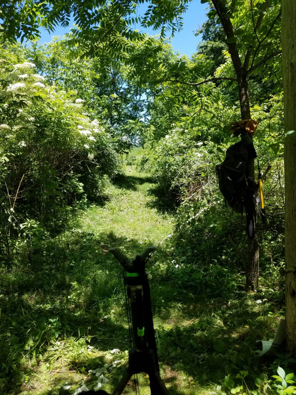

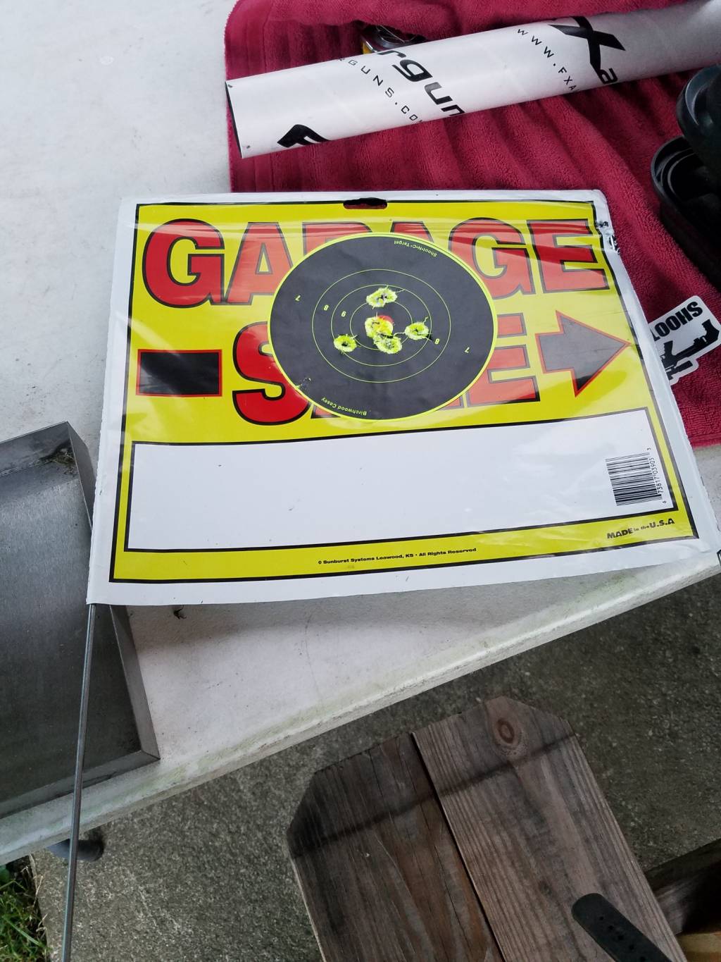

So I just received my 22 cal barrel kit which includes, 22 cal pin probe. Right now Black Betty is tuned to push out the JSB 44.75 pellets at 880FPE. 1st reg at 175, 2nd at 150. At the range, I was hitting the bullseye twice and three shots in the 10 ring and the rest was in the 9 ring at 75yds for a pellet! Now I want to convert from the 30 cal compact to the 22 cal sniper so those of you who already went this route, let me know on the new power setting reg pressure, ammo, accuracy, the works. Appreciate your input.Oh btw, here is the photos of my range again, after I spent bout an hour and half clearin the brush and the target at 75 yds. Thanks in advance.

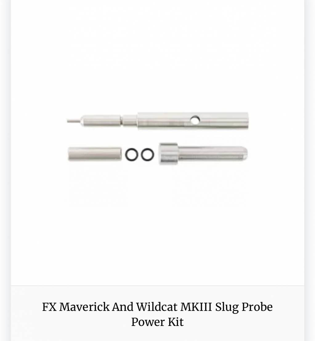

Thank you ram2jeep and rallyshark for your quick replys. I'm going to try and keep my setup simple for now with the standard STX liner in 22. Will order up some NSA .218 24.8 gr slugs and give them a try. Should I get the slug power kit for 22, what all is included with that? As I understand it, a heavy liner, pin probe, and maybe something to do with the hammer spring for the 22 cal. But bear in mind, this is a 30 cal that has been converted to a 22 cal, so wouldn't I already have the heavier hammer spring? Rallshark, what velocities are u running on your setup?
My compact .30 came with an 11-ish gram hammer weight, if I remember correctly. I have since made a heavier hammer weight myself. I use a 14 gram weight most of the time. You'll be just fine with the hammer weight that comes in the slug kit. I run a few different tunes with mine. I've done a few other things to it, so I can push the power to the limit, since mine is a hunting gun first. My upper end power numbers are more than a stock Maverick can do, but no too much more. I also have the Huma extra high pressure regs in my gun.

Nice work on the home range, in my experience when i stepped down from .30 to .22 with my maverick i left the existing hammer in place because its the same weight as the one they will send in the slug power kit (if your going that route), be sure to weigh the hammer as when i first received my maverick in .30 there was a mistake at the factory, the hammer weight was actually from the .22 model and was too light for the .30 (a problem swiftly rectified by fx under warranty)
