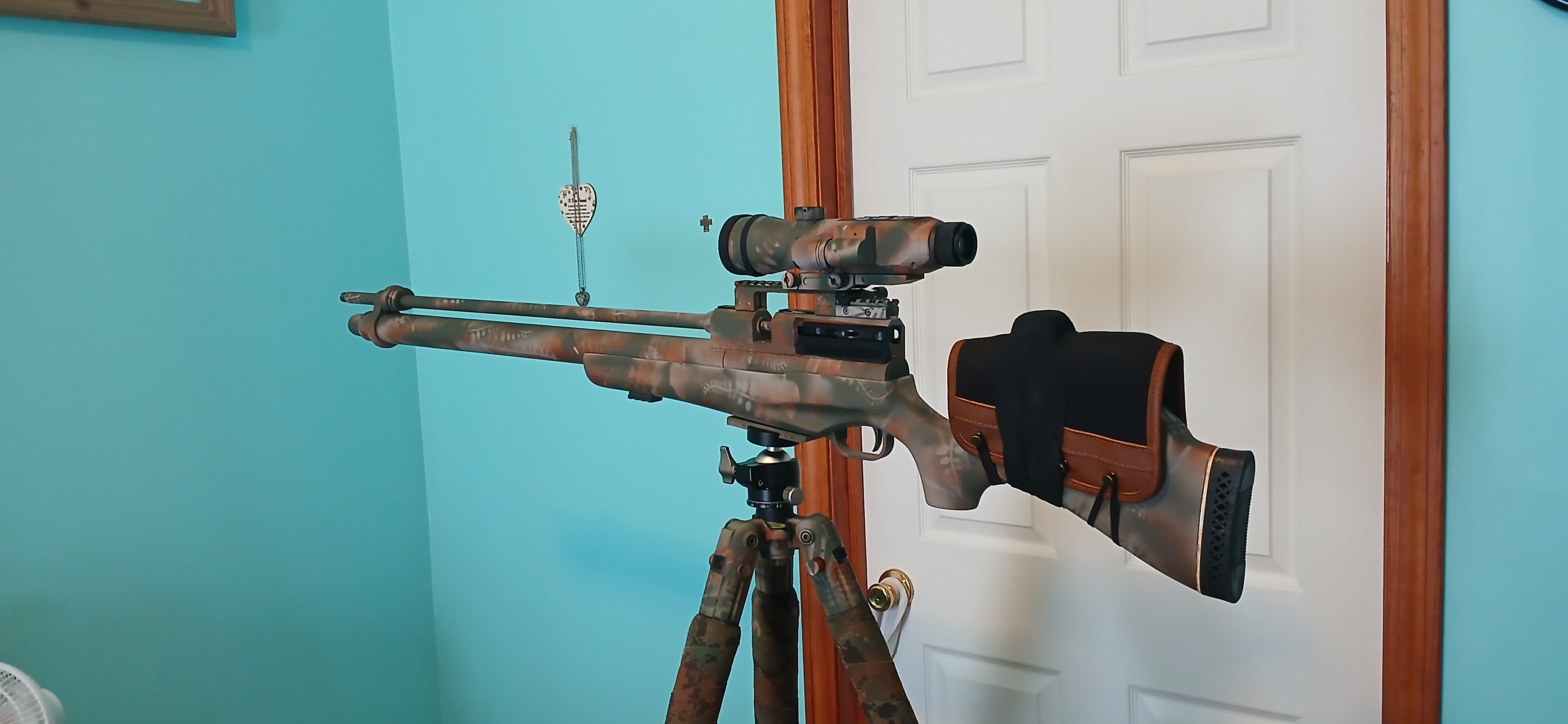

Before you totally give up, have you tried a barrel band from here, they are the only ones I use.
https://blackartsdesign.com/ solid solution, especially for your Avenge X. They offer purpose-built bands that are engineered to reduce POI shift from bumps and moderator weight, and they’ve got versions specifically for both the
tube and
bottle variants of the Avenge X.
What Makes Their Bands Effective
- TPU bushings inside the band act like soft centering guides—similar to the floating concept you have mentioned They stabilize the barrel without rigid clamping, allowing it to return to neutral after a bump.
- No grub screws—instead, the band clamps securely to the air tube or bottle using internal captive nuts and steel screws. That means less chance of asymmetric pressure or twist.
- Carbon-filled PETG construction gives it a good balance of stiffness and vibration dampening.
For Your Setup
- If you’re running the tube version of the Avenge X, they offer a $36 band that fits that profile.
- If you’ve got the bottle version, there’s a $42 model designed to clamp around the CF bottle without interfering with the barrel’s natural alignment. I have one on my AEA 357 challenger and I have never had a problem with keeping zero.
These are well-reviewed in the airgun community for exactly the kind of POI stability you’re after—especially when you want to lean the rifle against a window frame and still trust your zero.
