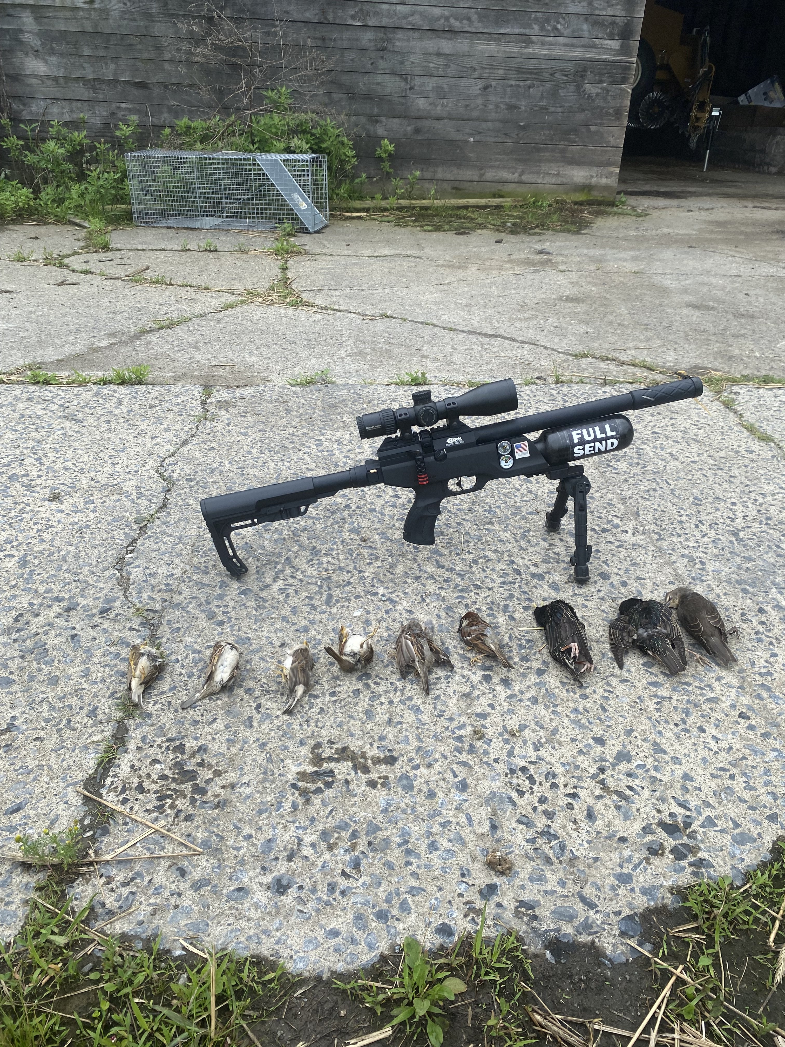

@DaleR, for what you’re describing checkout the BRK lineup. They are all field ready and can take bumps and bruises and still perform. No barrel bands or other juju necessary… Good luck… My Pathfinder is murderous on small pest birds…
those are the bastard birds!!!! Researching BRK it now!!!

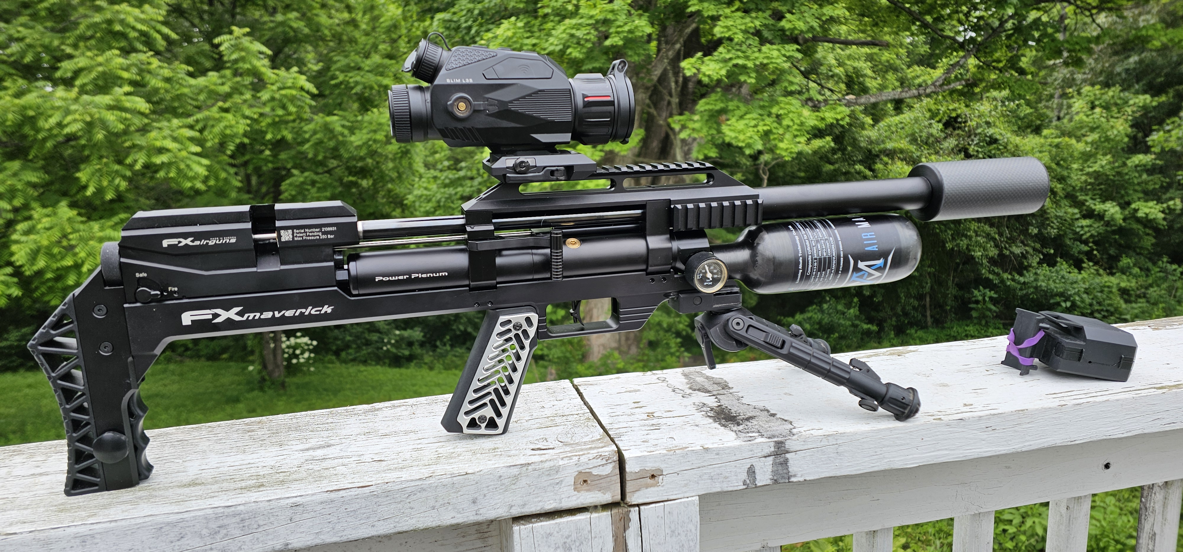

To answer your question. Yes, a used maverick or impact in compact form will be just fine, the longer barrels are a bit more finicky. I have zero issues with a 500mm maverick in .177 and a 600mm impact in .25. Dead nutz everytime i grab them. I spent much less than 1500 on both of these. This is my mav, I dont have a current pic of my impact.

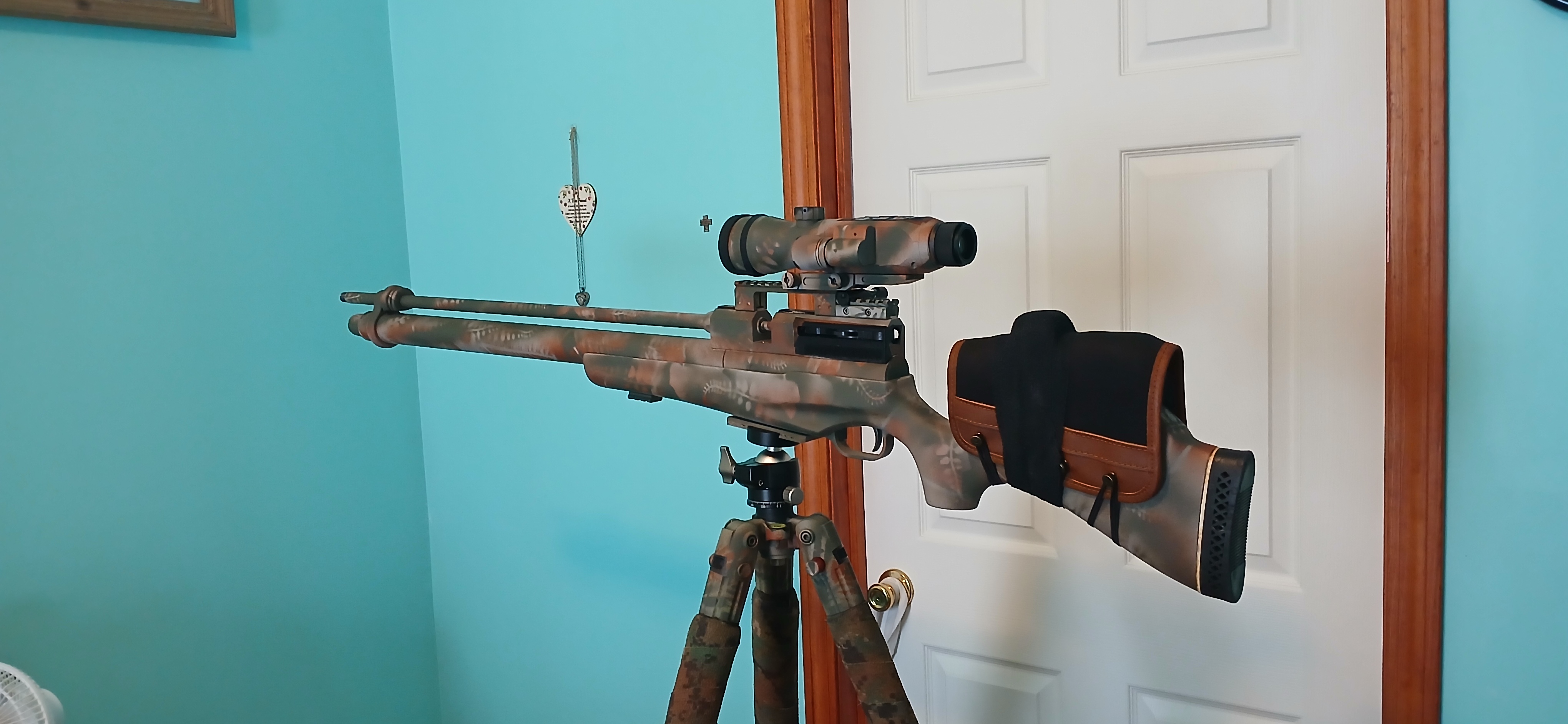

I am a bit confused. Your picture seems to be missing the shroud on the barrel???
